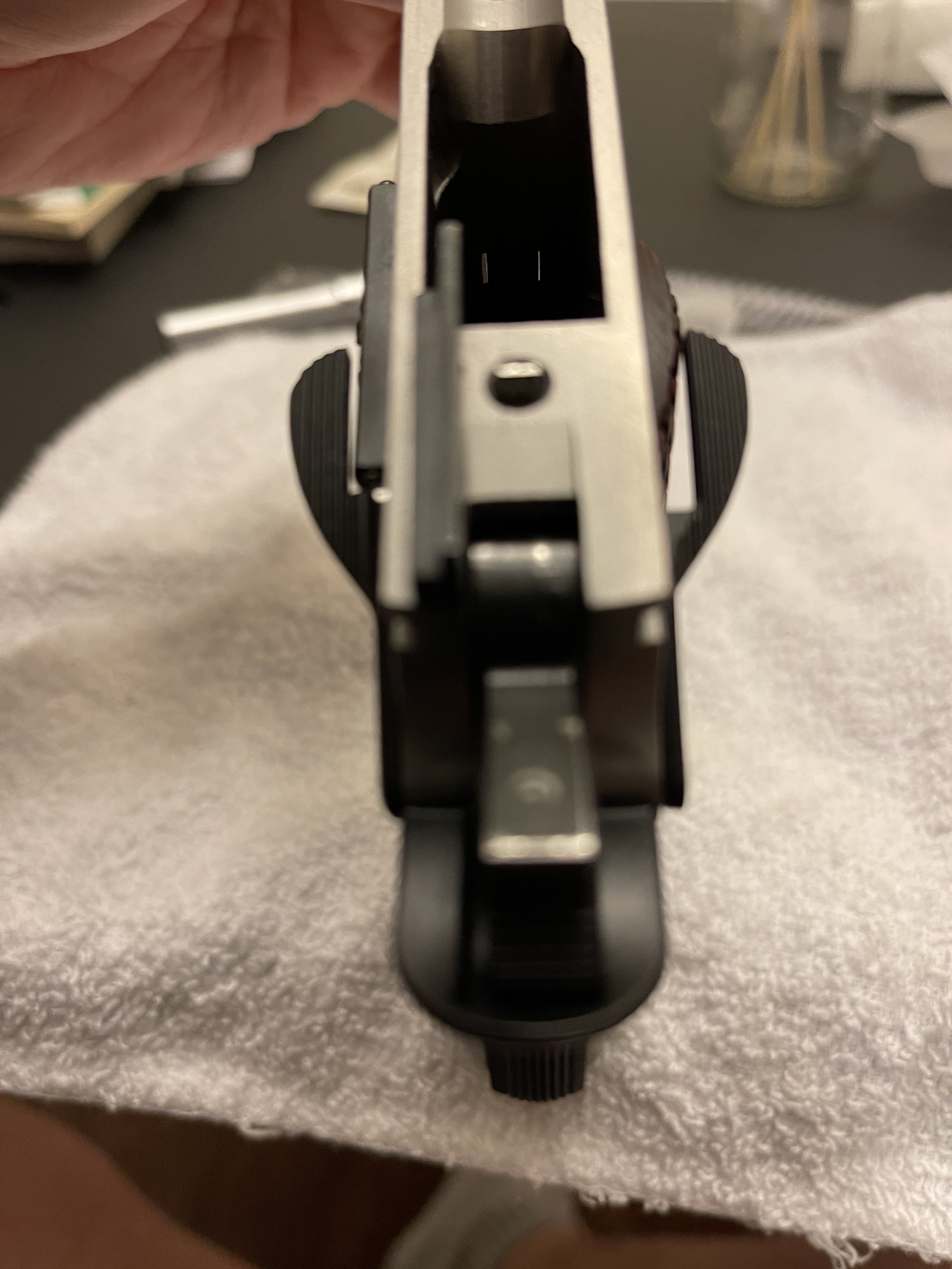

Ok. I’ve got my Tisas Carry .45 and I want to install a single side safety.
Moving the lever to the halfway point - or any other point - hasn’t allowed me to wiggle it out.
Anybody know any tricks that don’t involve MSH disassembly?

- The Tisas stock ambi’s have rather wide thumb pads. Got me a slimmer one in ss (wilson). This is the Carry model (4.25” bbl) and I think it belongs to have a slimmer profile.
- They’re black, and the frame is stainless (it’s an added finish I think- not real ss). I’d kinda like to elim that & certain other contrasts. The extractor, hammer, MSH and barrel bushing are all also black. Don’t mind some, but not ALL those. Thumb safety & extractor are the most glaring. Bbl bushing is solved with my Ed Brown “match” barrel that came with its own ss bushing ( I’ve fitted the barrel already ).
Nah, I don’t havta do it. But from the vids I’ve seen, looked like a quick low-skill thing !!

I'm trying to disassemble the ambi on my Tisas also. I just want to adjust the leaf spring to lighten the trigger. That requires removal of the grip safety and the thumb safety pins the grip safety. I need to remove the thumb safety and no luck. Have you had any luck?

Yep….. I had to put mine away due to work and other ‘stuff’ going on, but finally got it back out a couple months later. Turns out the Tisas Carry ambi was indeed the standard male side & U-shape female side as in all the other 1911 ambi’s I’ve seen (admittedly not many). They were just hammered in REALLY tight…
Keep working on it ! Try twisting one side one way while twisting the other the opposite way a bit after going heavy with the oil (to get it onto the pins as much as possible)… mine finally pulled out a little on one side - I don’t recall which - and I used something plastic to wedge underneath to keep working it out. Point is, it didn’t suddenly pop loose.
But yeah, they are standard configuration and WILL come out !
As a tip - i recommend ordering a replacement ( Fusion, Ed Brown, or just something from Brownells ) rather than putting that dang thing back in - it looks like junk to me.
