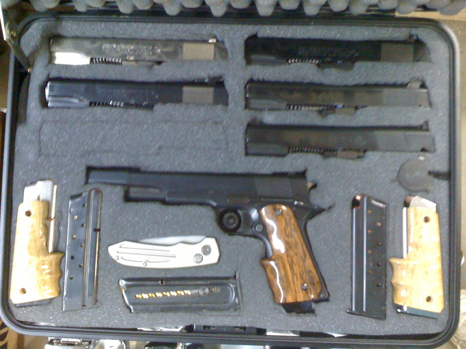

You’ve already got a great 1911 but you want to shoot a different caliber out of it. No worries, we’ve got the master list here of what you need to change out. For each caliber change you’ll need to swap out the barrel, recoil spring, magazine, and ammo. Outside of those core caliber specific parts, it depends on what you’re starting with.

As you can see, changing out your caliber isn’t such a daunting task. For most calibers, it’s a minor operation. If you really like to tinker around, there do exist universal ejectors that work with .45 and all others. Outside of that, for 9mm, .38S, 10mm, and 40S&W… you can easily create your top ends of choice and in a way, hot swap your upper. between the various calibers.
