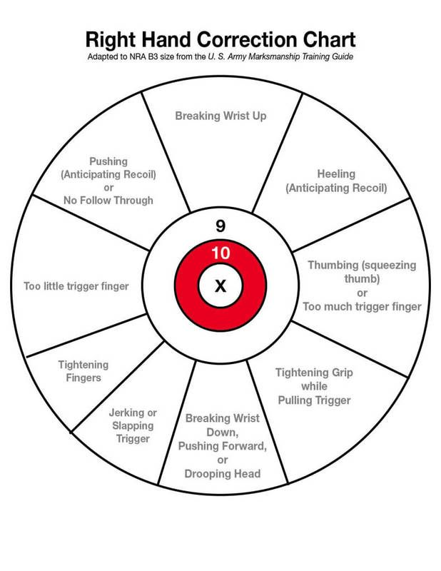

Assuming you're right handed....
I think there's something wrong with my new garrison. I keep shooting low and to the left. I replaced the grips with thicker ones but that didn't work. I shoot fine with my Kimber and Ruger 1911 so I'm wondering if I'm either shooting wrong or there is something wrong with it. I went right up to the target a foot away and it was still low and left.
Any advice would be appreciated. Thanks
Every new gun I’ve purchased and shot for the first time my groups have been low left until I get used to how the gun shoots, some of the guns it took a couple hundred rounds in the case of my newly purchased 1911 Emissary 45 it took about 15 rounds until I was on bullseye.
I feel some guns give great feedback to the shooter and some the shooter needs to try different hand positions and trigger discipline.
Not saying something could be off with the gun but look at what your doing first.
