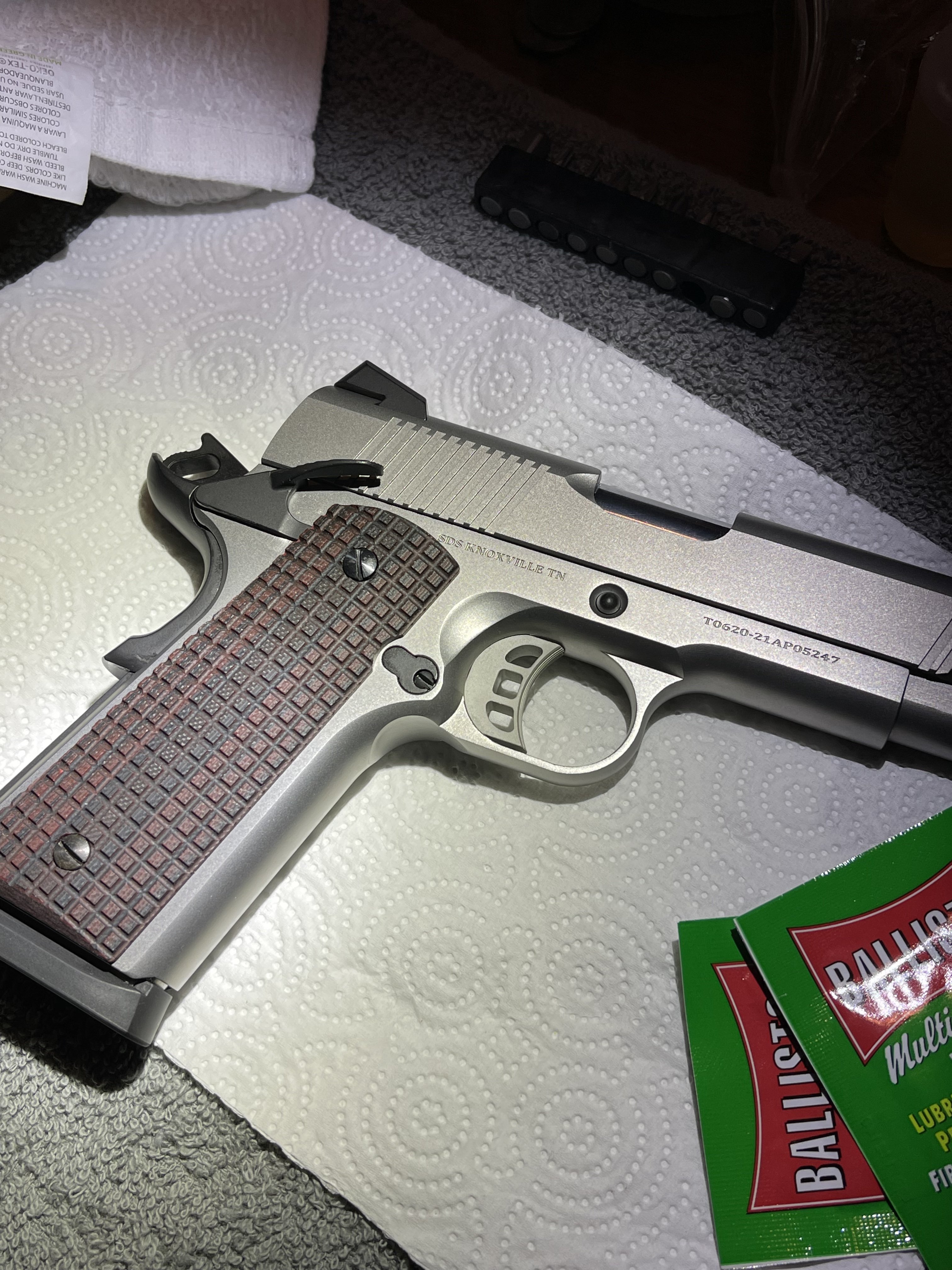

All, I’m needing to install some thin/slim grips on a full size 1911.
Any special tool needed to replace the bushings ?
Thanks in advance,
T Wave

To follow up :
Went with a pair of VZ thin “grenade” pattern grips. They are almost flat ! They grip so good I completely forget there’s no front strap checkering on the frame.
Used Swenson thin bushings and screws.
Challis tool was the fastest available I could get for removing the regular grip bushings, and it worked like a champ. Highly recommend, but I still wish i had the Brownells Magna Tip mentioned above.
Anyway the Tisas ‘fits’ me now and hoping my accuracy improves.
Do wish the VZs black cherrycolor was a bit lighter. Much more black than cherry, but you can’t beat the feel !

To follow up :
