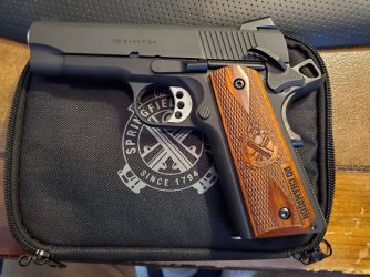

This is the information I sent to Springfield Armory on their customer support page:
"I just purchased a new Range Officer Champion from a local gun shop in Charlotte, NC. When I load the magazine with defensive ammo (Hornady Critical Defense & Cor Bon) and release the slide the round becomes jammed. I re-lock the slide and remove the magazine to clear the jam. Prior to loading the defensive rounds I used 9mm snaps to familiarize myself with the weapon and they work fine. I also loaded a magazine of FMJ after experiencing the jam and they worked fine also with no jams. The defensive rounds are just slightly shorter than the practice rounds.
Has anyone else had this issue? I have searched the web for answers to no avail and now reaching out to the experts. Beautiful handgun with classic style but this has me puzzled.
  • 9SnAZIA-BodJRR3155j9AT_A7onKqjzW8YdSZ3Hc1tc7BzBS-JDHW1RclgBS0Ox41x1EGH90BR4c-4OaxdxvGp_uiOsk_n...jpg
I only have the gun for 2 days -- Planning to visit the range this coming week
As @Annihilator said above—you need to break it down, clean it, lube it, and run at least a couple hundred rounds of FMJ through it first.
Also—the Hornady Critical Defense is, in my experience, one of the most problematic rounds when it comes to feed issues; the profile of the round, coupled with the rubber “brake pad” in the nose can make some of the most reliable pistols out there choke.
You may just have to accept that your pistol won’t feed them, and find something else.
And finally...manually feeding live rounds just to check function is not a good idea. First off, unless you’re letting the slide slam home (like you should), you’re setting yourself up for malfunction...and by doing that, you’re also chancing bullet setback after repeated chambering, as well as possibly deadening the primer.
