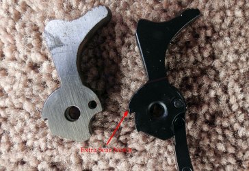

My Springfield Armory 1911A-1 has an extra, small sear notch just before the safety notch. I think it was a manufacturing defect, and I contacted Springfield Armory but received no response. I've attached a picture with an arrow indicating the additional notch. A normal hammer is pictured beside the Springfield Armory hammer for reference.
I first noticed that touching the trigger caused the hammer to fall from what I thought was the safety notch. However, I learned that to engage the actual safety notch required pulling back the hammer back a little further. I disassembled the gun and removed the hammer for inspection.
The safety notch functions to catch the hammer if it accidentally slips when thumb cocking, and I would never use it for a carry position, but I don't like the "ambiguous state" with this hammer position and plan to replace the hammer.
I'm interested in other opinions.

all i can say is, "call S/A, as they are slow to respond to emails"
and next..
Springfield designed that hammer for a reason....
if you replace it, you may be disabling some sort of safety type of reason..???
also too, if you replace that hammer, just remember that if you do/did disable any safety feature, and you have "some sort" of accident..??
you are on your own, you cannot blame S/A.....

Does the gun function ok, if so, what’s the issue? And why would you take the hammer out, it’s not needed for normal take downs and cleaning.

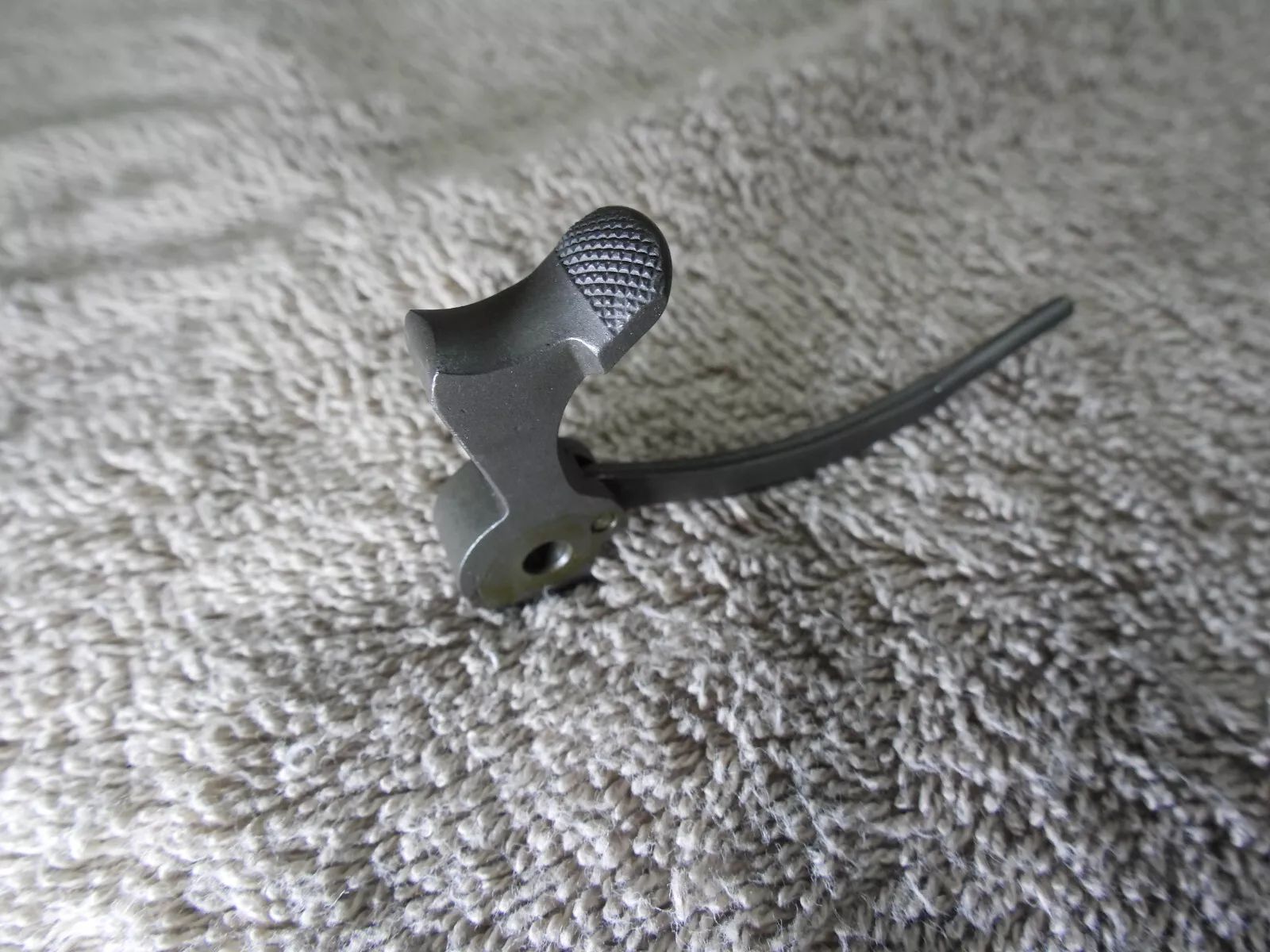

I see that others have hammers with this additional notch. My first experience with 1911 style pistols was a pair of Series 70 Colts I purchased in 1976... a 45ACP & a 38 Super Auto. Of the may I've owned, this is the first with the additional notch. My preferred hammer is a pre-1939 wide-spur, checkered. Today, good ones are no longer available at reasonable prices. The reproductions don't seem as nicely made.

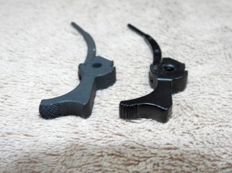

I purchased a satin nickel Tisas 1911A-1 Stakeout, which came with a 9mm barrel & magazine and a 38 Super Automatic barrel & magazine. It featured a commander style hammer and beavertail grip safety. Preferring the classic 1911A-1 appearance, I swapped the grip safety and hammer for mil-spec style.
I installed a satin nickel Armscor 4533MN-A hammer and Wilson Combat "Bullet Proof A2" sear. I liked the hammer so much that I purchased the same, but black oxide, for my Springfield Armory 1911A-1, also pairing it with the Wilson Combat sear.
I really disliked the additional sear notch on the original hammer. However, it did not affect normal functioning but served no useful purpose.
I carry "cocked & locked." but when stored, while locked in a gun safe, the hammer is lowered over an empty chamber with a full magazine inserted. I never lower the hammer over a live round, because I cannot think of a good reason for doing it.
Pictured below, the new Armscor hammer is on the left.
