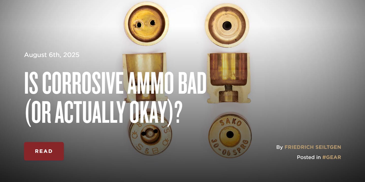

Hello all, here is today's article posted on TheArmoryLife.com. It is titled “Is Corrosive Ammo Bad (or Actually Okay)?” and can be found at https://www.thearmorylife.com/how-to-identify-corrosive-ammo/.
This article while useful actually over simplifies the issues surrounding corrosive ammo. Berdan or Boxer primers have little to do with corrosive priming compounds. There is Berdan primed military and civilian ammo that is non-corrosive and there is lots of older Boxer primed ammo that is corrosive. The spam can is also not a good indication as there is US and other military ammo packed in the cans which is non-corrosive, but also much which is not. The best bet is to clean the firearm as described anytime the issue is in doubt. I have used a lot of corrosive ammo over the years and aside from the hassle of cleaning with old GI bore cleaner or hot soapy water right away there were no problems.

A good article, however as others have said, the type of primer is no indicator of corrisiveness. If unsure, pull a bullet and fire the primed case about a foot from a piece of clean mild steel. Be sure to clean your gun as if it were corrosive. Within a few days depending on how humid it is you will see rust if it is corrosive.
