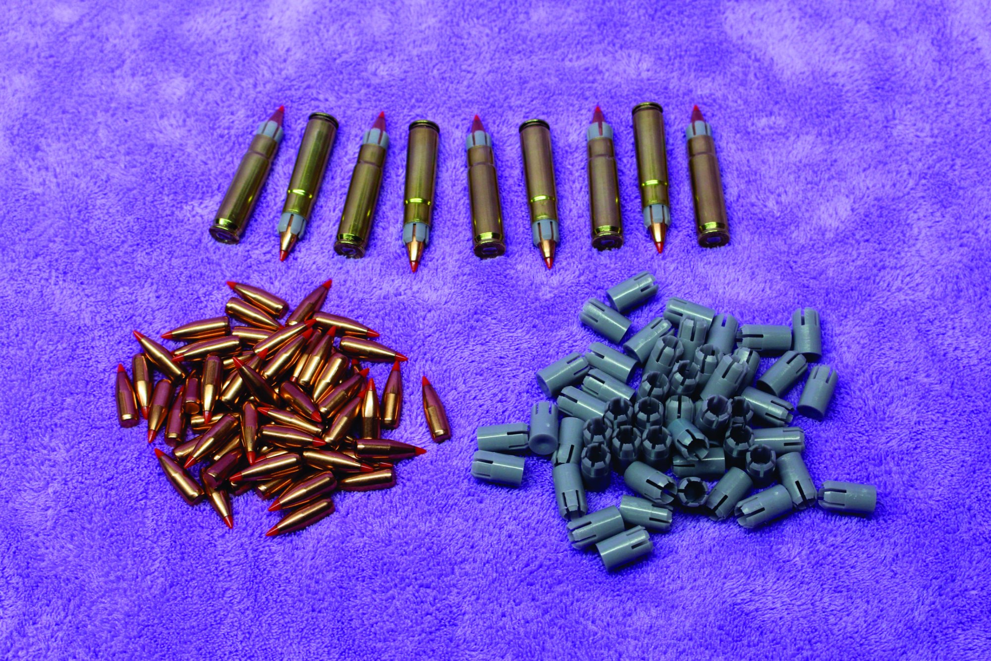

Only loaded 9 rounds of this to test it out Tuesday at the range. It's a purely educated calculation for this loading
I think it will be rather weak. May not even cycle the pistol.
Be interesting to see how they attack the target both the bullet and the sabot.
Load is 224 Hornady V-Max 50gr, Sabot is 6gr, COAL is 1.930, Enforcer 11gr
Update: Only fired the one round..... it was kind of a powder puff. So 11gr is way not enough.
Rather than shoot the other 8 I took them apart. Loaded 2 rounds each from 13 to 15gr.....
in half gr increments. I'll see how those do this coming Monday at the range.
