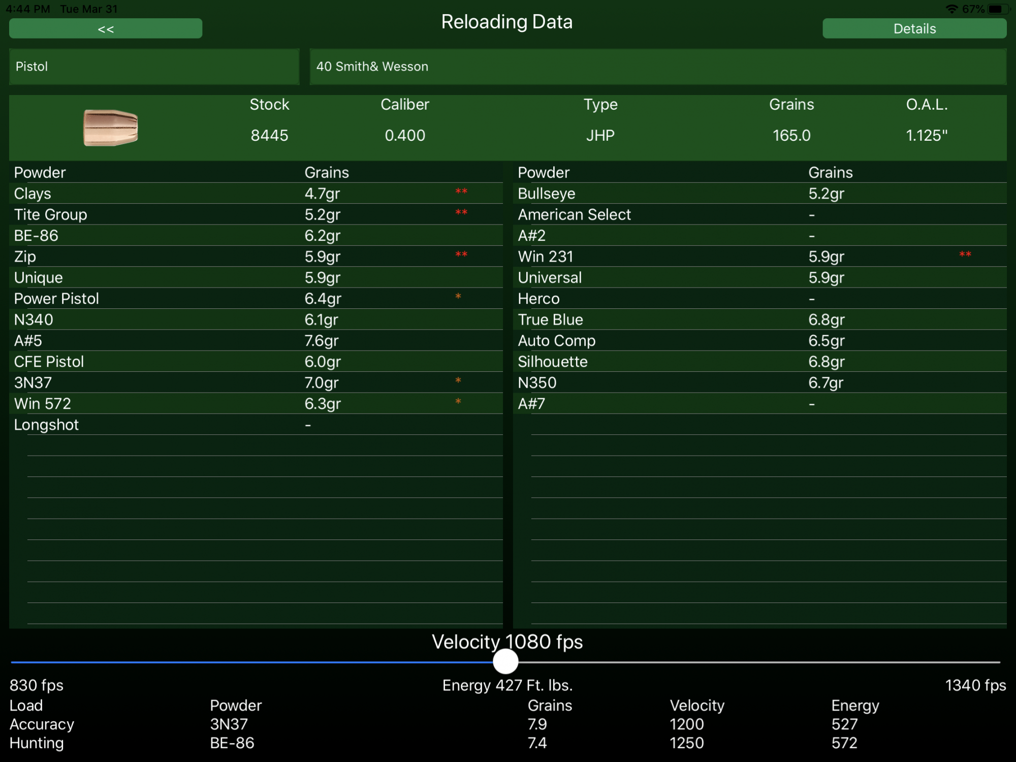

Just stumbled across this thread. I loaded 20 rounds of .40S&W yesterday using a load I found on Sierra Loading app.
R-P case, CCI 500 primer, Everglades Ammo 165gr JHP, a new bullet for me
7.0 gr VV 3N37, C.O.L. 1.125”
Intended for my Springfield EMP 40 3” and my Beretta PX4 Storm
I selected this load specifically due to the single star next to the load, and the 1080 FPS velocity.
One day I’ll get to tell you how it worked.
I hand weighed each charge which ran from 6.98gr to 7.02gr. It’s so nice to have a scale that delivers 2 decimals on grain scale.
