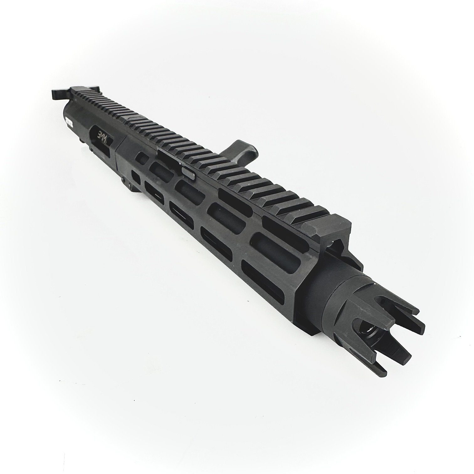

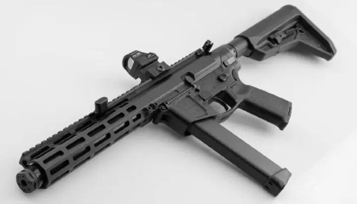

This TFB article explains how the operating system of the Foxtrot Mike's ISU-9 upper receiver does this. Everything builds on the VFM-9 upper, with an ultra-slim handguard carrying 28 full-size M-LOK slots, and standard M-LOK hardware installs without pulling the handguard or suppressor apart.The barrel has precision-drilled ports that bleed expanding gas into the suppressor while the bullet is still travelling down the bore. That does two things at once. It cuts the pressure spike that drives a blowback bolt backwards, and it robs the bullet of velocity, which is why the ISU-9 can take ordinary 115 gr or 124 gr 9mm below the sound barrier without buying dedicated subsonic ammunition.
The bled gas then runs through an internal labyrinth, expands into a chamber surrounding the barrel, passes through a baffle stack and exhausts forward through ports in the flash-suppressor end cap.
Rather than fighting the back pressure a suppressor creates, the design uses it to help drive the action, which means less bolt and buffer mass is needed and the recoil impulse softens accordingly.

The ports are drilled to intersect the lands of the rifling rather than the grooves, which is the difficult way to do it and the reason Foxtrot Mike claims accuracy survives the porting intact.
Integrally suppressed uppers normally sit well into four figures, but the ISU-9 has an MSRP of $499.
