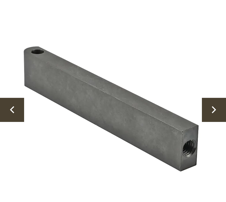

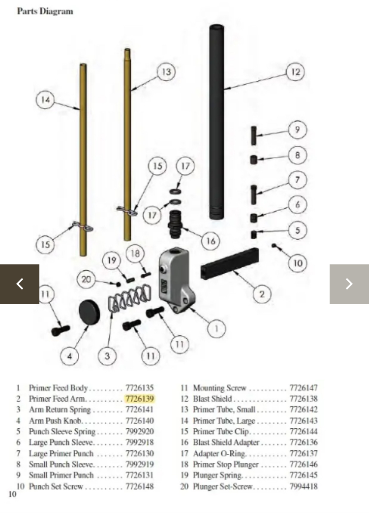

What can be done with the primer body and arm ? Due to arm having too much clearance in the body the primer cup is not aligned with body port to pick up a new primer. Nice press, bad primer system.
Is there different arms for small and large primers or are you talking about something different? Pics would help
One primer arm different primer cups.

Bought a discount body and arm from Lyman a few minutes ago.... the customer rep said it shouldn't be that loose not to pick up a primers.... I asked them to check it on a press to make sure, but I have a feeling I'm gonna get what I already have ! LOL But if I do, I'll have a spare feeder body and still have an arm made for the future.
