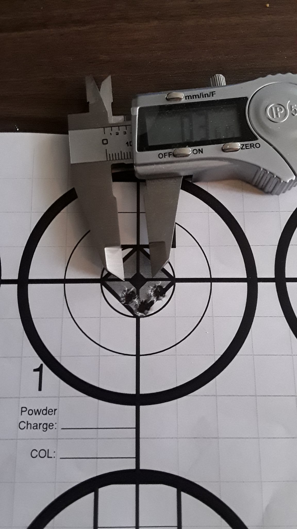

26.8 grains of cfe223 pushing a 69 grain RMR bullet in my Ruger American Scout (5.56) seems to be the ticket at 100 yards.
Using cfe do you have to fire a few rounds to foul the barrel to get good groups? I never strip the copper fouling out of any of my firearms. Hogdon is my go to powder but I’ve never seen any benefit to use cfe. Not trying to knock your recipe but I’m old and shot a round or two. Excellent group.
