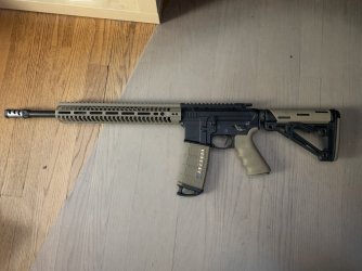

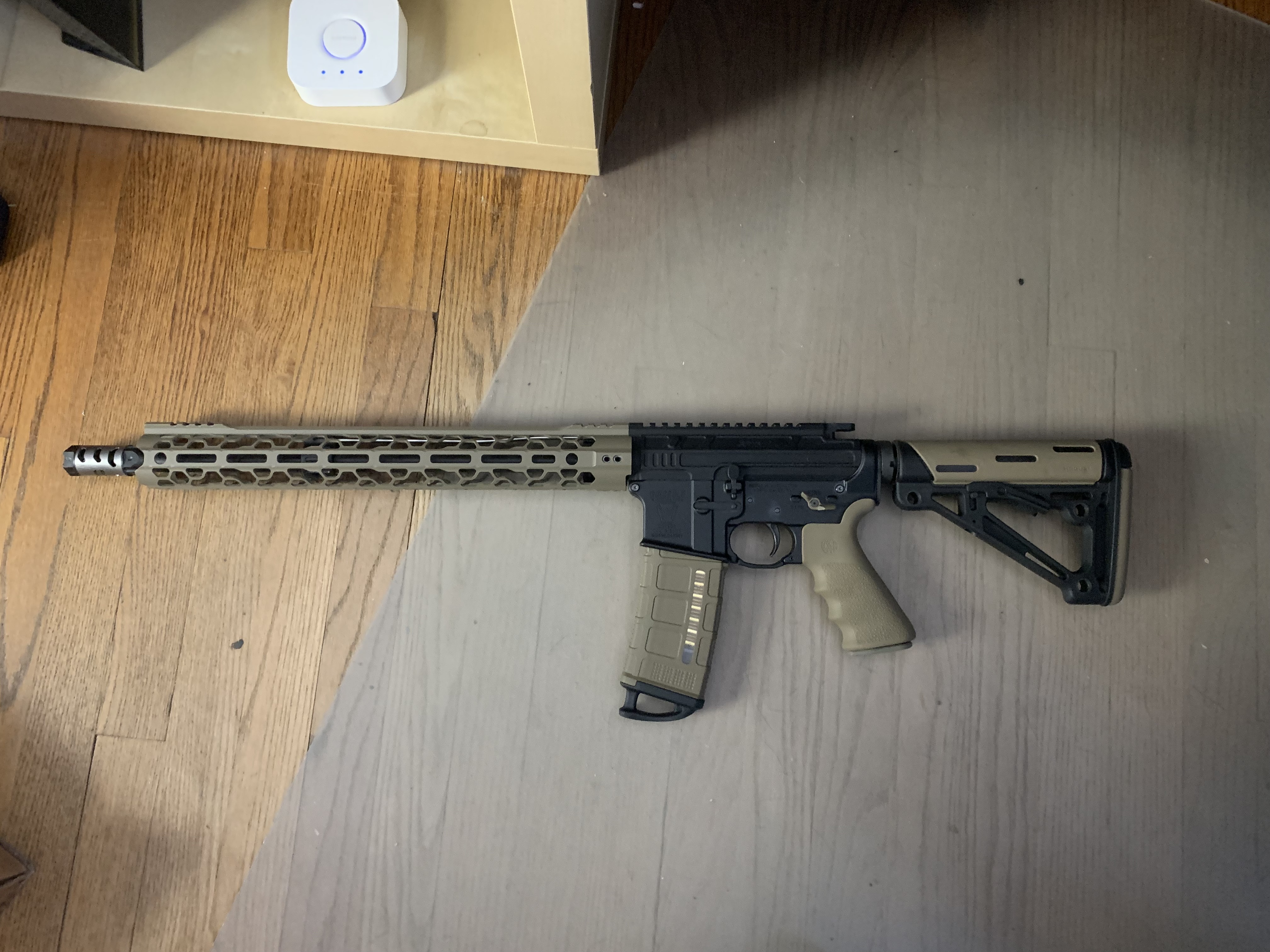

I am 90% complete with my first AR15 build. My barrel is a 16.1" Odin Works Wylde and I am gathering opinions about what length of forend I want to finish it with. I don't plan on putting money into high-end optics or magnifiers or night-optics and whatnot, so picatinny rail options are not important . I'll start with flip sights and maybe put a ROMEO5 or similar on it in the future. I want this to be an un-intimidating rifle to introduce others to the platform, that runs reliably and cleanly.
I am looking at either the Odin Works O2 Lite or their M-LOK forend. The style of forend will be determined by the length. I am torn between a 15.5" and a 12.5". With the ATLAS compensator and a tunable gas block, the 15.5" exposes no barrel and the 12.5" exposes 3". My questions for the forum are:
  1. Is there a point where too much exposure is bad?
  2. What are your experiences?
  3. Any other feedback I'm missing? 😁
  4. What is your overall opinion?
I like the 12.5" because its profile is closer to that of a A4, but the 15.5" offers more options for grip.
The majority of the build lower is Geissele and the upper Odin Works. The mag release and safety are FDE as well. Deciding on a BCG. The FDE is to indicate where you should have contact with the firearm...so to speak. I wanted the scheme of black and FDE to fit some sort of pattern. Everything is properly lubed, staked, greased, torqued, etc. Looking forward to giving it a spin in the new year!

The few things that come to mind for a shorter handguard and more exposed barrel is less reach when holding the rifle, potential to get burned by the barrel, and you'll need to be aware of resting your barrel directly on bags or whatever else as your POI could shift.
With the small amount of lost handguard you are looking at you most likely won't need to worry too much about my statement above.
The shorter one looks better to me, and plenty enough room to put a grip and light looks like. It's just a matter of preference to the individual. I have short and long hand guards and there is no difference performance wise. You have a nice looking rifle no matter which one you choose.
