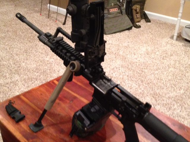

So I put together a couple AR-RPKs and added my Ares Beltfed AR
Ares (now Fightlight) AR upper clips onto a lower (does require a proprietary (smaller bolt release to avoid snagging on the linked ammo) The upper has quick change barrels to prevent overheating.
Loose belts can be used. To use a "tupperware" belt holder or cloth "nutsack", Ares supplies an adapter that clips in place in the magazine well. It does however make the ammo hang low. Since these pics Ive added a lower with out a magwel that raises the "nutsack" to M249 height.

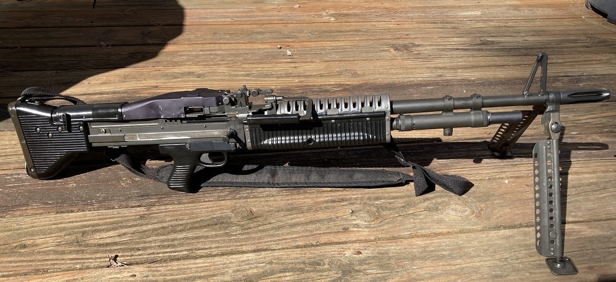

Ive had a few BeltFeds including a 1919 and a MG34. The ARES is less "historical" but more practical. YES they are pricey. They have unique parts that arent easily available and arent available with rapid fire triggers. Although it was cool having the MG34 mounted on this
