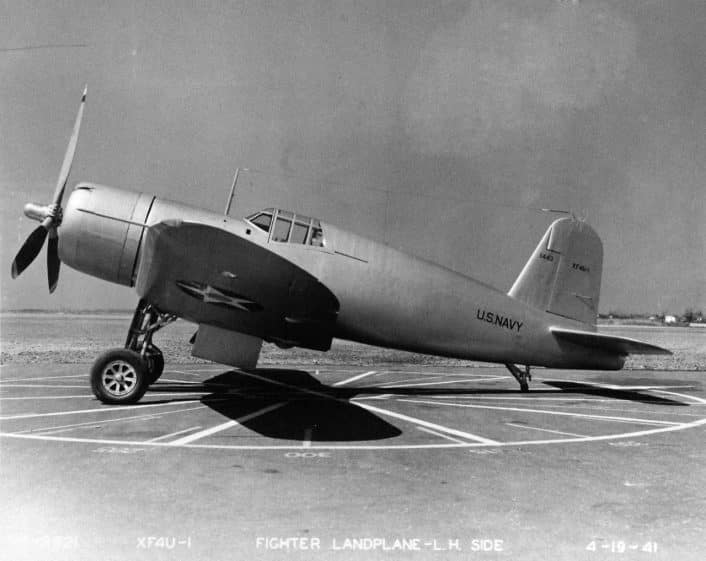

The XF4U-1​
On Feb. 8, 1939, a full scale mock-up was completed of the V-166B, and Vought was authorized by the Navy to build a single prototype that would be known as the XF4U-1.
The XF4U-1 would be shorter in length than the later production Corsairs at 31 ft 11 in in length. Wingspan was 41 ft, and the empty weight was 7,505 lb with a max takeoff weight of 10,074 lb.
Vought’s V-166B featured stub wings that left the fuselage dropping down at an angle with the outer wing panels canting back upwards, giving the aircraft the distinctive inverted gull wing appearance. This allowed the clearance issue for the propeller to be solved by placing the main landing gear at the lowest point in the Vee formed by each wing, allowing a short and rugged landing gear leg.

Side view of the XF4U-1. (Image Credit: Vought)
