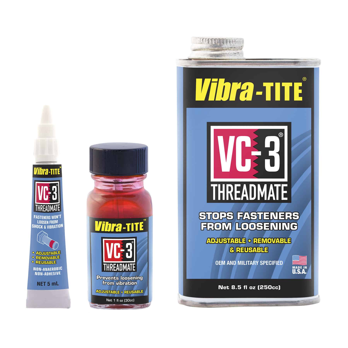

I use Vibratite.
I like that it is reusable. I find that appealing on optic and grip screws as they are most likely never permanent. You can pull your optic or grips and reinstall without cleaning and redressing the screws. Sure loctite worked for years but technology has rendered it to the back shelf IMO.
The only drawback to Vibratite is it will incur the haz-mat fee and can only go ground.
I use Vibratite.
Unfortunately, the heat rating is only 165°F; your barrel gets much hotter than that when firing.
Interesting stuff, though—I can definitely see it being useful for optics, grip screws…cool.
