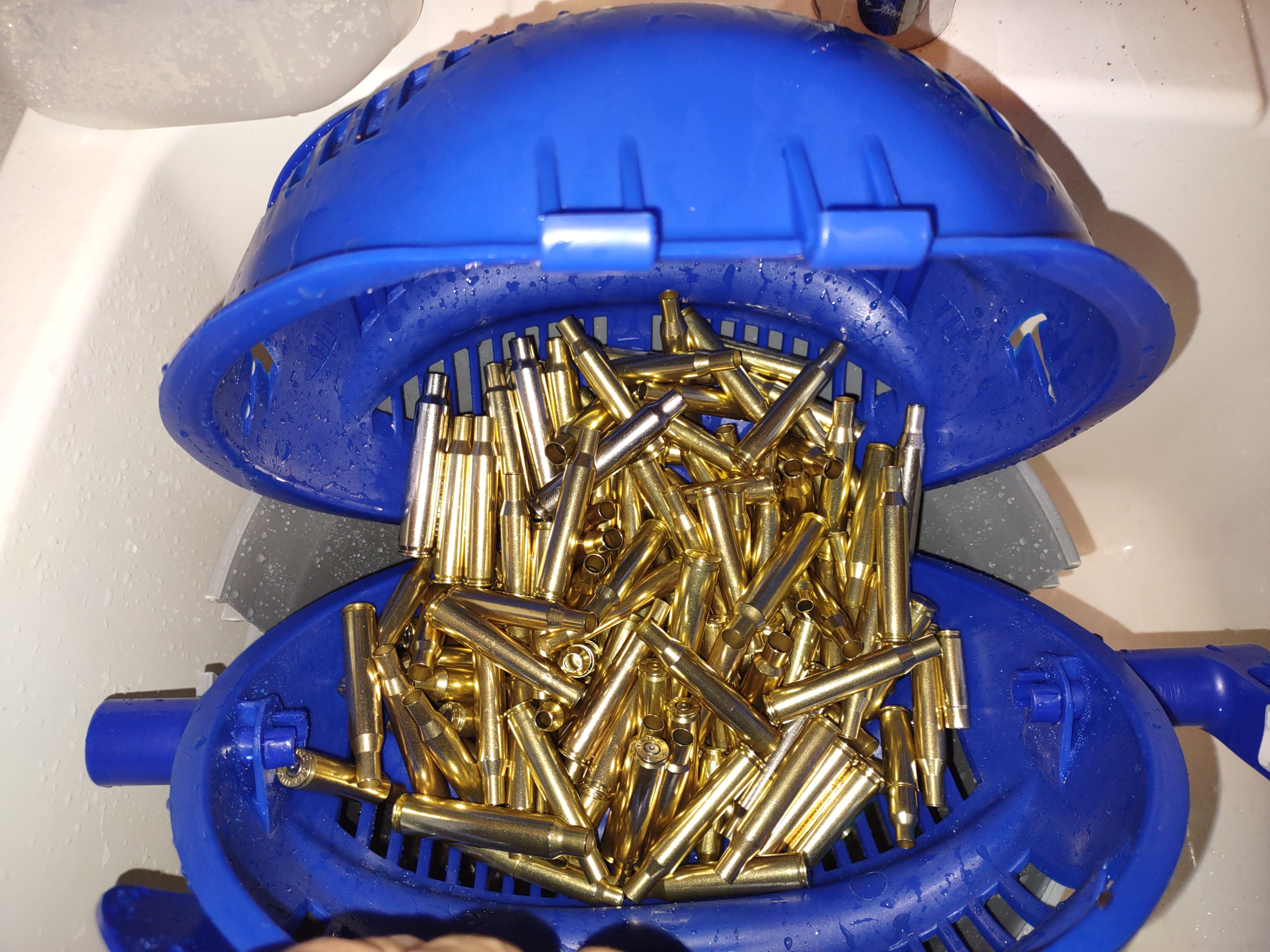

I didn't use to clean brass as I shot a revolver at the range and never let the empties hit the ground. At cowboy matches, it's helpful to have shiny brass which makes them easier to pick up after each shooter. The bays where we shoot are sand and gravel so it only makes sense to clean them in some way. I would not use treated media since it could abrade my dies. Using ammonia (Brasso & others) is controversial, some say no problem and others say it weakens brass.
I've got a Frankfort Arsenal wet tumbler with the SS pins. Brass looks new both inside and out.

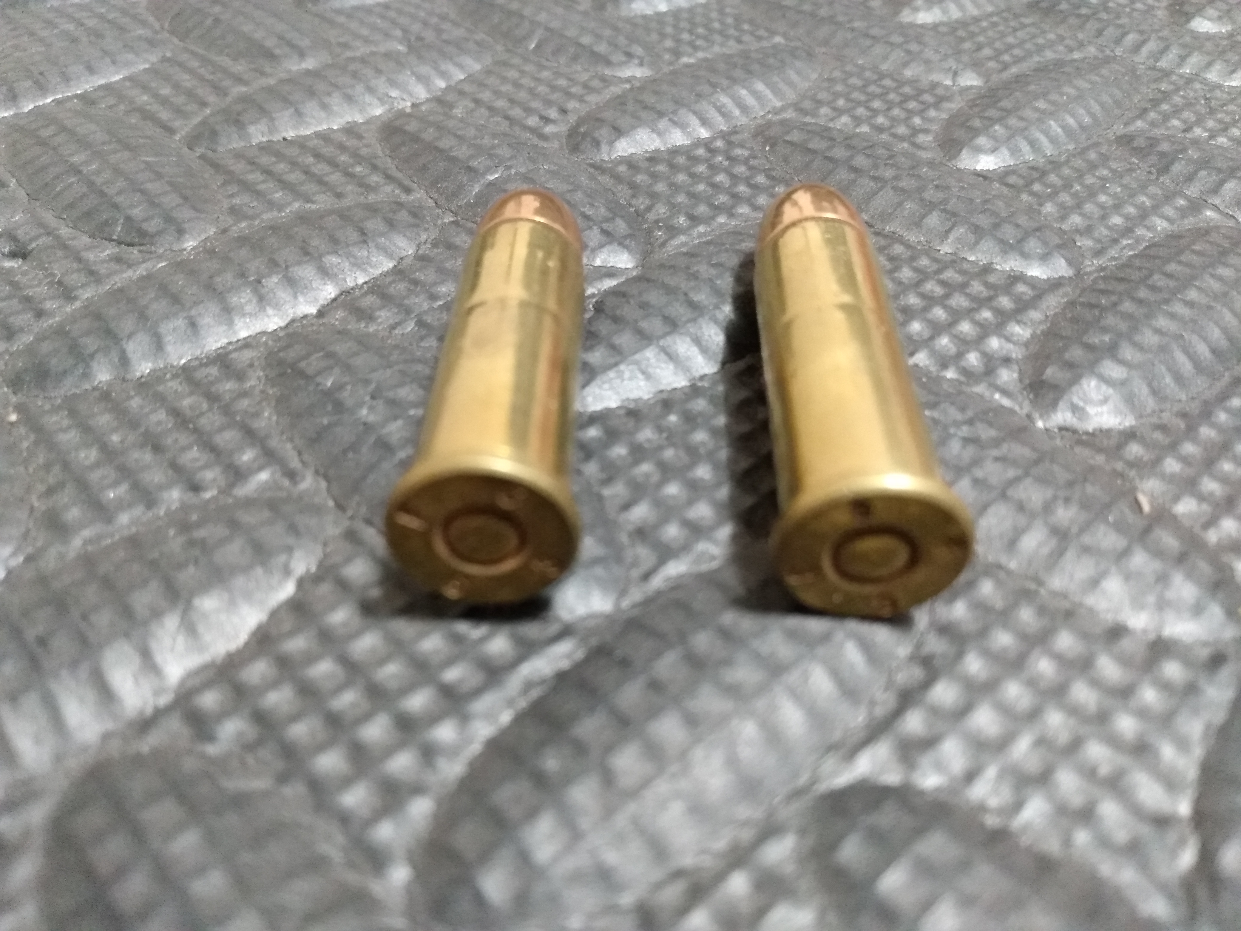

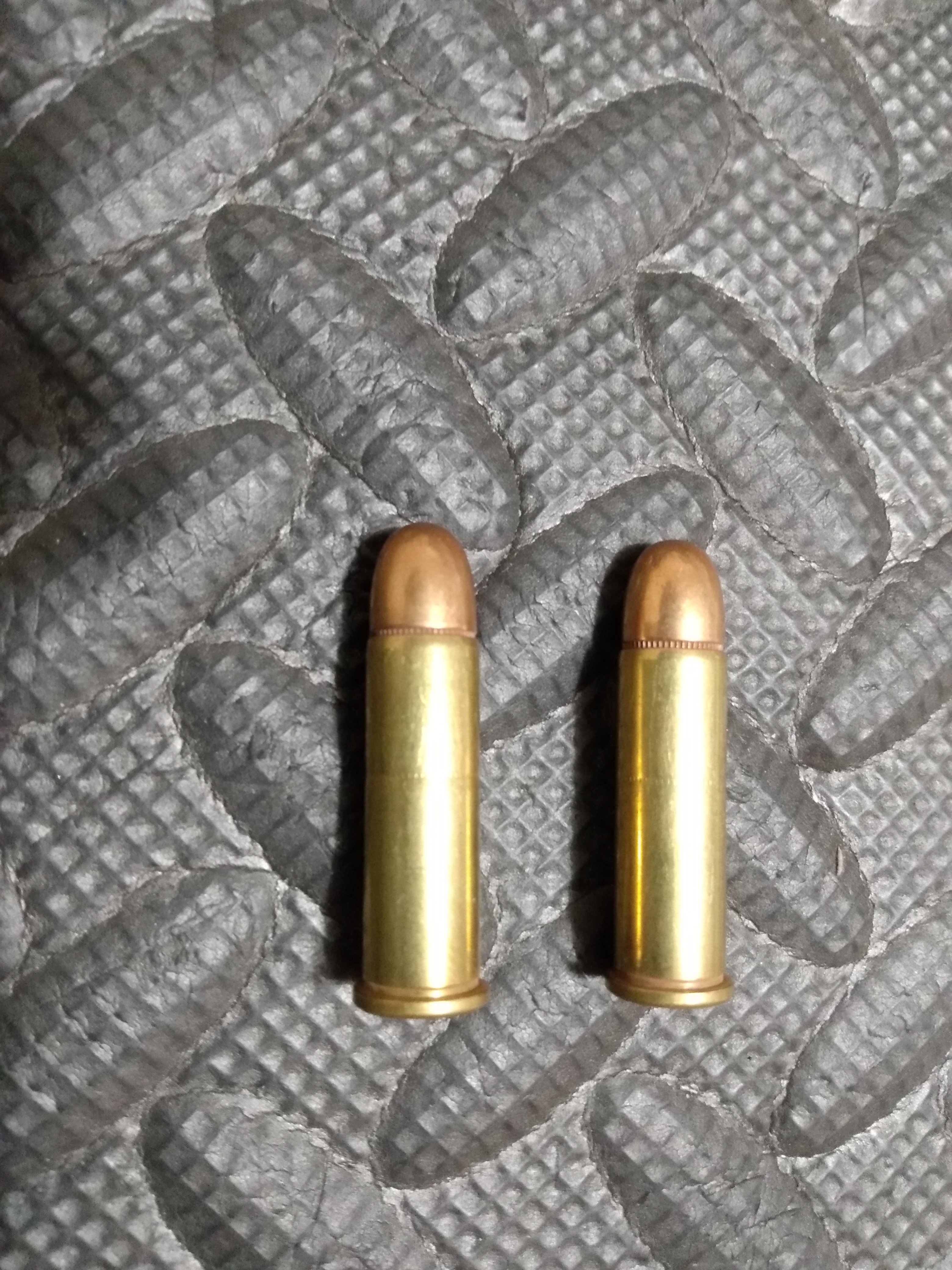

One note on Brasso... in years past, police officers purchased U.S. Military surplus 38 Special cartridges. The cartridges were brass cased with full metal jacket copper bullets. They typically polished the cartridges with Brasso along with their buckles and buttons, and the cartridges looked good carried in belt loops. However, Brasso causes brass to become brittle, and the cartridges would develop case neck cracks from bullet tension. I saw something similar happen to a friend's 22-250 case necks after he polished cartridges with Brasso after reloading.
For those who have never seen U.S. Military surplus 38 Special cartridges, I attached a couple of photos. I don't know if the headstamp is readable, but it's FC 63, indicating a 1963 manufacturing date.
