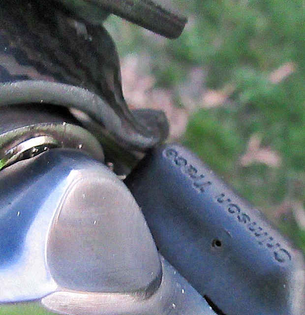

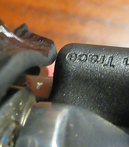

I put a set of Crimson Trace laser grips on my SP101...the hump from the laser on the grip
hits the top edge of my Kydex IWB (see picture below)...Has anyone had any experience with maybe heating and reshaping
a Kydex holster....the lip of the holster needs to be pulled out 3/8" or less to allow the weapon
to easily slide into the holster without catching on the top edge...I was going to take a dremel and try
to cut it but don't necessarily want to hack it up....anyone have actual experience doing this with a holster?
I have done localized adjustments to various Kydex shells with a heat gun and have used a Dremel tool to make cuts (such as taking an M17 shell to accommodate orange tip of an M17 Airsoft gun). It is not hard to work with if you take your time and use the heat sparingly.

Getting the Kydex evenly hot as well as the handgun/item and then apply even pressure so the Kydex can form fit properly as it cools - otherwise you might distort the rest of the form or shape.

I figured I would just keep the original MRT VP9 holster in case I ever wanted to put the original slide back on. My OCD however is such that when I have things that I literally have no use for I can't keep them around. I have thrown away or given away a lot of stuff for this reason. Most notably at least 6 Fender P basses which somehow keep falling into my lap and which I do not like, but that's another story. Anyway, about 2 AM this morning I have one of my episodes where I have some ignorant nightmare which sits me up in bed and I get my feet on the floor and sit there smoking a cigarette and I get the idea that I should try to modify this MRT holster. So this morning after a cup of coffee I go out to the shop and set to work. I used low heat on the heat gun and pushed out the bottom of the holster which was inhibiting the taller front sight, but the gun still wouldn't seat all the way. Then I saw it was hitting on the optic. It took about 5 rounds of snipping with tin snips and checking the fit, but in the course of about 15 minutes I successfully modified the holster and it now fits my OR VP9 perfectly. The Kydex is surprsingly easy to work with. Just use low heat and take it slow. Make sure you have the appropriate tool you are going to use to move the hot plastic before you begin heating it. I suppose you could just use the gun in most situations too.

Heat Gun and compression to mold/fit the gun, no problem. That's how they're made in the first place... I did reposition some walls on a Comp-Tac International to fit the P226 extended mag release better... Little heat, a steel rod to create the desired imprint and 5-10 minutes later is worked perfectly and didn't look hacked together...
