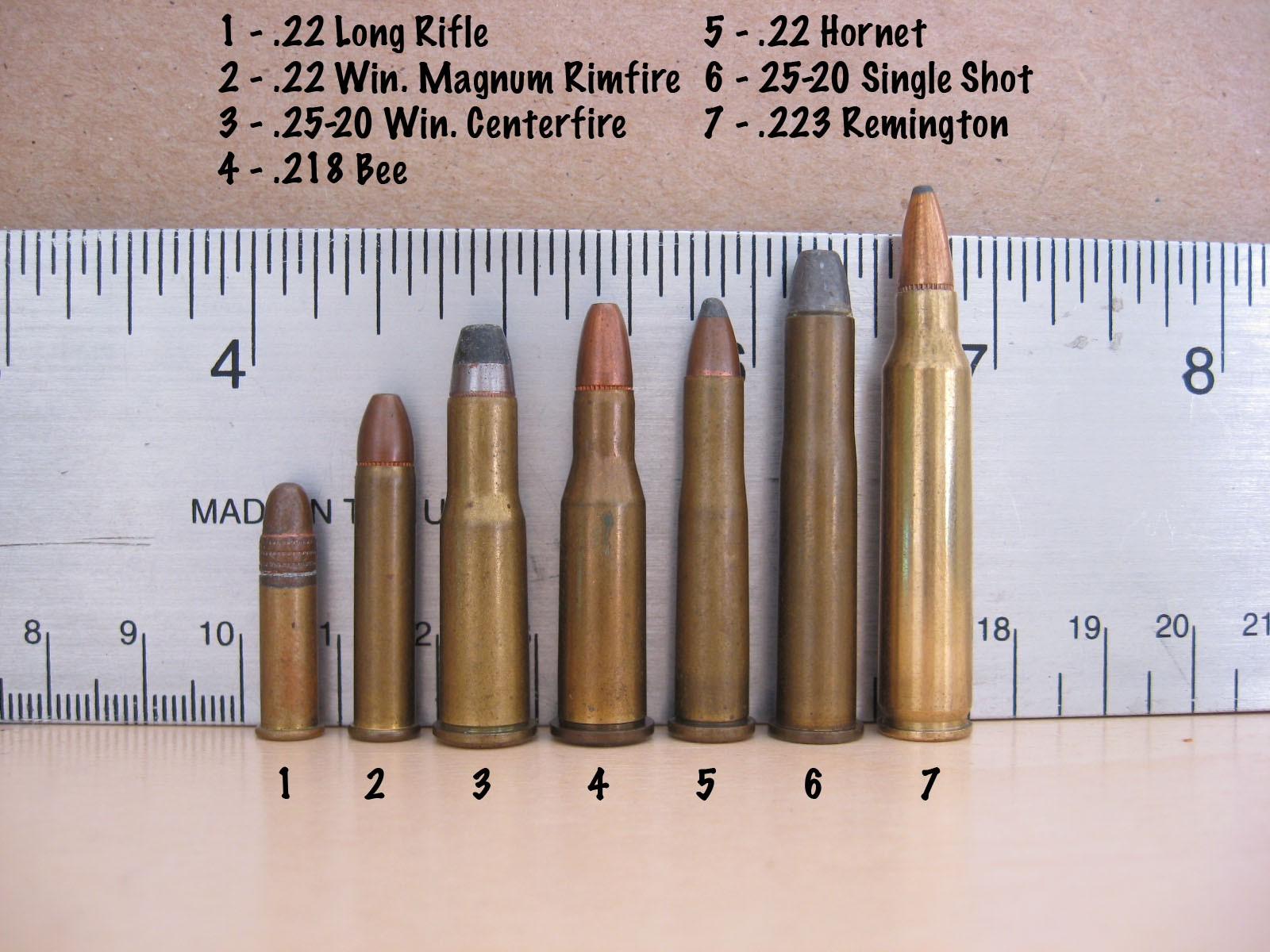

From left: .44-40, .38-40, .32-20 and .25-20.
