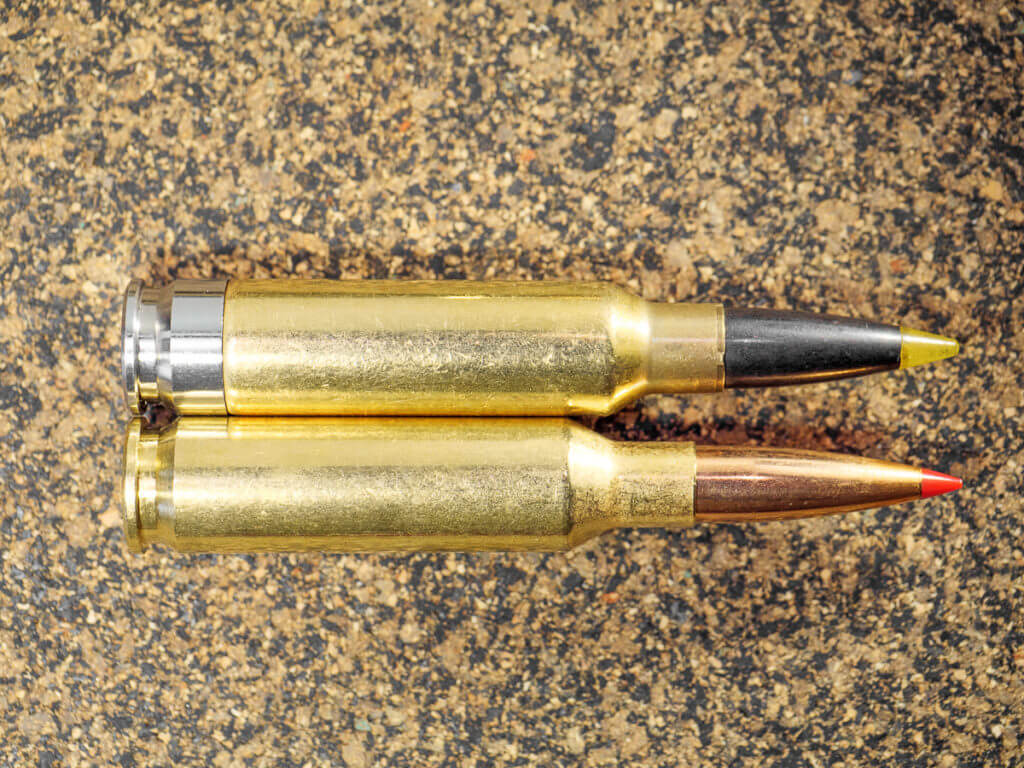

The cartridge uses a case that is the same length and diameter as the .308 Winchester.
Top: .277 SIG Fury. Bottom: .308 WIN.

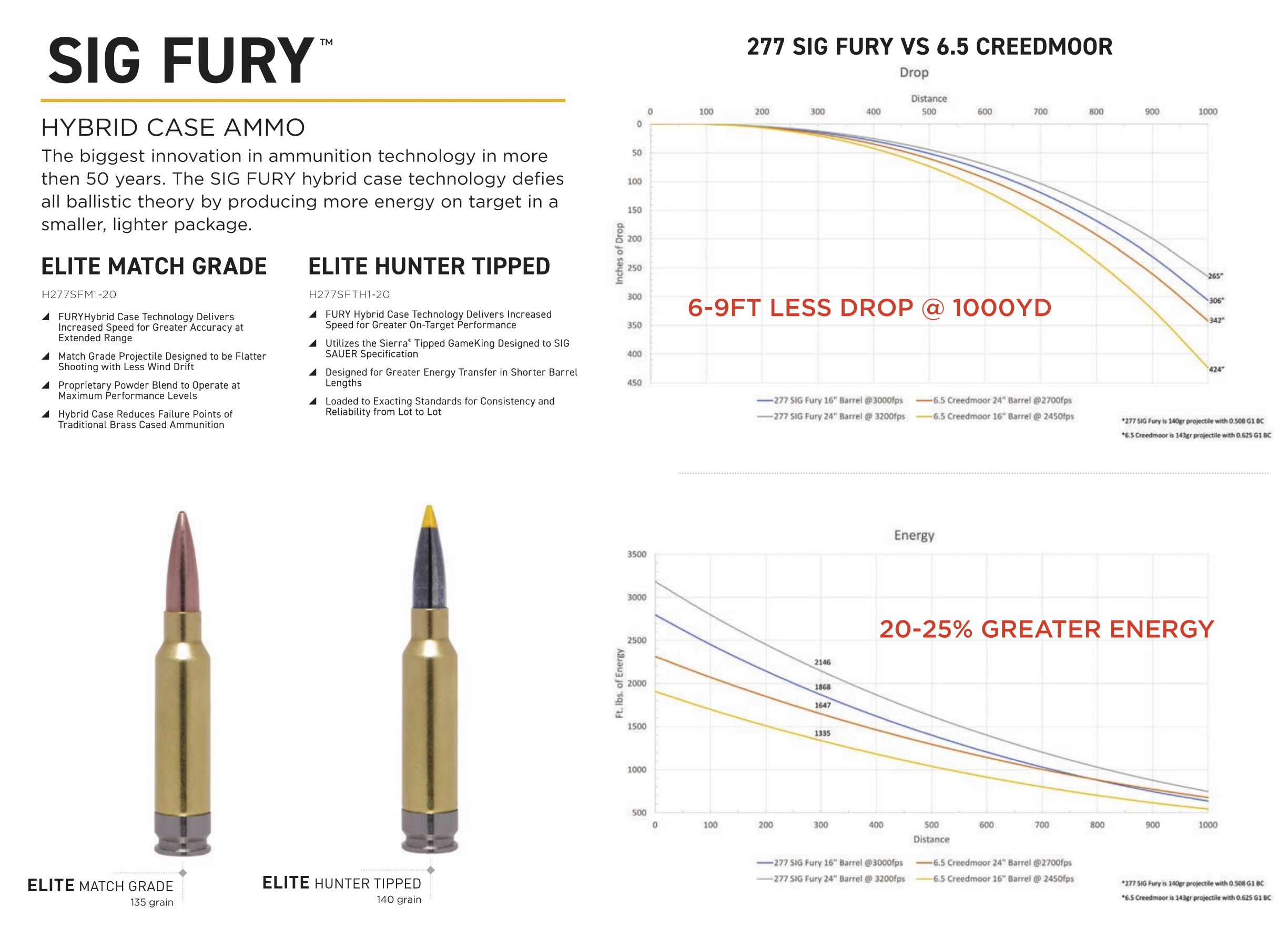

SIG Sauer claims that the cartridge has performance superior to the 6.5mm Creedmoor, exhibiting 6 to 9 feet less bullet drop at 1,000 yards, while delivering 20–25% greater energy.
Top: .277 SIG Fury. Bottom: 6.5 Creedmoor
