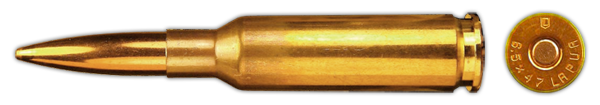

The 6.5×47mm Lapua is a rimless bottlenecked rifle cartridge that was developed specifically for 328–1,094 yd. (300–1,000 m) competition shooting by ammunition maker Nammo Lapua and the Swiss rifle manufacturer Grünig & Elmiger AG in 2005. The 6.5×47mm Lapua has no direct parent case. It was designed by Lapua with a great deal of help from Swiss rifle manufacturer, Grünig & Elmiger. The case also borrows many characteristics from the 6mm PPC and has proven itself to be inherently accurate.

The 6.5×47mm Lapua is a medium power cartridge often compared to the .260 Remington and 6.5 Creedmoor. It was designed from the beginning by Lapua to optimize accuracy, barrel life, and case capacity in a 6.5 mm cartridge for target and tactical shooting. As such it couples a sensible case volume to bore area ratio with ample space for loading relatively long slender projectiles that can provide good aerodynamic efficiency and external ballistic performance for the projectile diameter. The 6.5×47mm Lapua offers slightly lower muzzle velocities than 6.5 mm/.260 cartridges such as the .260 Remington and 6.5 Creedmoor, because of its smaller case volume.
In an article by the Precision Rifle blog a survey of the top 100 shooters in the precision rifle series (PRS) showed that the 6.5 Creedmoor was on average 50 ft/s faster than the 6.5×47mm Lapua. Although the 6.5×47mm Lapua is said to have superior brass quality, depending on manufacturer, compared to the 6.5 Creedmoor. The 6.5×47mm Lapua was the most popular cartridge during the PRS competition in 2015 beating out competing cartridges by more than two thirds.
C.I.P. rules the 6.5×47mm Lapua and 6.5mm Creedmoor both at up to 63,091 psi Pmax piezo pressure and the .260 Remington lower at up to (60,191 psi) Pmax piezo pressure.
