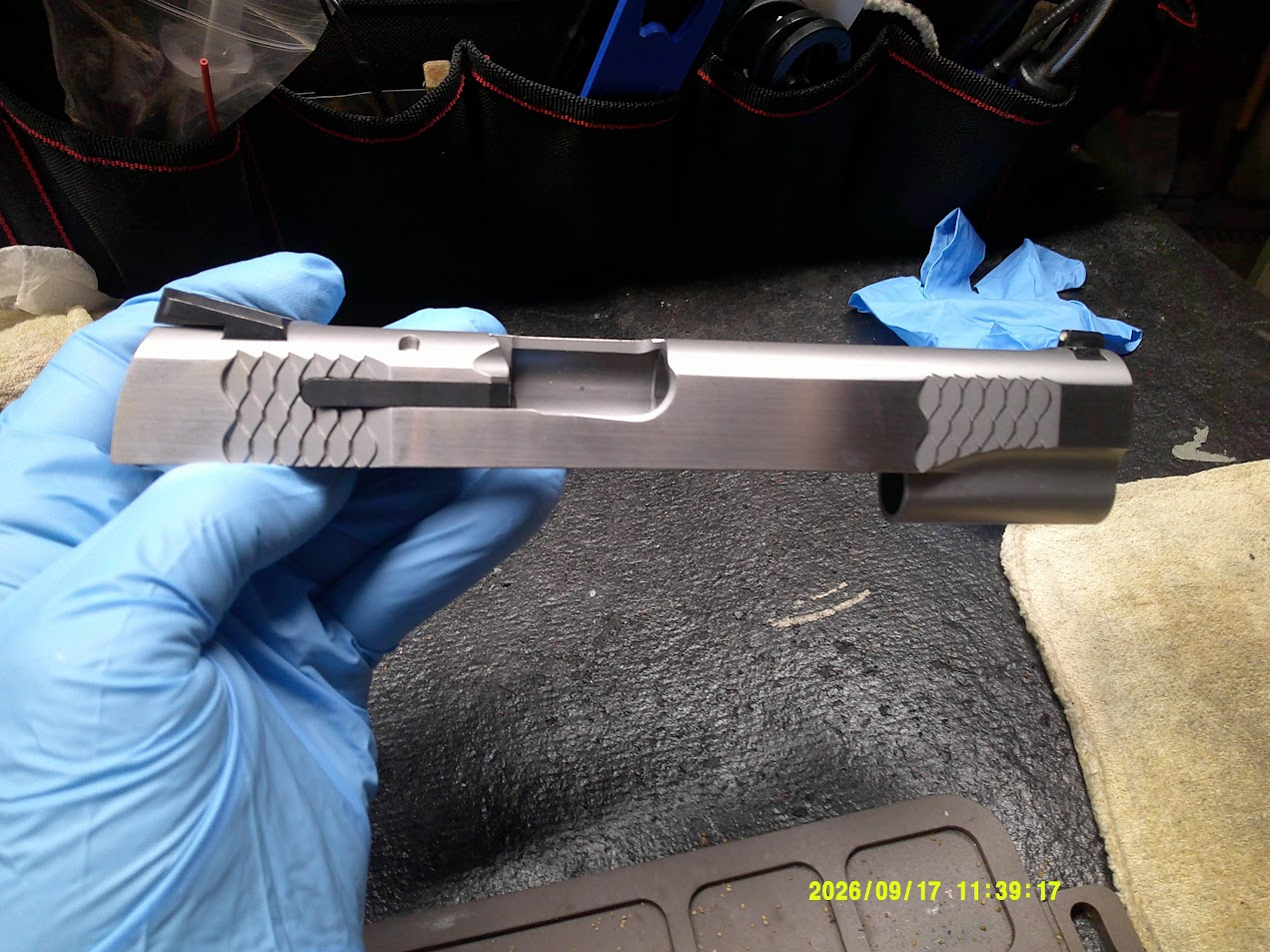

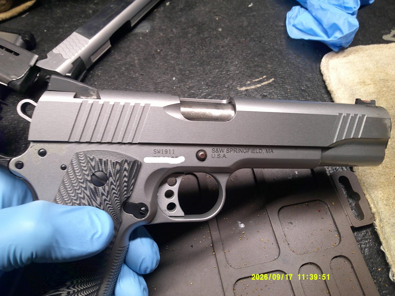

here is a pic of the OEM S&W slide

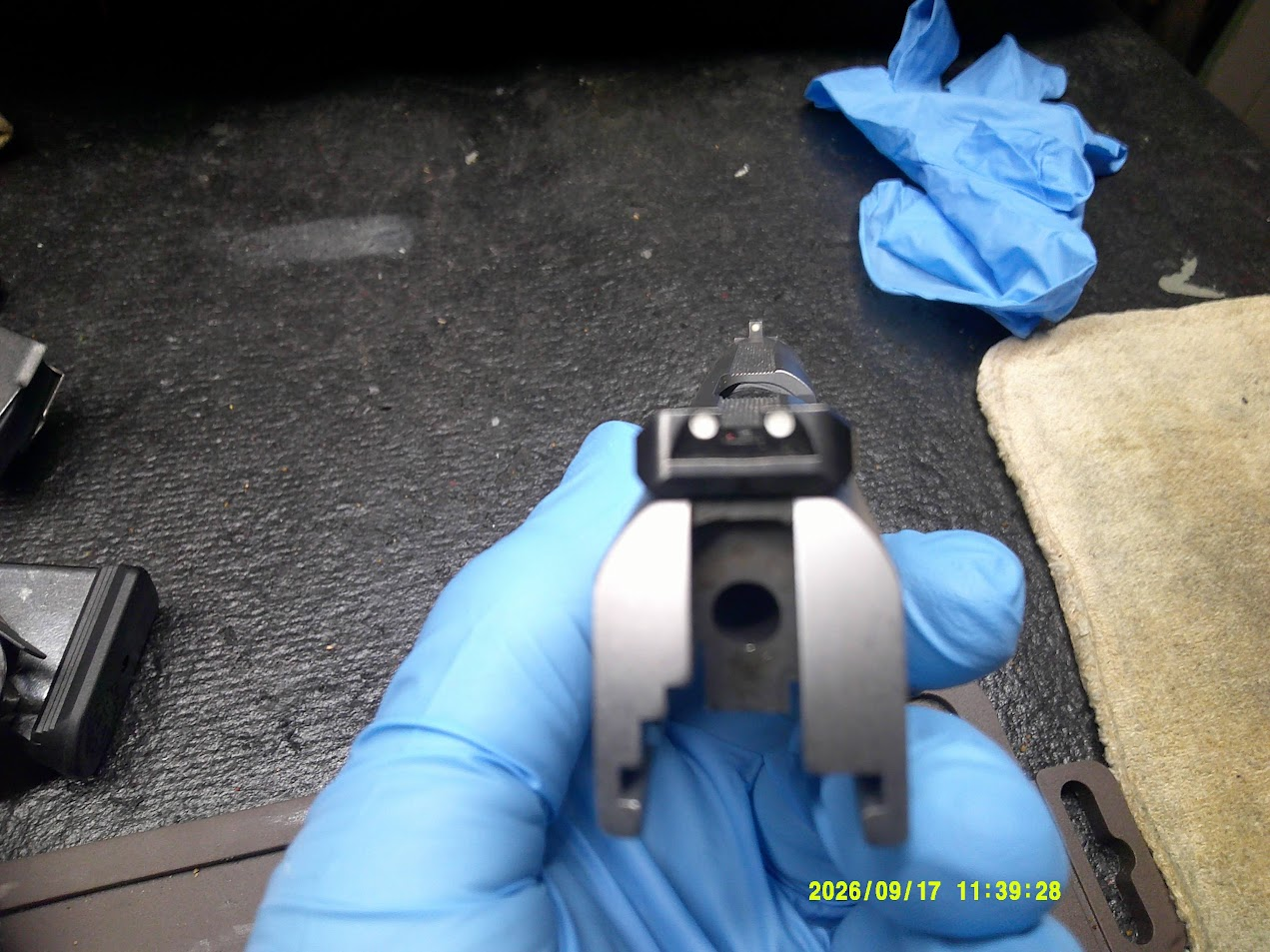

the OEM 3 dot Novak sights.
the new slide

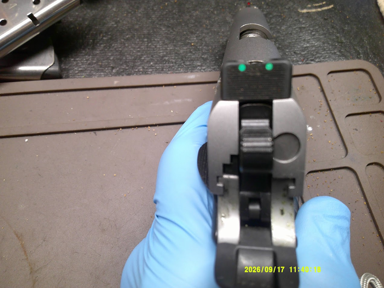

Novak green fiber optic rear/red fiber optic front
the only tools i used were the smithing files, to fit the sights, and the sight pusher, which you can see some marks on the rear sight.....oh well.....but NO honing stones for the slide rails....

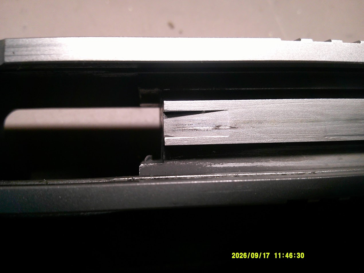

the place i bought the slide from, also cuts the disconnector ramp.....
the new slide
