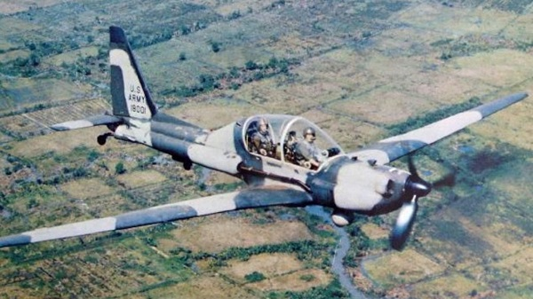

The Lockheed YO-3A Quiet Star is a rare, single-engine American aircraft built in 1969 for silent nighttime reconnaissance during the Vietnam War. Only 11 units were made.

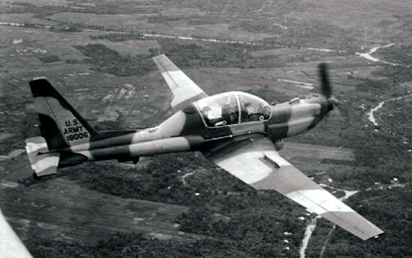

It flew undetected at 1,200 feet by using a belt-driven slow-turning propeller, acoustic sound-proofing, and an advanced muffled exhaust.
In fact, pilots of the YO-3A reported that they could generally operate as low as 200 feet (61m) and normally remain undetected, so quiet was the aircraft.

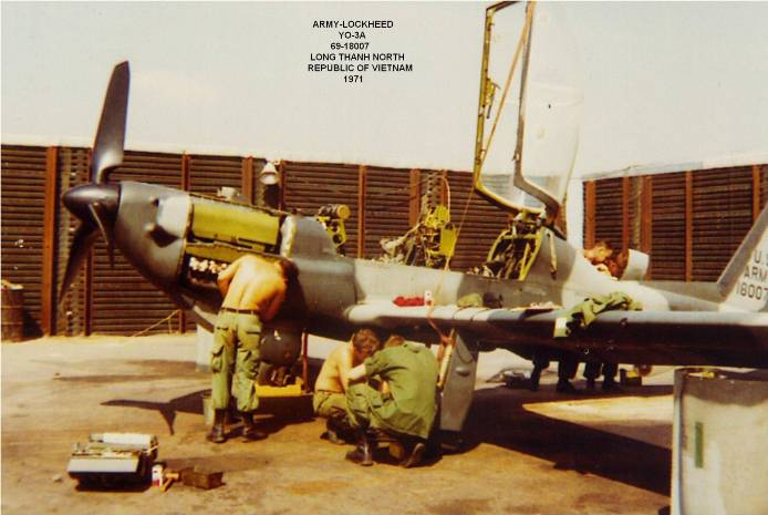

To further cut noise the engine compartment was surrounded with a fibreglass liner to absorb sound, and the propeller itself turned at a very slow rate of just 800 RPM, with drive via a belt-pulley rather than a mechanical geared system. Further, the exhaust was heavily muffled to both cut noise and flame signature.

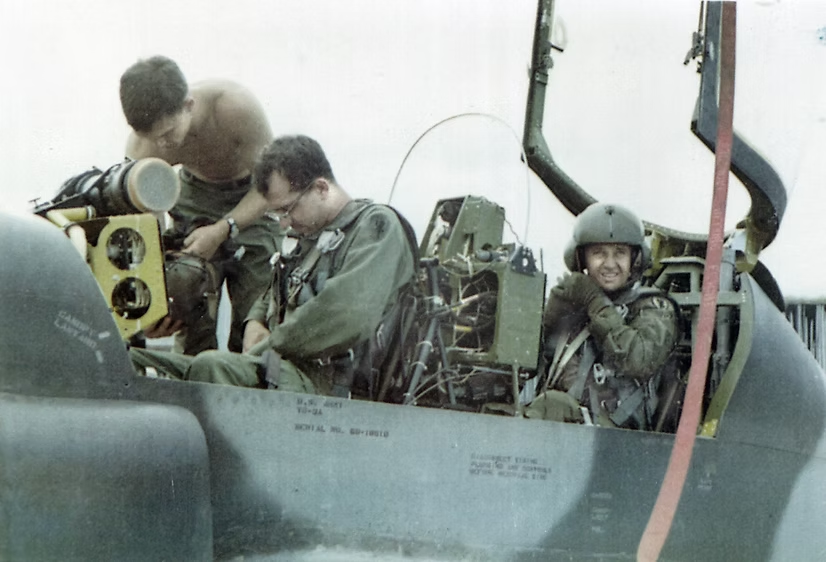

The two-man crew sat in tandem, with the observer forward and the pilot rear, and they enjoyed excellent visibility through the huge canopy. However, the eyes of the aircraft were actually positioned underneath the cockpit, with the YO-3 having a custom-made night vision scope in a movable turret.
This was supplemented with an active infra-red illuminator that could be used to both improve night vision or act as a spotlight for friendly forces equipped with passive infra-red equipment to highlight a target.
