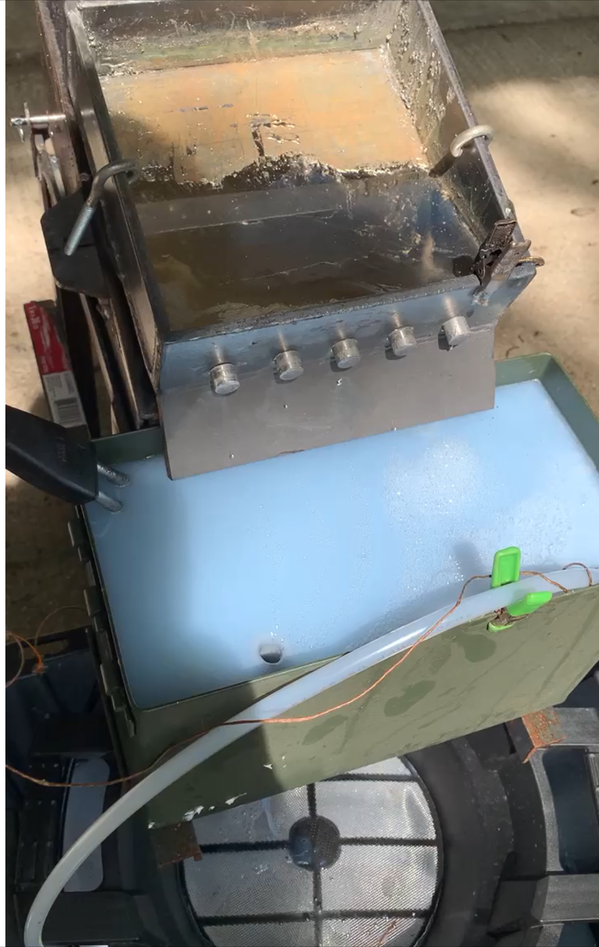

gotta make your own shot from free wheel weights 😆
