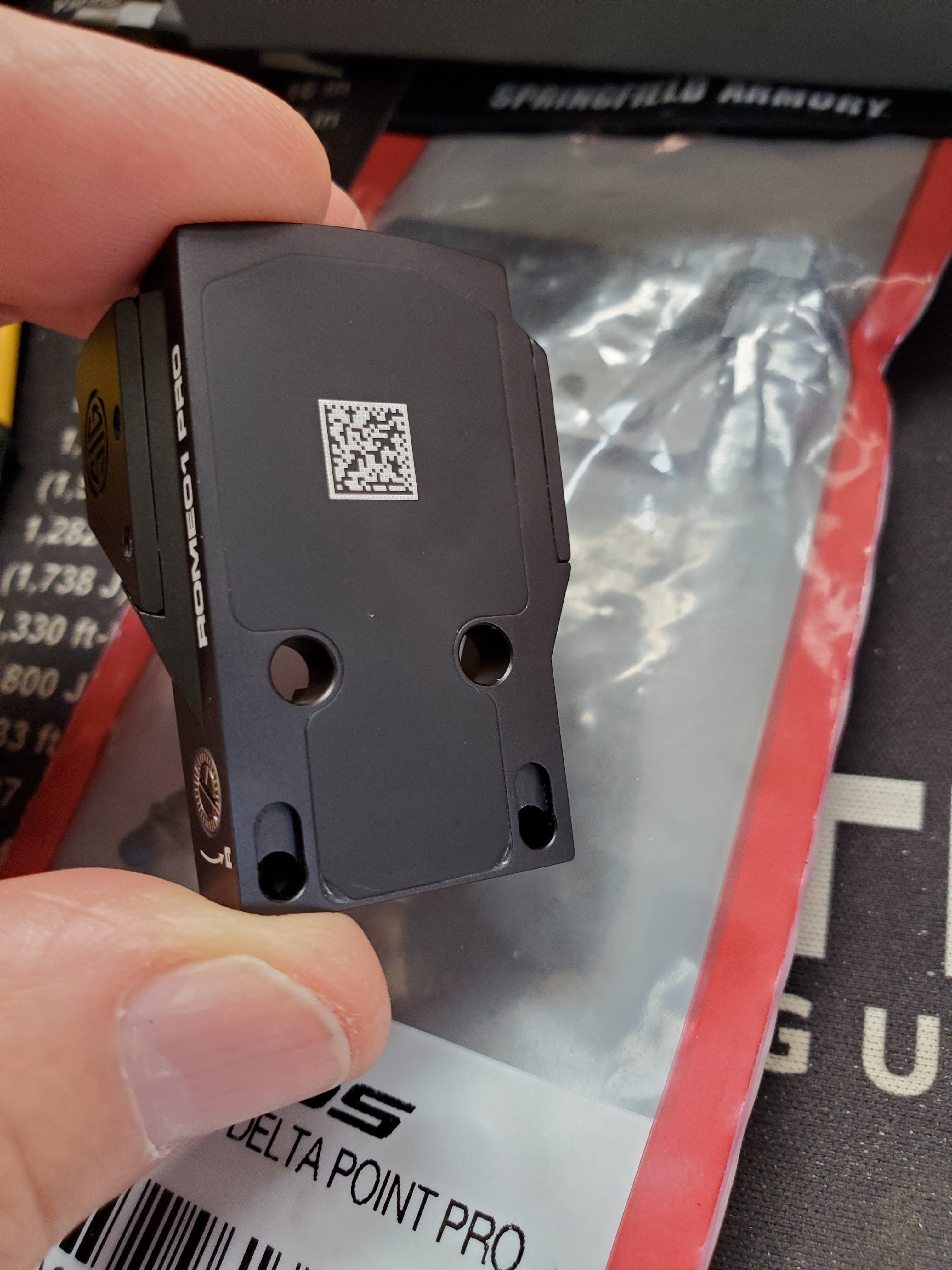

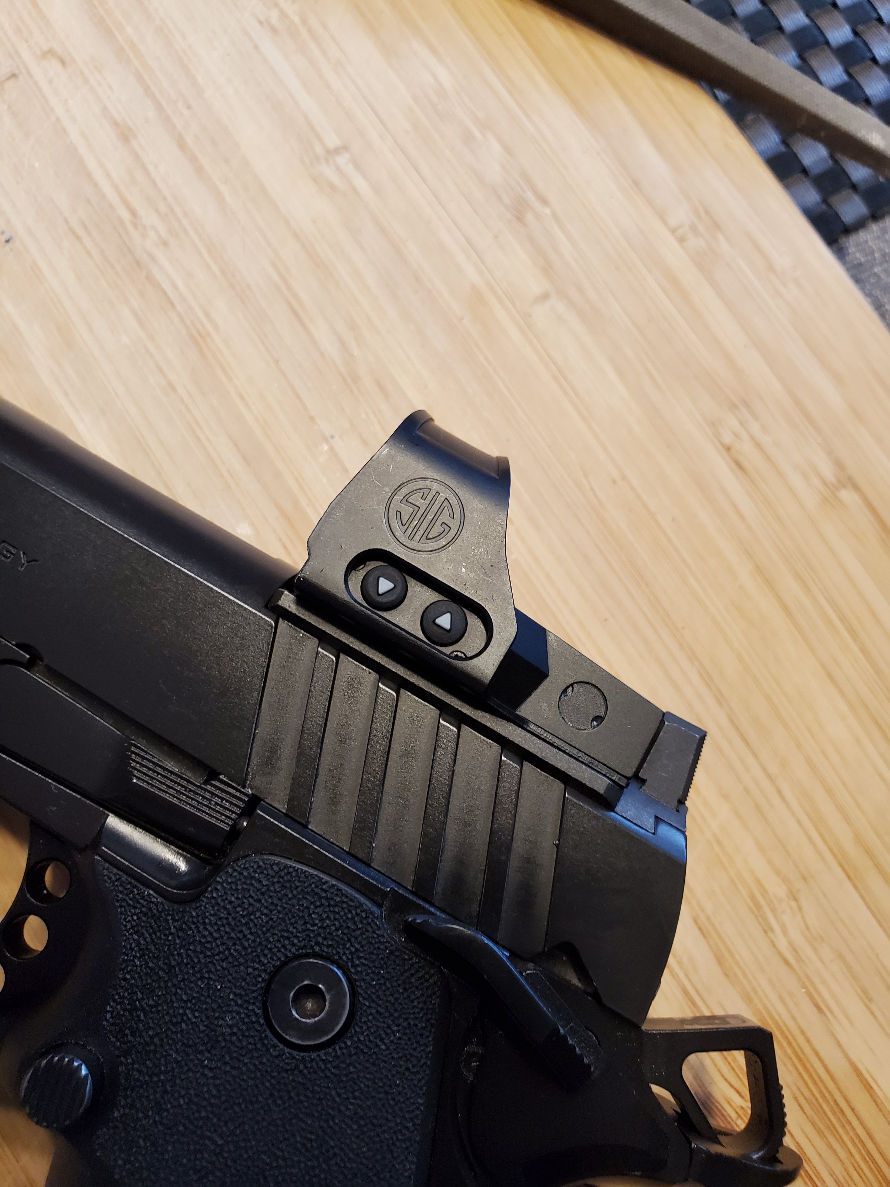

Got my plate for the DPP which has the same footprint as the Rome 1 Pro I had waiting to install. Unfortunately the lug pattern is different. ARRRGGHHH. There is no way to even file them smaller to fit. I am going to give the plate folks a call. If there is nothing coming or they can't make something, I will likely just file off the posts and make some type of shim system front or back as needed. Have also considered drilling the plate and using pins or drilling, tapping and using set screws as posts.

Good point. Sol, what is written on the package, and with the plate not mounted to the gun, does it fit on the DPP?
I know the AOS plates have been a pain to get…I’m wondering if you have the right one as well.
Off the pistol, the Viper Venom fit the plate perfectly… FYI.
Sol…hate to say this, but everything you have is correct.
The 15B states it’s for the DPP and EOtech EFLX. Both of those red dots have the 4 lug footprint.
The Romeo1 Pro does not.
Like you… I’m going to assume since the Romeo Pro fit on a Sig320 series along with a DPP…the same could be said for the Springfield AOS plate. It looks like that’s incorrect.
Again, honestly…I would’ve thought the same as you.

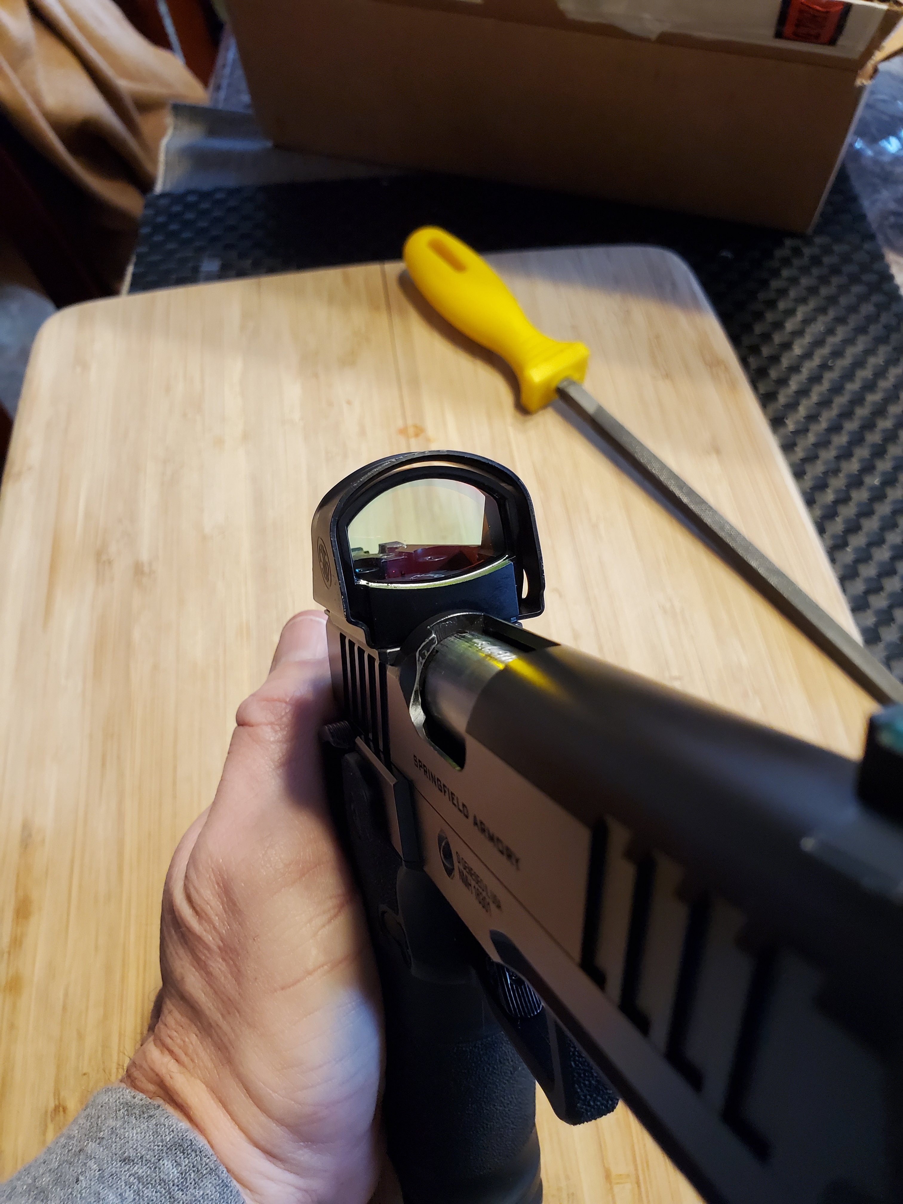

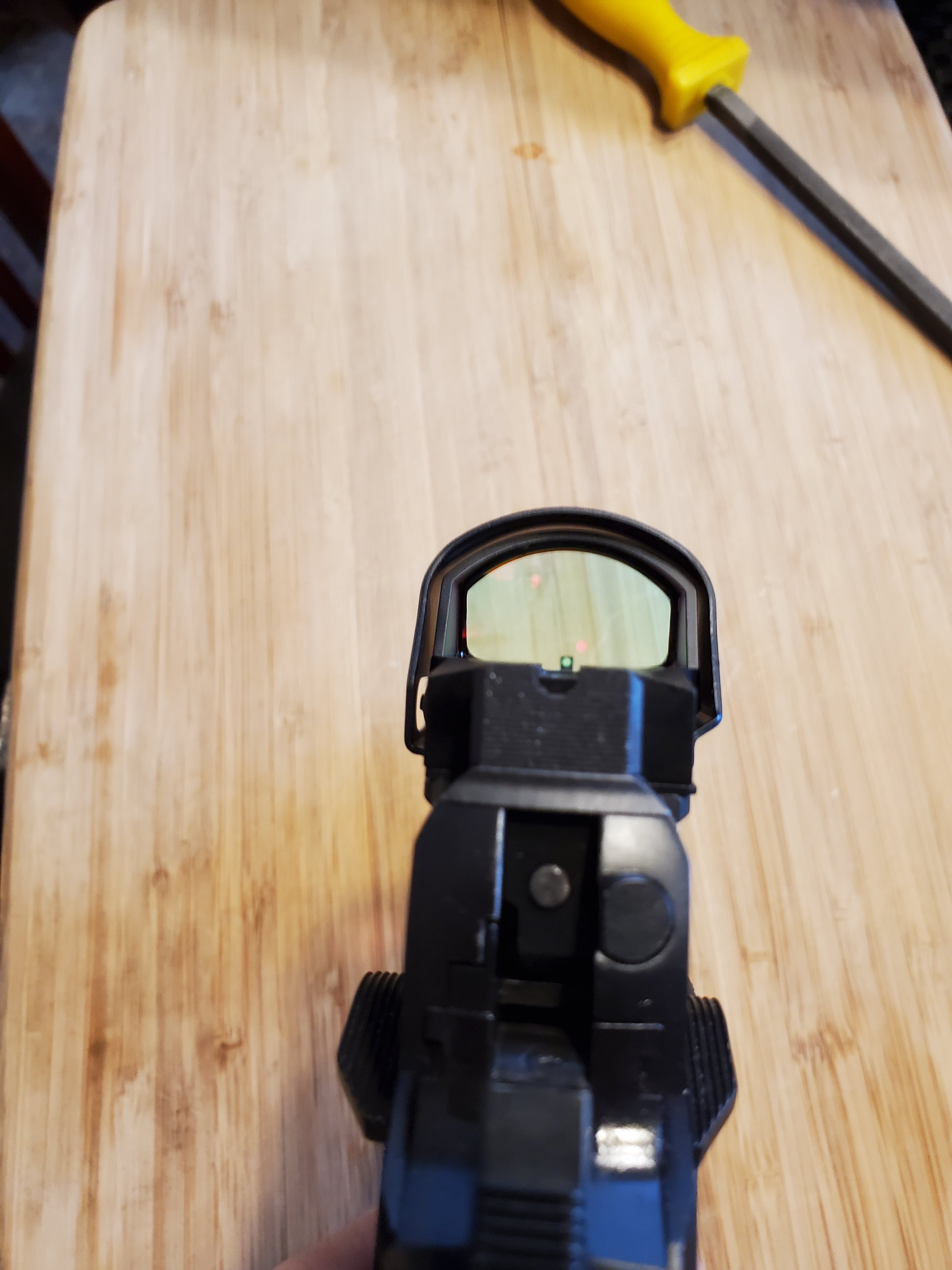

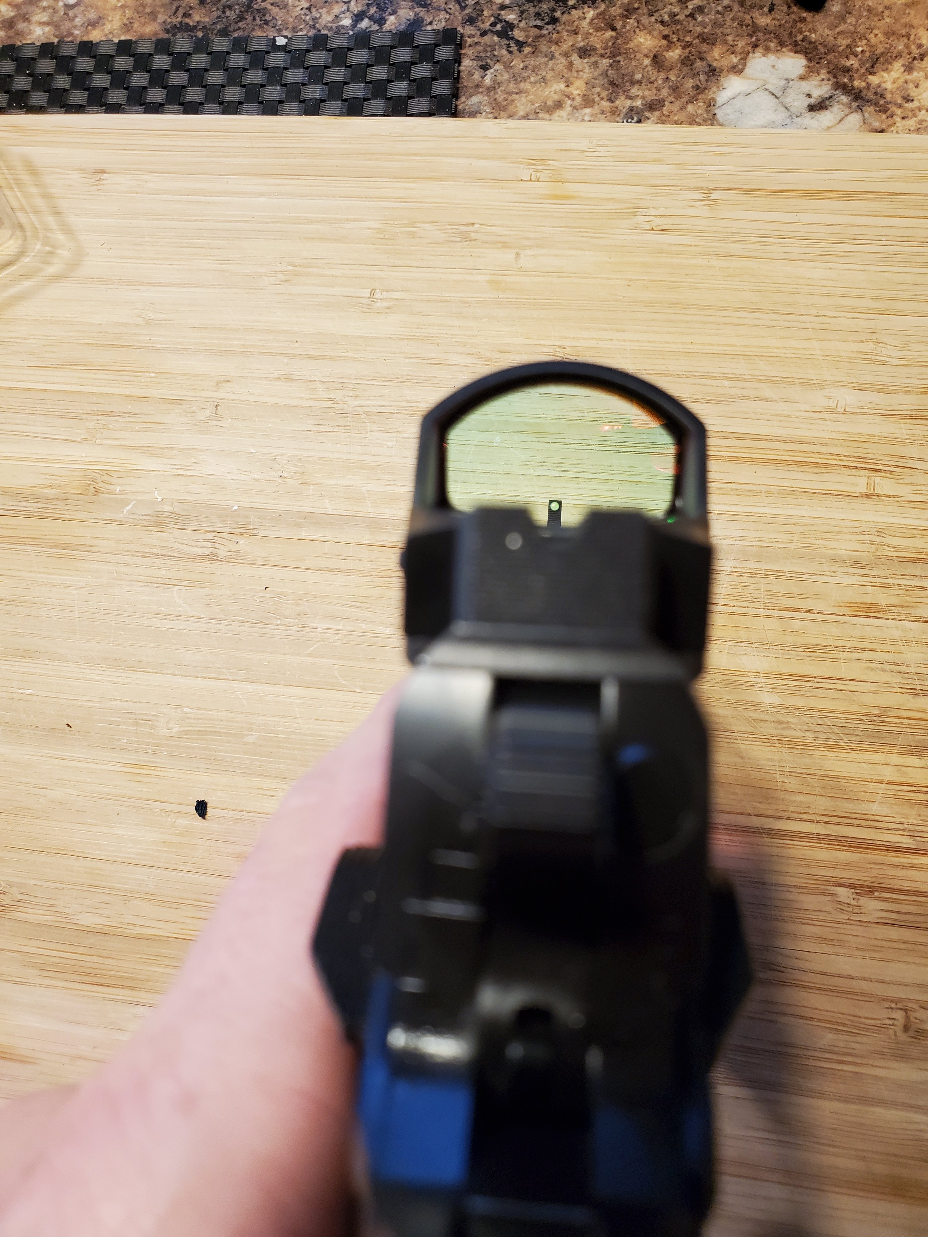

Sometimes I am not the sharpest tool in the shed. Just thought. Hey dummy, if you want a perfect co-witness use washers equal to the shroud thickness you fool. lol Much better and can see the sight perfectly for backup. First with dot off, second with dot on.
