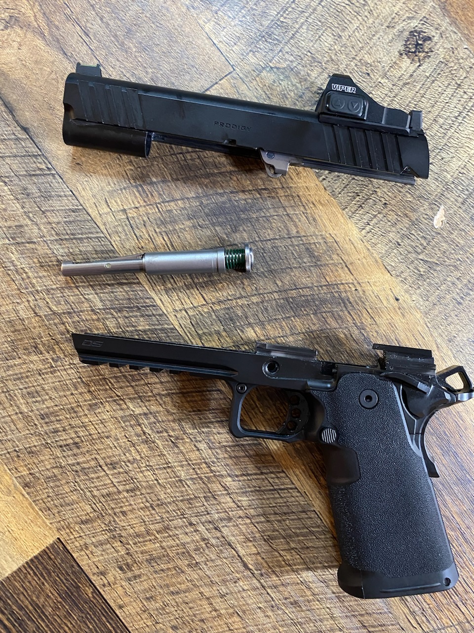

UPDATE: I never looked at the guide rod while shooting. I checked this morning and it had come loose. Really loose. It was backed out probably 1/8-1/4”. I have to think that this May be responsible (or at least contributed to) my FTF issues. Looking back at my notes I notice that the malfunctions increased significantly after about 100 rounds.
I’d replace the two piece rod. Mine never came loose, if anything the opposite, but it was a PITA and got sent down the road and replaced with a Dawson one piece guide rod.
Yep, just ordered up an Atlas one piece. I don’t like the idea of a paperclip or staple, it looks like the Atlas (Possibly the Dawson too…) doesn’t need anything and it’s made very similar to the Dawson in my Staccato.
The prodigy 2 piece didn’t really bother me too much…until I had the Stac P. After that… I realized the WAY better design.
The Dawson is a tooless, one-piece recoil rod that captures the spring. Here’s mine;

@SimonRL, I have a 4.25 Prodigy. I have that same dawson in my Staccato, I don’t see the same for the 4.25 Prodigy. I just got one from Atlas.
I don’t think they make one for the 4.25.
