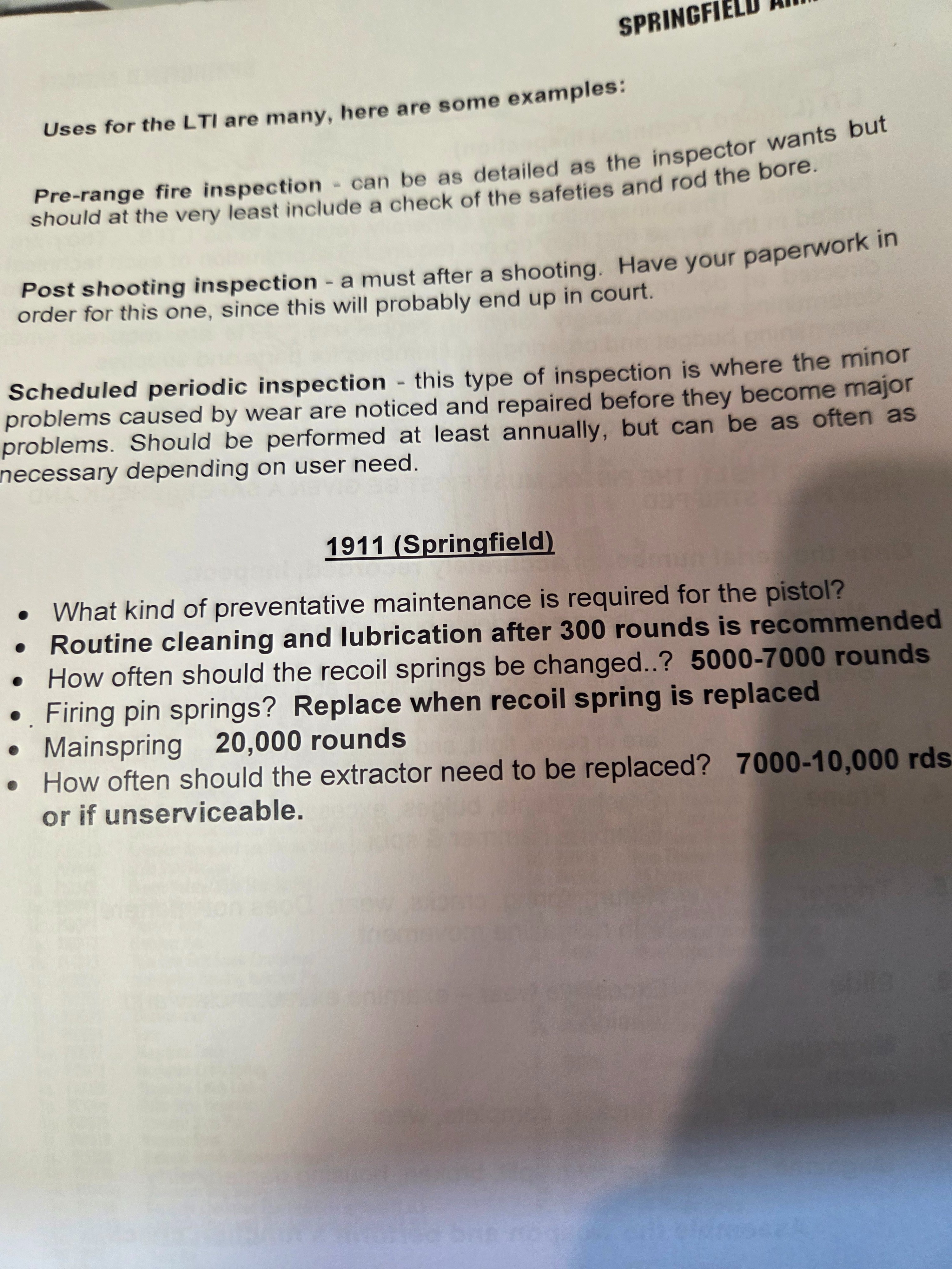

When I attended the Springfield Armory 1911 Armorers Course, it was recommended that you change the recoil spring at 5000-7000 rounds, change the firing pin spring when you change the recoil spring, and the main spring at 20,000. The SIG and Glock Armorers courses similarly recommended changing the recoil spring at 5,000 rounds, so I just follow that standard with all my semi auto pistols. Those courses have duty pistols in mind so expect them to be conservative, if it is a range gun not a carry gun and you are comfortable with it, just shoot till something breaks.
