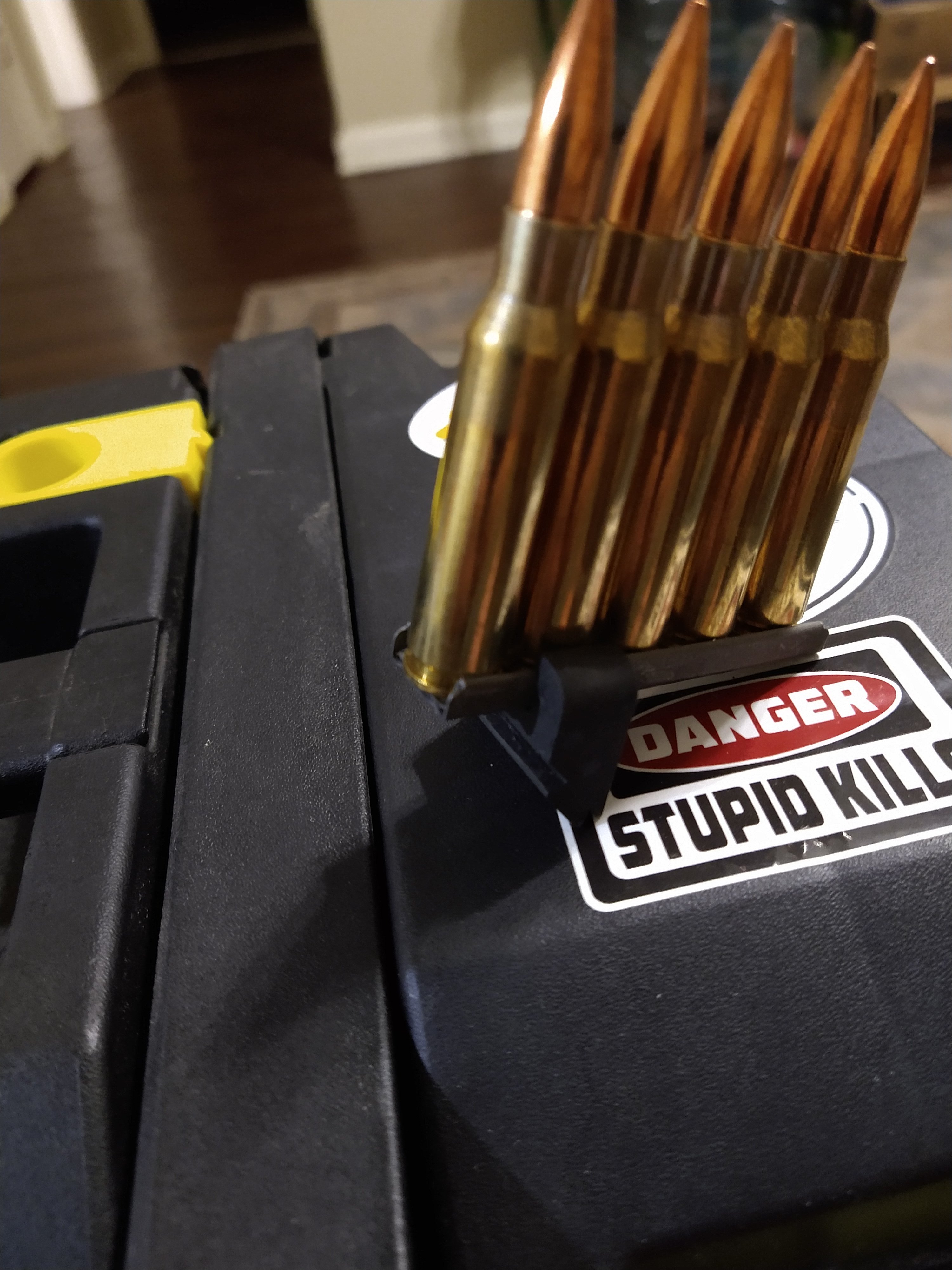

The OP brings up a couple of questions. Are there a multitude of stripper clips for M80 rounds? Maybe some fit the M14 and others are specific to a different rifle that may have had a clip guide? I can't assist, because I do not have any strippers for my M1A (although if I found some I'd certainly buy them). Were there different-size clip guides and linstrum's is one for a different application, installed by mistake? I have Armscor, Federal and PMC in my stock (some .308, some M80) and all fit just fine through my rifle's guide. Without any clips, though, I cannot verify linstrum's claim.
To use stripper clips on the M1A I believe you need something like this:
Stripper Clip Guide M14 M1A USGI
Springfield also uses the dovetail for the installed stripper clip guide for the Scope mount with a different insert into the dovetail in the receiver.

It seems that shanneba may have solved the mystery of what is installed on my rifle, where two types of stripper clip systems have been used. One type was most often used, and the other that uses the adapter shown in the photo in shanneba's post, was used in conjunction with a scope mount that was installed in place of the usual stripper clip guide. So, thank you, shanneba, it looks like I need to invest six bucks, plus shipping and handling, to get a stripper clip guide adapter.

I really can't answer why... I bought a M1-A bout 5 years ago in scout squad. I removed the clip guide in order to use a (Bore Buddy) for doing basic cleaning. The the guide was in the way. So with that being said.... It got my curiosity up and I went on a small safari looking for the old guide. Clips fit right in. Basic military surplus clips from Lake City Missouri.
