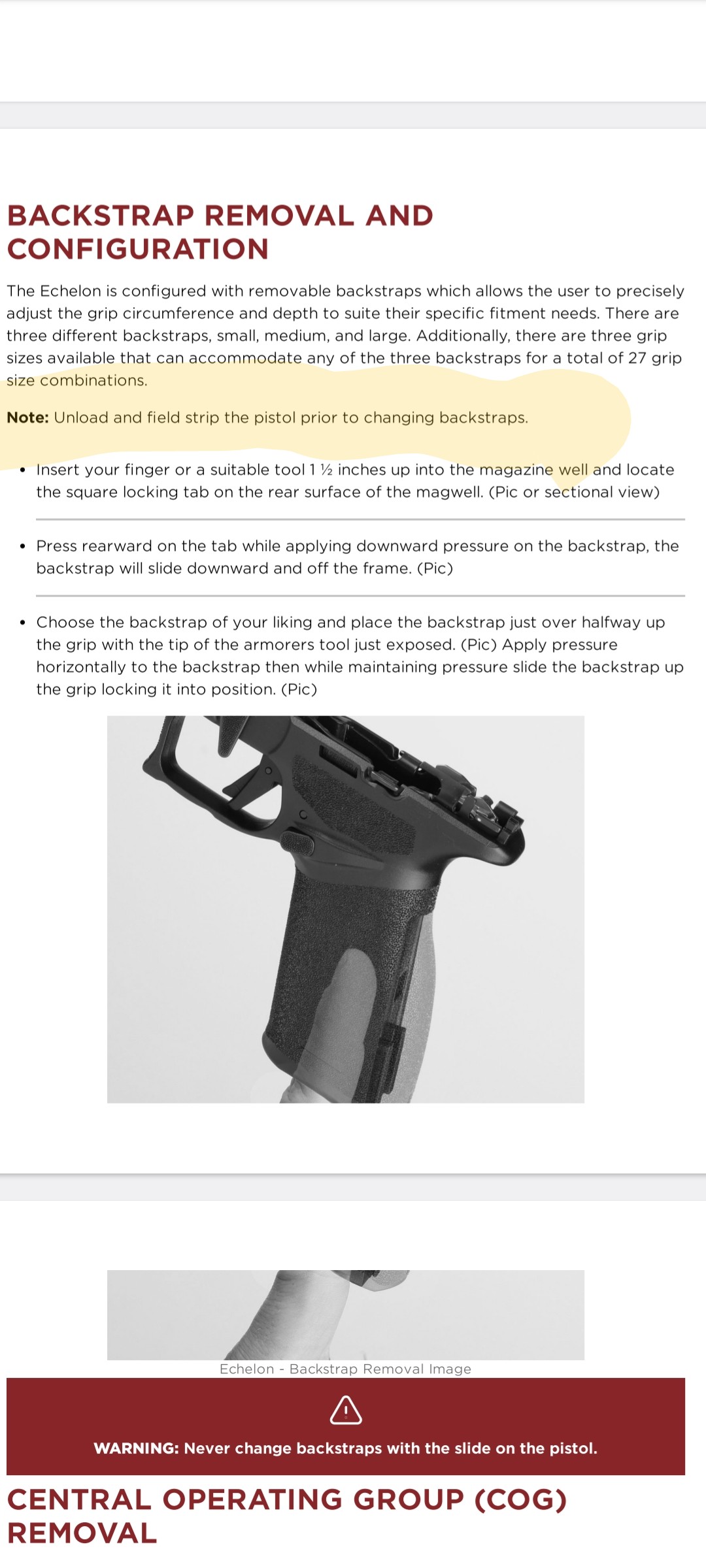

Just can't comprehend why Springfield decided that field stripping was the way to go to change the backstrap... A simpler design was right under their eyes: the Smith & Wesson M&P2.0 Performance Center! Maybe protected by some design patent, but could have been slightly modified to work around it...

There is no need to disassemble anything other that removing the mag.
Guess you can’t be to safe. It absolutely is not going fire that way.
I guess it won't. That's not my doing, it's Springfield's own doc. If you say it can be done without, then great. Makes no sense from them to instruct field stripping. Note that I don't have an Echelon, just marveling at the silly documentation, and @xdman recommendation.
Seems like you have one and have done it without taking the gun apart, makes far more sense that way, must have been a Croatian translation issue in the documentation :)
Probably a lawyers instruction to be absolutely sure that this gun will not fire when you are instructing a user, in writing, on how to do something to your firearm. Liability issues.
I guess so. There is one warning that's even weirder in there: "never change backstrap with the slide on the pistol" WTF
