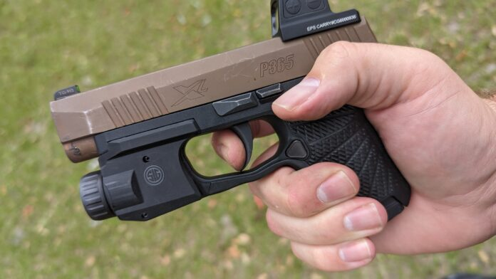

Finger Position, Triggers, & Accuracy
Remember those diagnostic targets that were popular a decade or two ago? They advised the same thing. The question is, does it matter? Does it really? To what degree does it matter, and is it universal or maybe applies more to one weapon and one task than all of them?

There are no muscles in the fingers, all the muscles that control the fingers are in the hand and forearm. Grip and trigger management are thus inextricably linked. If the tissue of the trigger finger at the middle or distal phalange is in contact with the frame of the gun during the trigger pull, the tissue compresses and exerts pressure on that side of the gun, which of course moves your front sight in the opposite direction. Also, if you make a fist with your empty gun hand, you will note that your wrist turns a bit inward-it is how you are designed. Those two physical factors explain why a lot of right hand shooters tend to shoot left, vice versa for southpaws. We need to train ourselves to isolate trigger pull from all the other stuff going on in your hand and forearm in order to make the shot without disturbing the sight picture. The thumb forward grip with the support hand helps a lot, as does finger placement that does not exert pressure on the side of frame. If the gun does not fit the shooter you get an exercise in frustration because nothing will line up right.

You all know I've been struggling and practicing for a few years now trying to perfect my procedures. Using the middle of the pad on my trigger finger works great when I do everything else properly. I'm getting better at NOT gripping so tightly with my strong hand and keeping a firm grip with my off hand. This allows me to press the trigger straight back. I enjoyed the article but the explanation offered by Mr. @HayesGreener is spot on, at least in my situation. I think the better I understand this, the more accurately I will shoot. My thanks to both Mr. @Talyn and Mr. HayesGreener.
Excellent explanation. The guy who taught me the most about pistol shooting used to have us put a BIC pen in the "Y" of our trigger hand with the tip up against the trigger finger. The exercise was about learning to curl the trigger finger back so the pen slid in a straight line. It's about putting the right amount of the pad of the trigger finger in contact so that you can increase the pressure back in a 'straight' line.
