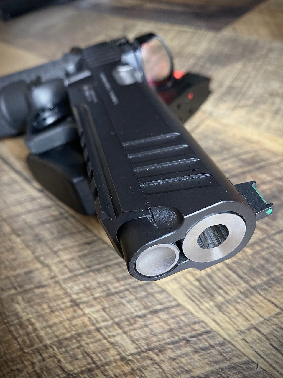

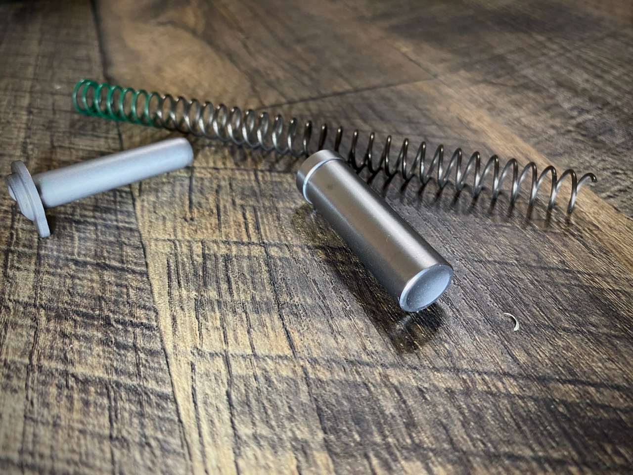

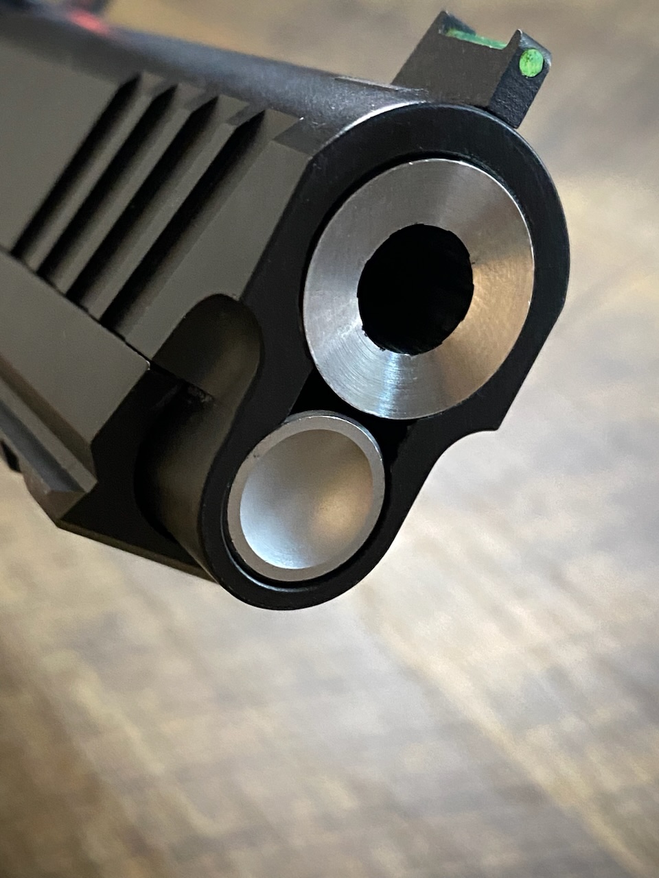

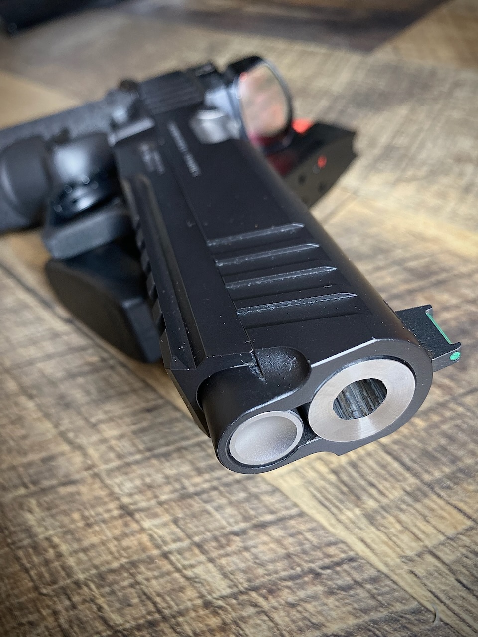

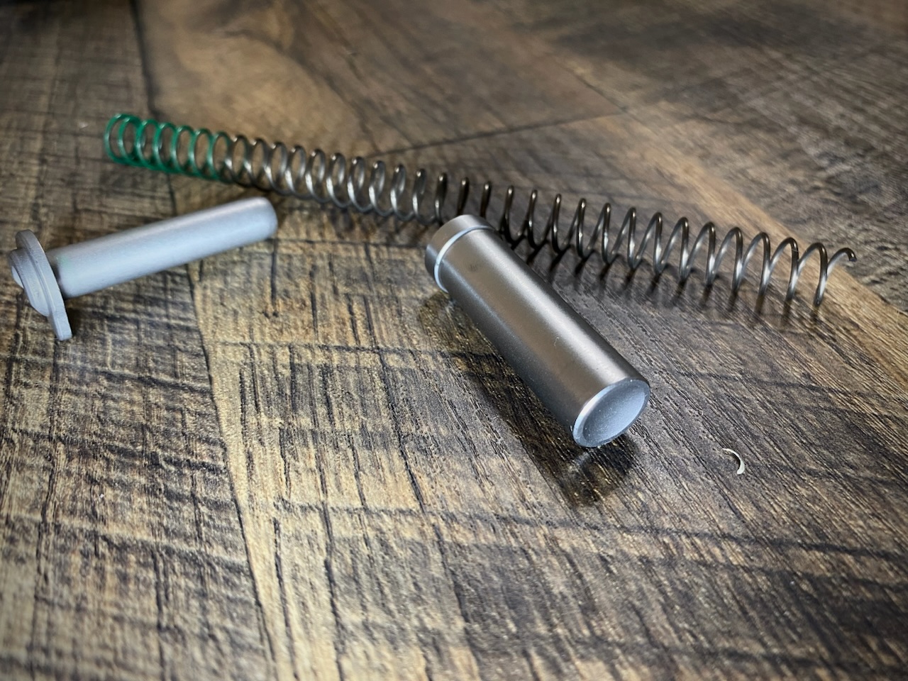

A couple of weeks ago I reported on the Dawson one piece recoil rod for the Prodigy. At the time I saw a pretty nice solution for the two-piece recoil rod from 10-8 performance but it was out of stock. They have a reverse recoil spring plug for the 5 in Prodigy and I got a message that it was back in stock and I ordered one for the princely sum of $20.95. The 10-8 plug allows you to use a standard GI recoil rod and spring for a more traditional look. I think it looks very nice, although it’s a little fiddly holding it all in place when you reassemble the gun. I’ll be taking it to the range tomorrow and will report back. The Dawson captive recoil rod works perfectly, btw.
I like how that looks…
Got the Prodigy to the range today with the 10-8 reverse plug and GI recoils rod and the gun felt fantastic. I do t have imperial data because banging ragged holes in targets has become the Prodigy’s SOP, but at today’s session the gun felt like it was in the zone, like I couldn’t miss if I tried. I like the Dawson one-piece piece guide rod, but I’ll continue to use the 10-8 for a while because I’m the gun felt so dialed in. Prodigy top left and bottom center at 10 and 15 yds
VERY Nice! Good to see the Dawson parts work well in it.
