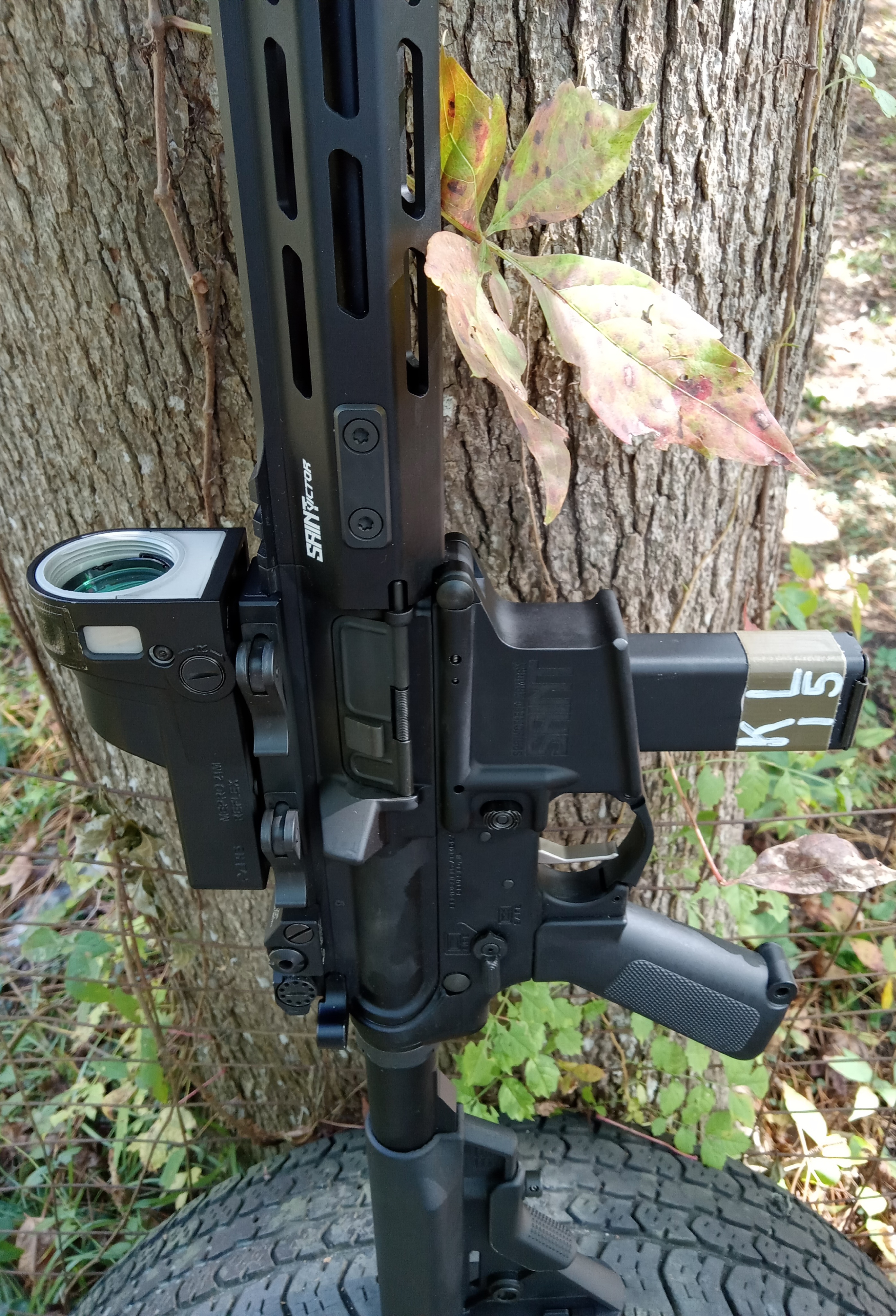

Gave her a good once over a little bit ago, I found that the right side of the ambi safety was very loose.
And I came to a conclusion about a problem I had yesterday, I drew blood on the middle knuckle of my middle finger of my right hand, seems it's from jamming my hand up into the grip and the trigger guard, lower, and pistol grip joint all getting my flesh fed to it.
Looks like I'll be going to a Tangodown Battle Grip to smooth the joint up.

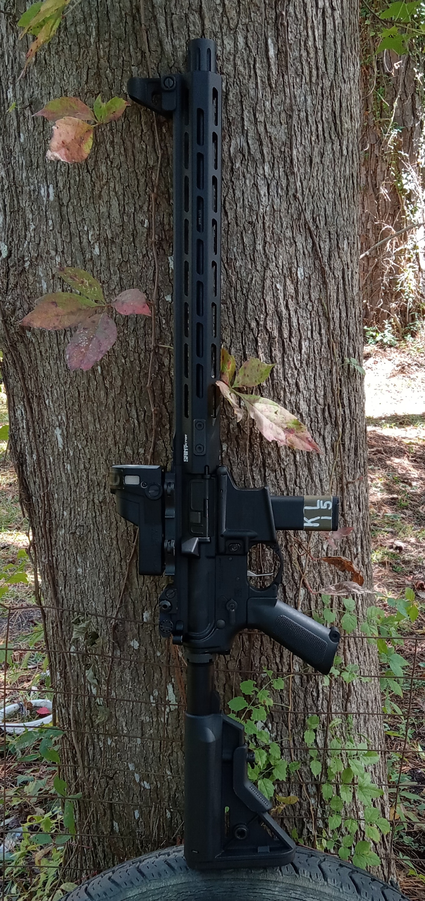

Here's the more or less final setup, the Meprolite will get the same kill flash and polarizer as my other rail mounted M21.
I had my doubts as far using it on a PCC, but I was more than pleasantly surprised by it.

Same thing happened to me. Was at the range shooting and while reloading the mags I had blood on my right hand and realized it was coming from my middle finger. At first after inspecting what caused it I thought it was the grip but came to the conclusion that it was the B5 trigger guard. It has sharp edges where its molded to fit inside the lower receiver to be pinned. I had a Magpul trigger guard in my parts drawer so I replaced it and that eliminated that problem.
I also didn't like that full length ambi selector lever on the right side. It was annoyingly pushing into my right hand index finger knuckle while on fire position so I replaced it with a Radian Talon selector.

It wasn't the selector that drew blood, it was the B5 trigger guard.
The Talon selector has a shorter right side lever which help from interference. Other companies also make ambi's with shorter levers also.

I should've paid closer attention, the trigger guard is the culprit, once the Battlegrip gets here I think I'll just pop the OEM guard off and do some file work.
