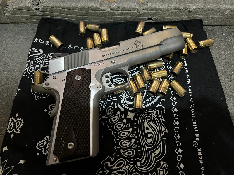

Just bought a used Garrison 45ACP PX9420S, went to the range and was very disappointed that it jammed 3 times within 100 rounds.
Any advice before I take it apart for cleaning and inspection?
Seems to jam on the 2nd round.
