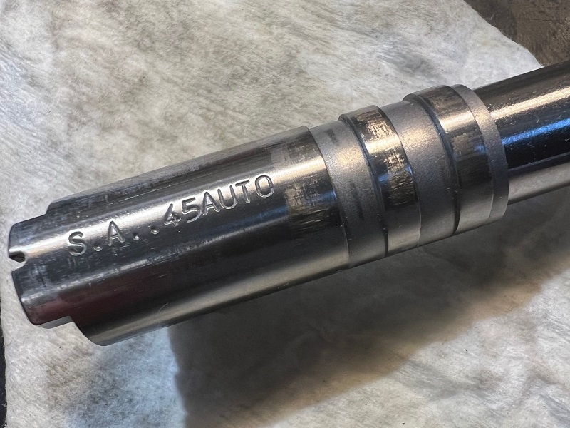

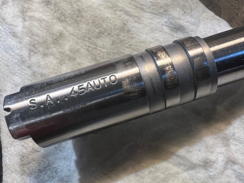

While I was cleaning the gun for the first time I noticed these marks on the barrel.
Is this normal wear? (see pics)View attachment 52633
looks normal.....the former owner may not have given it enough lube however.
i lube the barrel like you see where it says 45 auto.?? the hood area, all around and under that, and those "cut outs" all around those, as well as inside the slide to the corresponding areas.
that's just me though. others may disagree.
you just do not want "galling", deep scratches basically speaking
Thank you all for responding. While I'm waiting for the new mags I'll clean and inspect the gun. Already bought better quality ammo.
