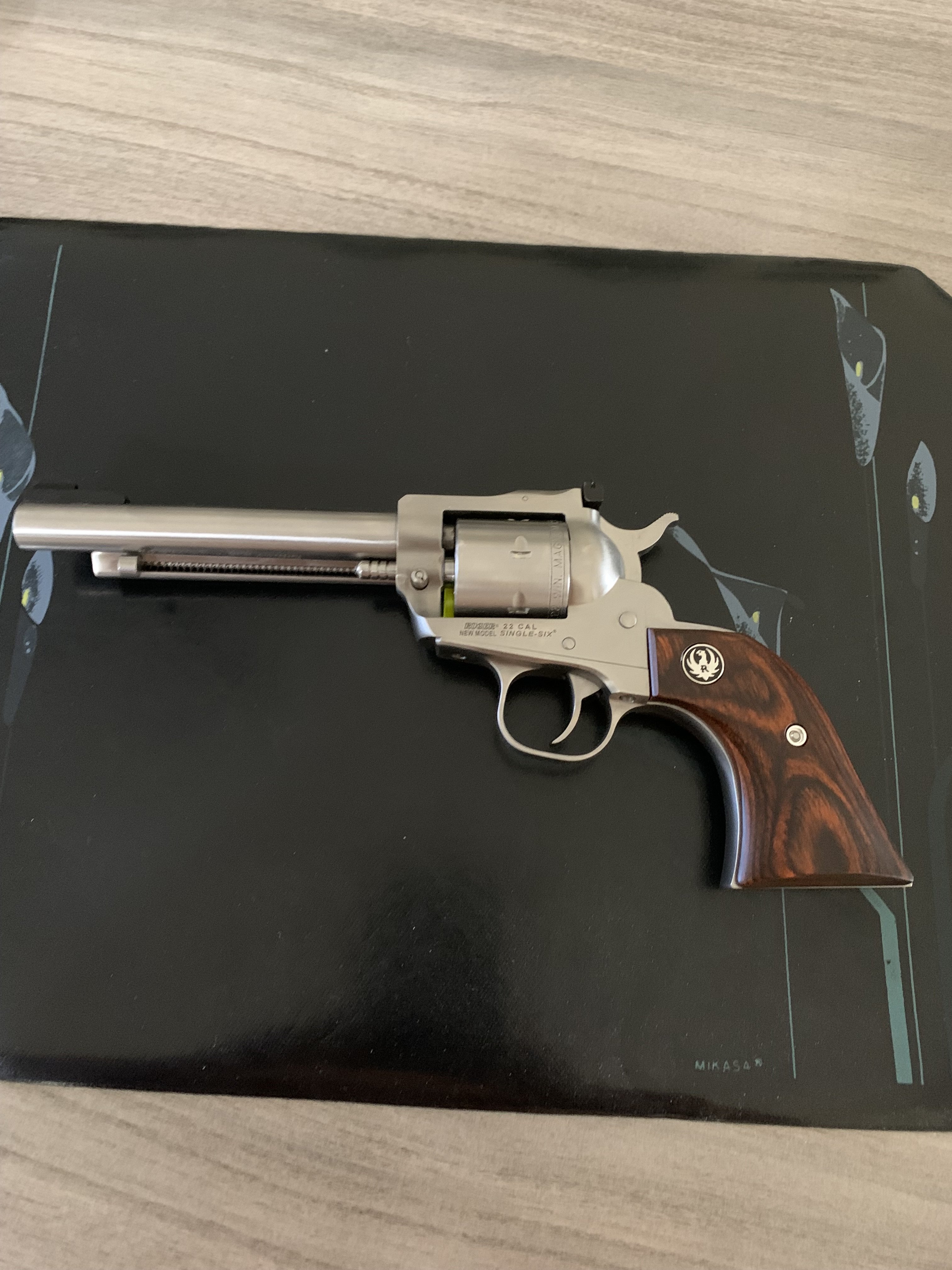

Well i went and looked at it this morning and it did nothing for me. I did a complete 360 and purchased a stainless Ruger Single Six! Really it's a birthday present to myself. Had one years ago and wish i never got rid of it.

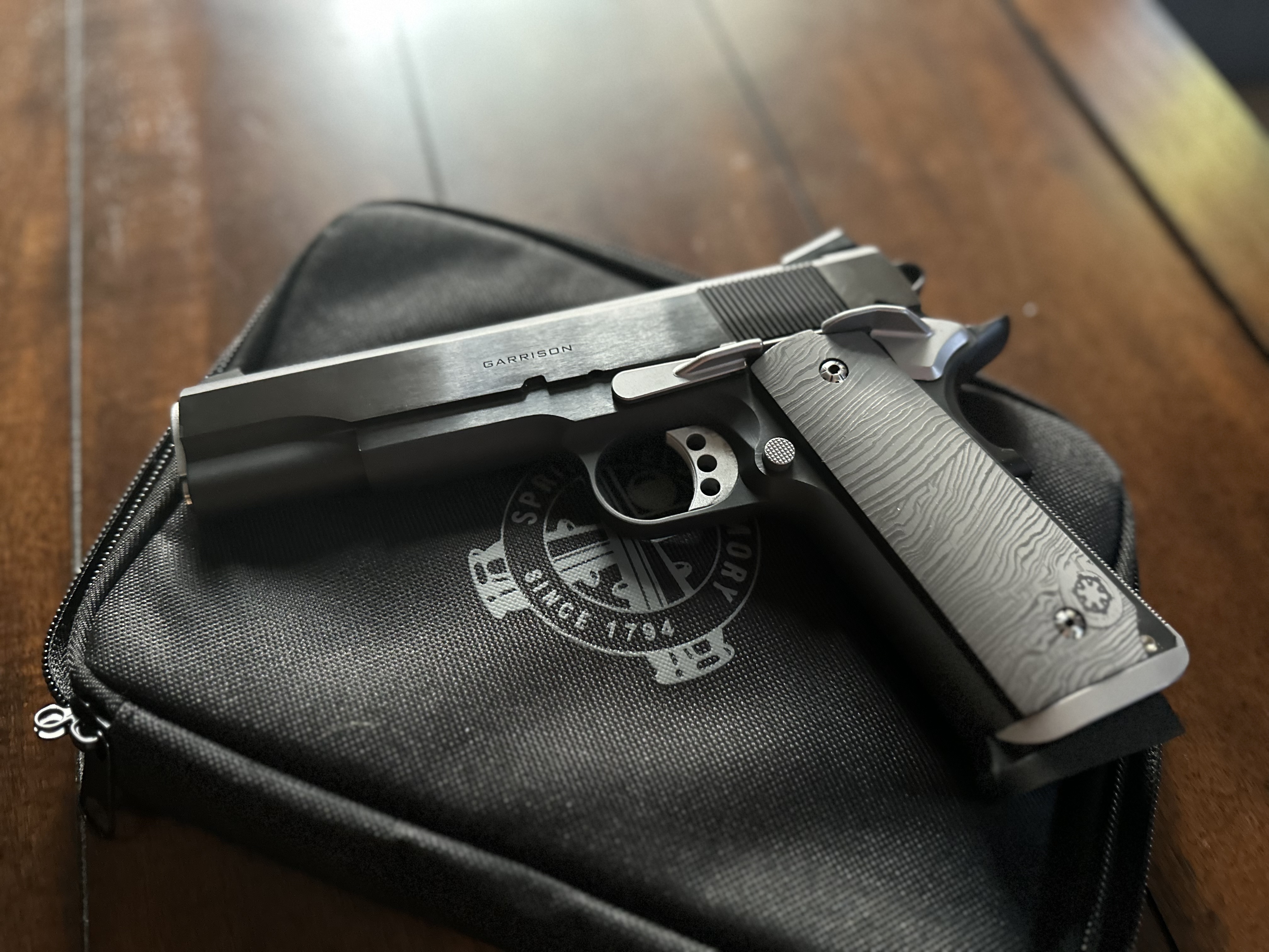

I have a blued 9mm Garrison and it works just fine other than a few hiccups on its maiden voyage the day I picked it up but that was due to an abundance of factory travel snot and an out of spec round issue. I cleaned all the factory slime out, properly oiled it, replaced the weak #9 factory recoil spring with a #12 and did a few cosmetic mods and it went through 200 rounds of 115 and 124 grain with zero problems.

nutmedge that is really nice. Did it come with an extra .22 mag cylinder? This model is on my bucket list!
Yes it did! I haven't shot the magnum yet. This was a brand new pistol so happy I didn't have any new gun issues
