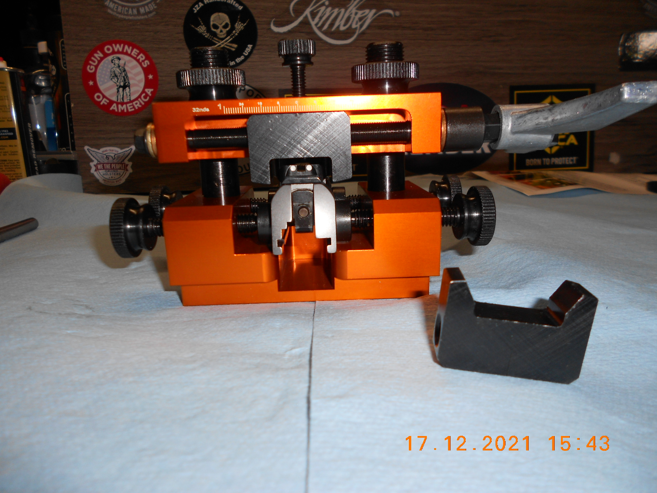

this Lyman sight tool comes with a straight sight pusher and an angled pusher, which will be in the pictures, plus the crank handle.
here is a pic, of the rear sight set up, of the rear sight of a 1911. you will see the straight pusher over the rear sight, and the angled pusher on the bench..and the crank handle attached, which is removable.

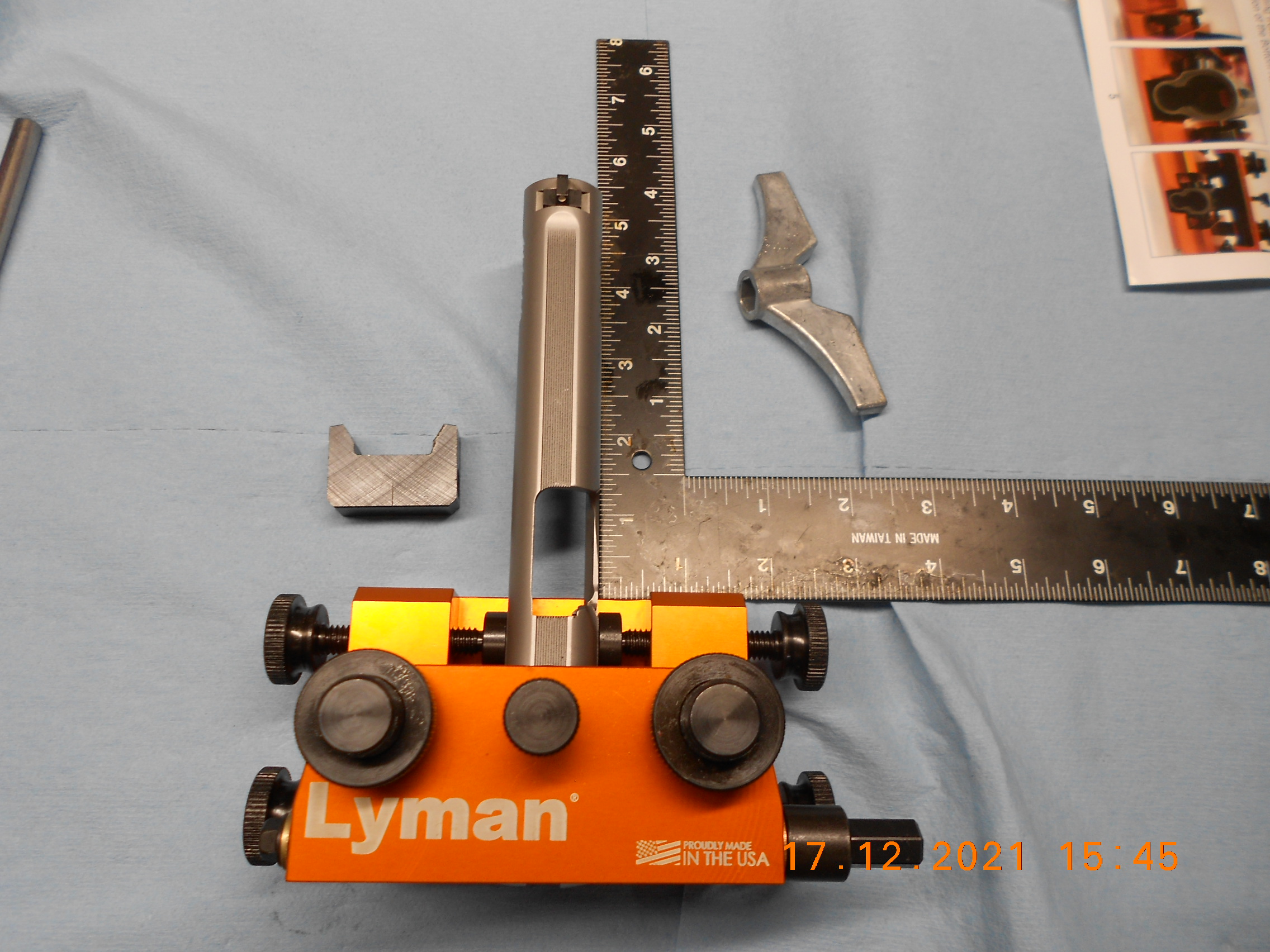

the instructions say to tighten all the adjustment thumb screws "FINGER TIGHT"...
and in this first picture, you can see how careful alignment to the tool for a 1911 is super important, as it just barely sits on the tool, when you need to install/remove the rear sight.
here you will see how a 1911 fits into the cut out at the bottom, and you see that top thumb screw, in the middle of the 2 larger ones? that has 2 faces to it. one for a 1911 slide (rounded) and one for a flat slide, like for say a Glock. you might just barely see thru the pusher, the "rounded" head for a 1911..

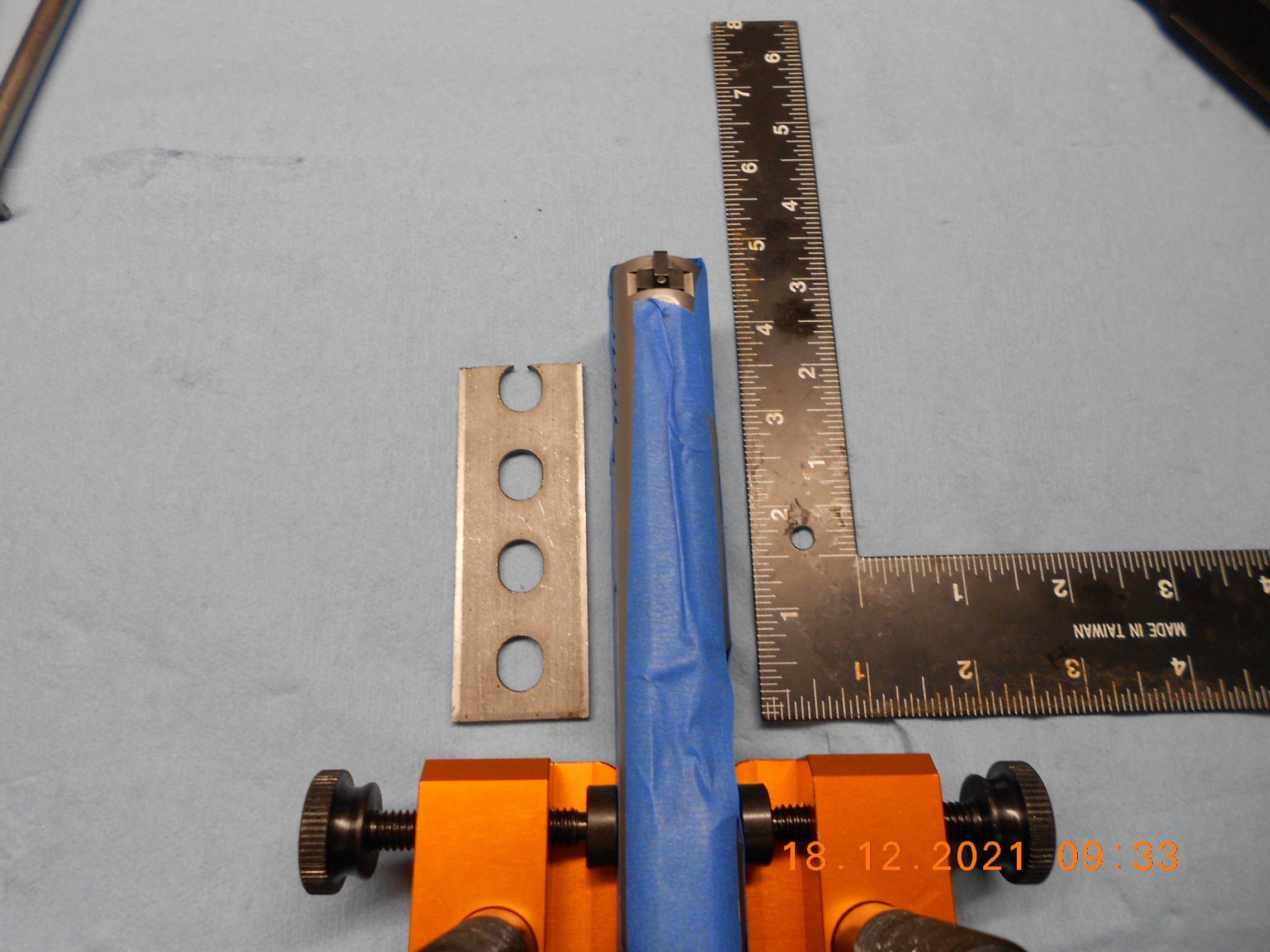

a carpenters "square"...i need to make sure the slide is perfectly straight in the tool, so as to not bend the slide....they do not tell you this in the rather great instruction booklet. but as i was trying to make the slide perfectly straight, it was impossible, until i looked at my back wall, saw the "square" and tried it....and it works.
as i mentioned above, a 1911 slide barely fits on the tool, with out falling into that cut out, where you would put the front of a 1911 into for the front sight. so crucial alignment is achieved with that carpenter's square

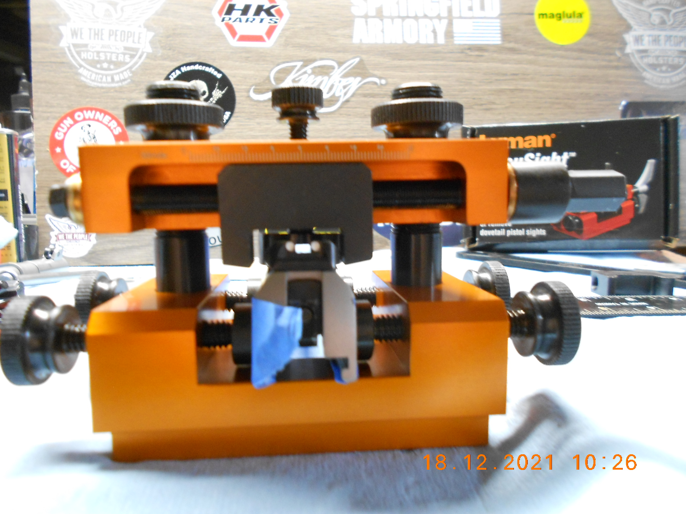

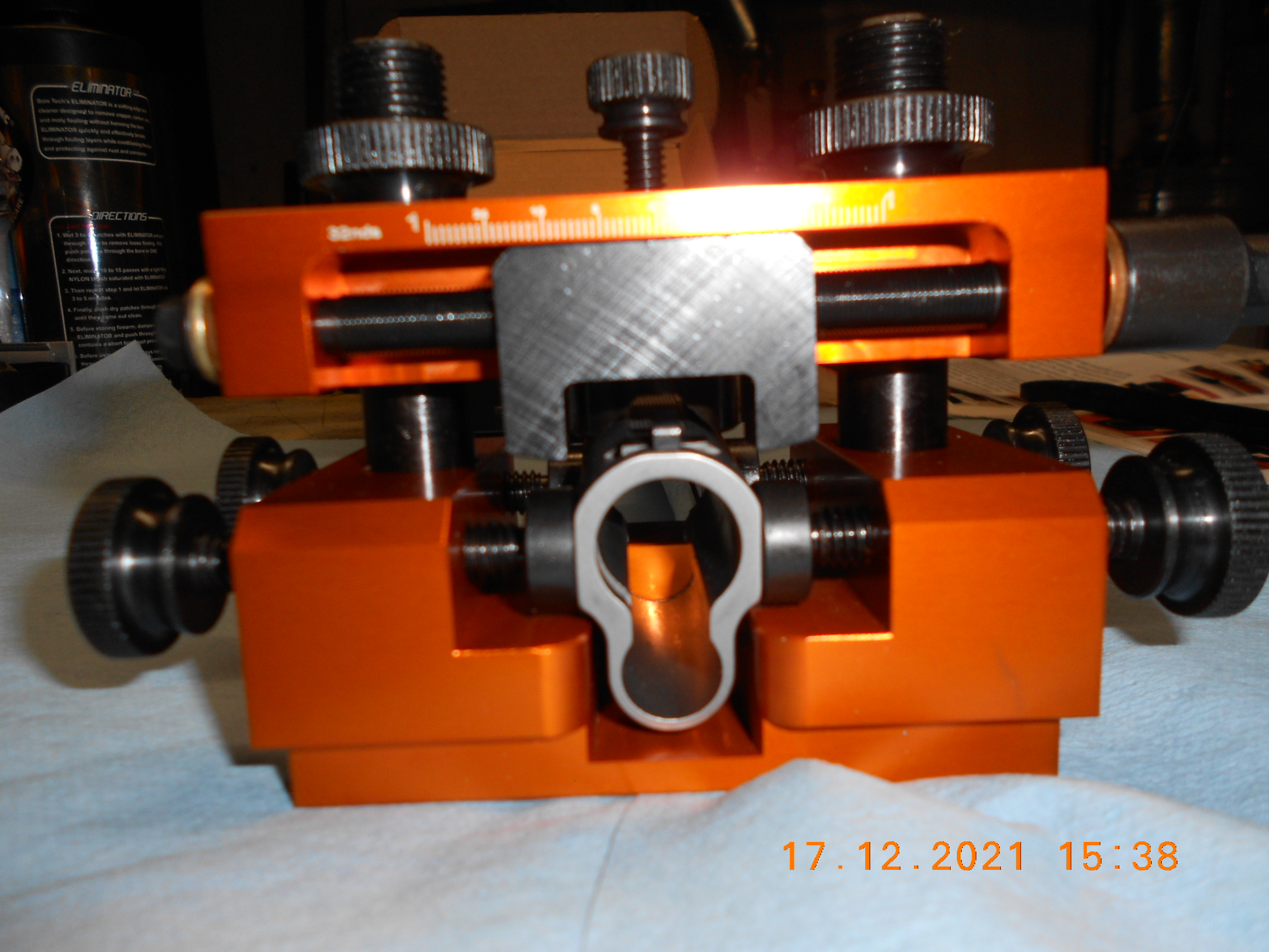

now an added tool that i have and think is important....

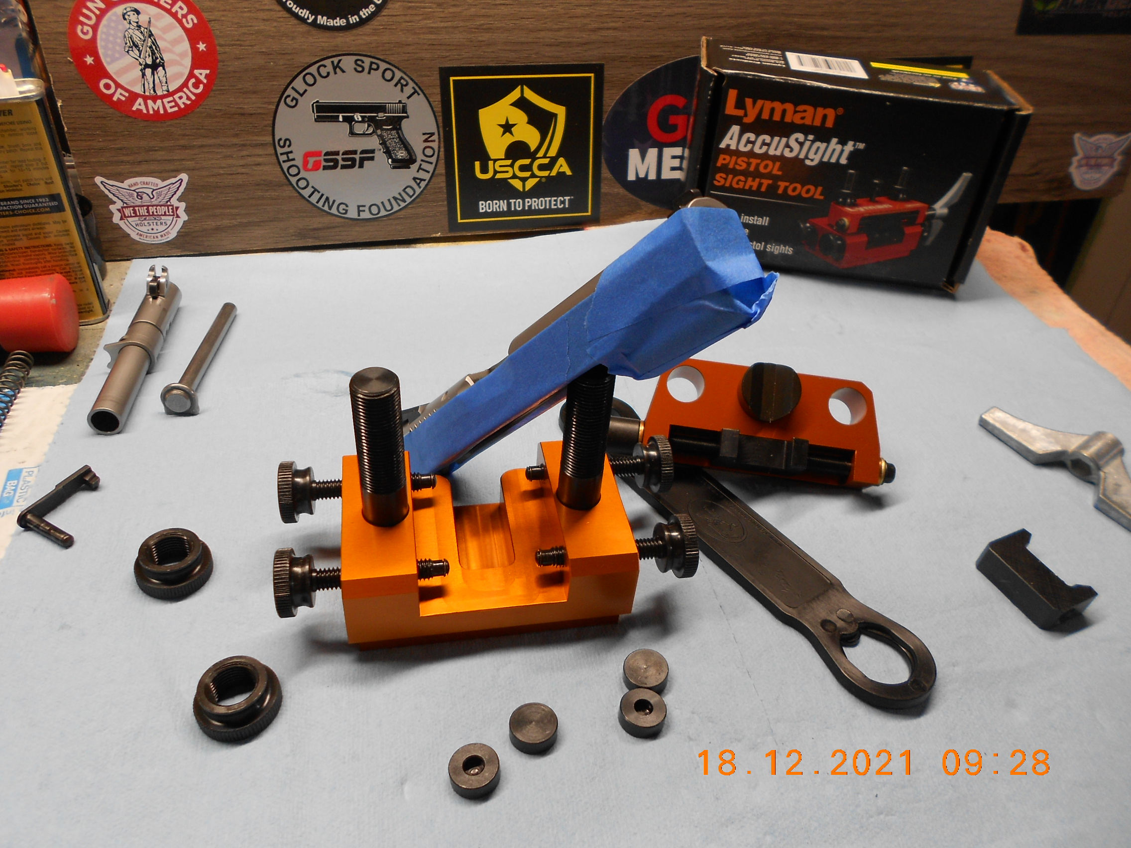

UPDATE: December 18th
ok, first and foremost,
in this picture, i said that when you put in a 1911 slide, you need to center it precisely. well the top piece comes off and turns 180 degrees' for the front sight or the rear sight, so my bad. when i inserted my 1911 slide, i had it set up for the pictures for the front sight.......,so when you remove the top and turn it that 180 degrees' of course the rear of a 1911 slide has more support....a big DOH on my part.....but hey, it was my first day.....:rolleyes:

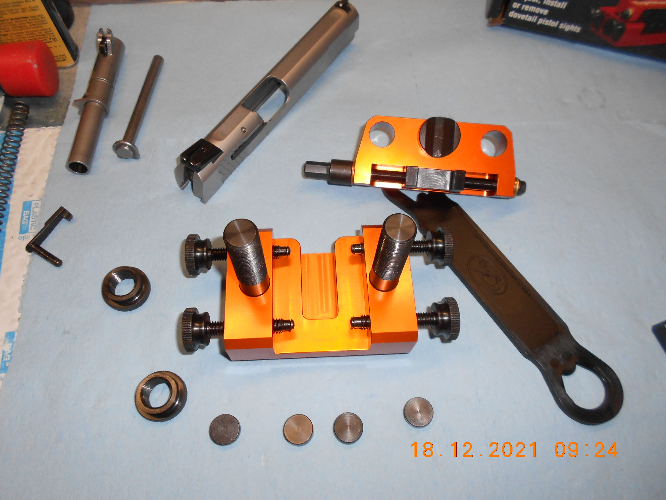

ok, here is an exploded view of the Lyman tool.

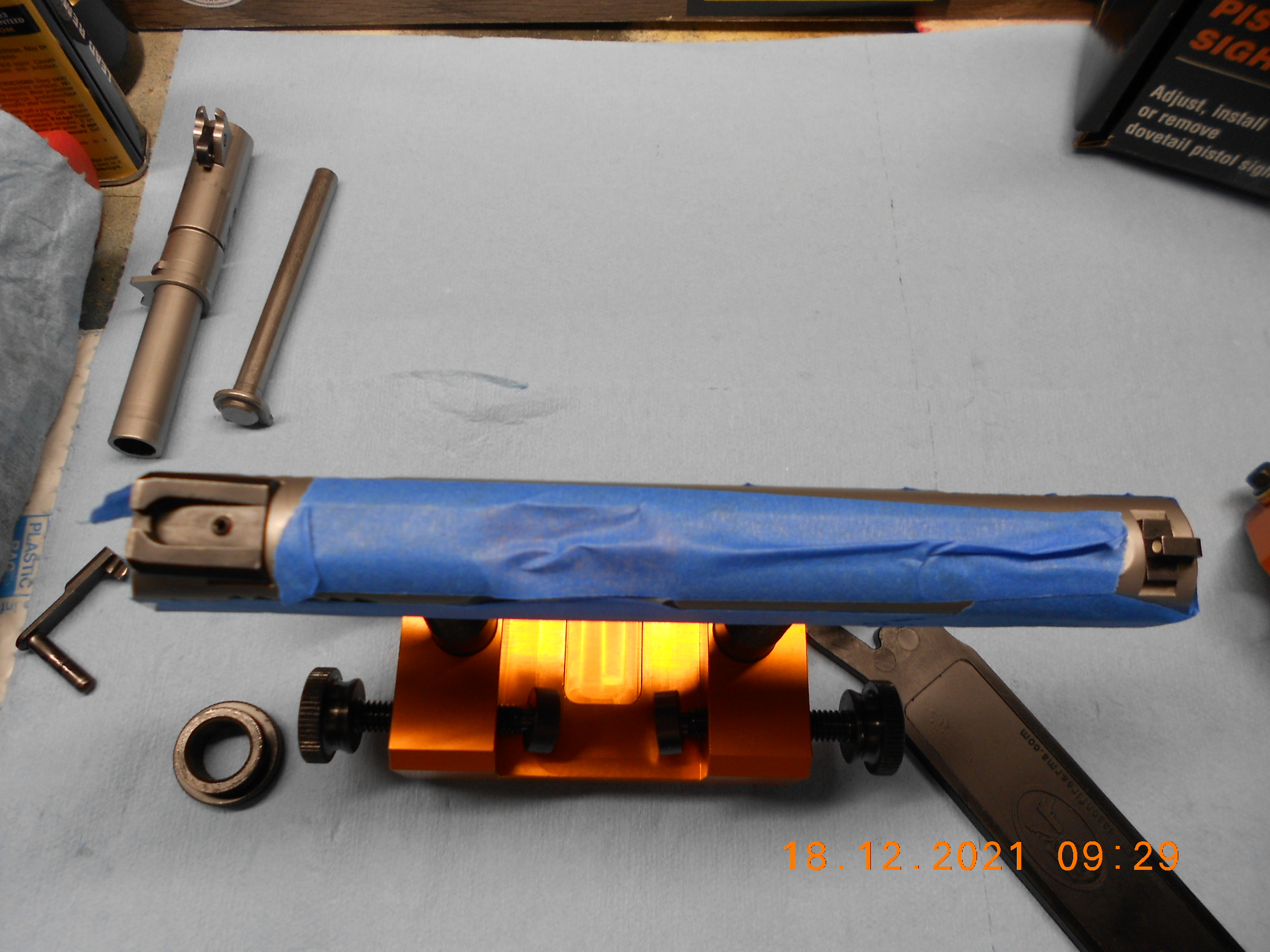

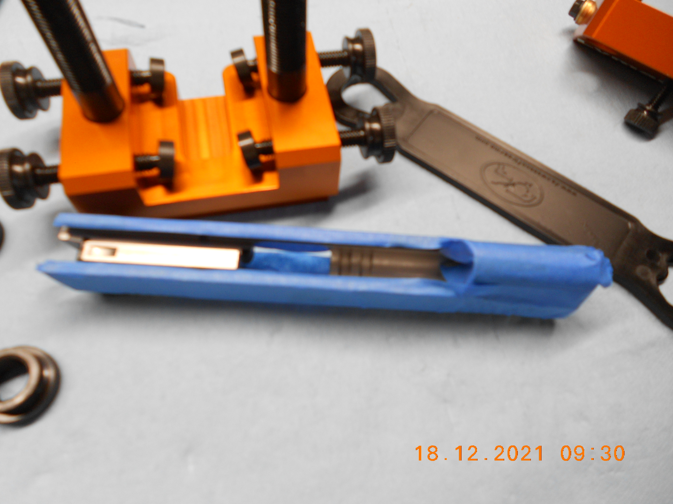

and now some of the taping you need to do, to avoid scratching the slide.
in this picture, you will see the carpenters square and a muffler hanger, which by the way i checked it out, and it is as straight as an arrow, and easier to use then the square. but to be safe, i still backed up my adjustments to the clamping screws.

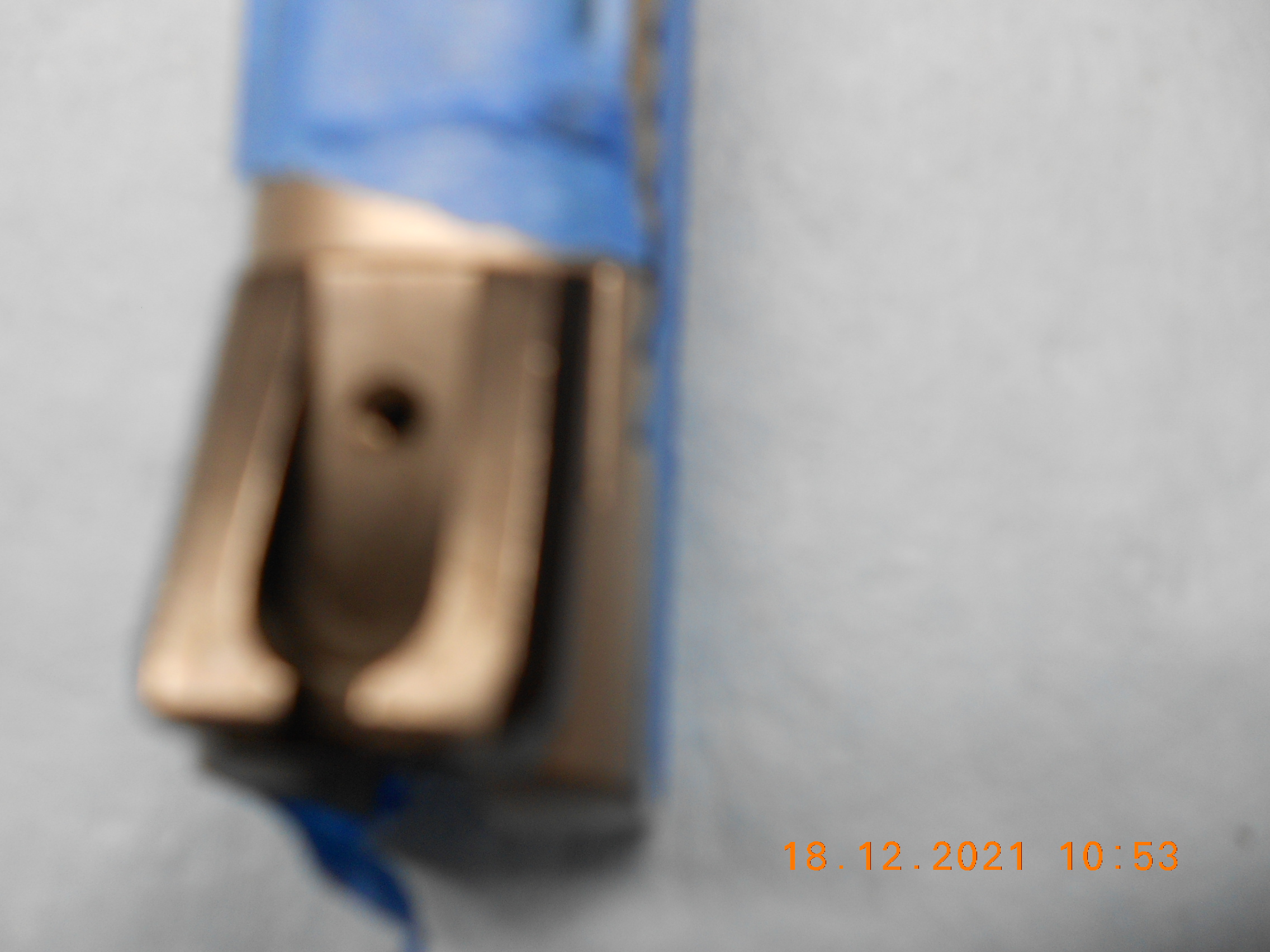

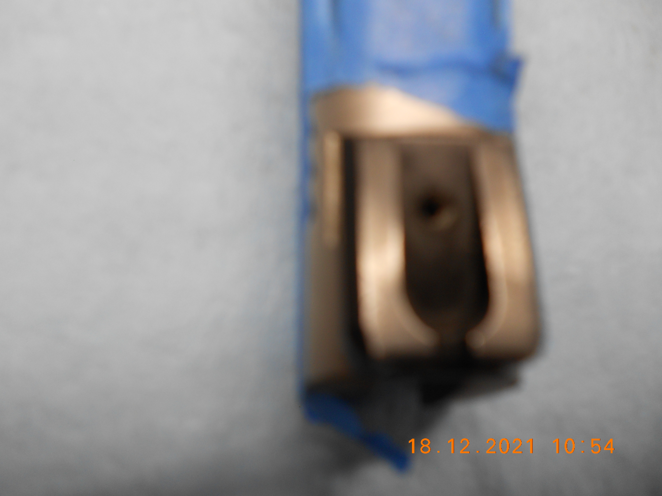

the very small sight set screw, which i used Blue Loctite to secure it
this next pick, shows the top middle thumb screw that'll adjust the height to the sight for proper pushing
the next 2 pics, are of the sight, after i pushed it to the right...and YES, you may have to "crank on it" to get it started. of course too, i used the Hoppes oil for lubing the pusher screw/block
these pics are lousy but the sight is now "more centered" to the target i was aiming at, on my wall.

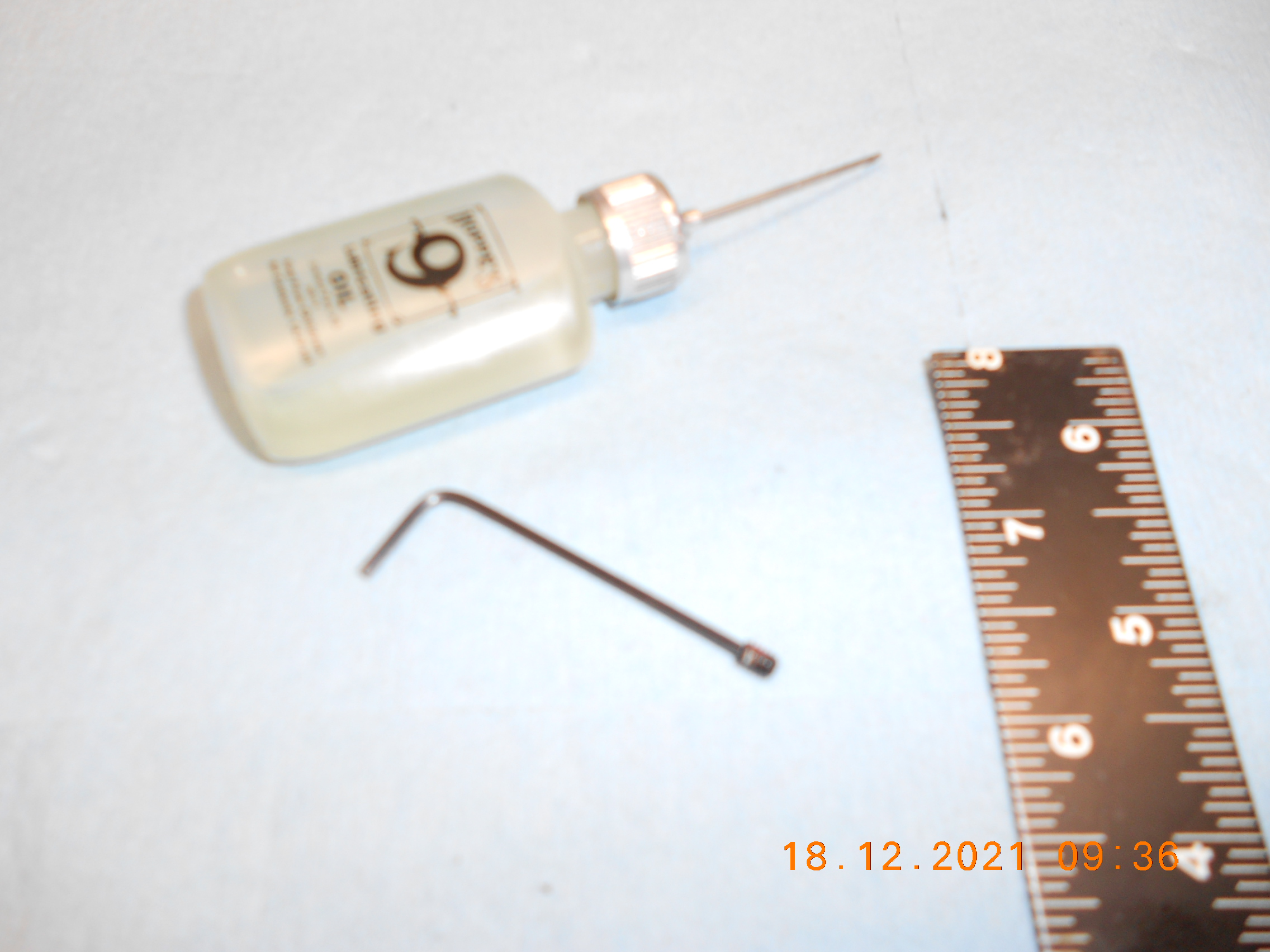

and YES, some "oil" on the VERY FINE THREADS on that pusher screw...!!!!!
but i think the reason why the threads are fine rather than coarse, is the infinite adjustments to the position of the sight.
