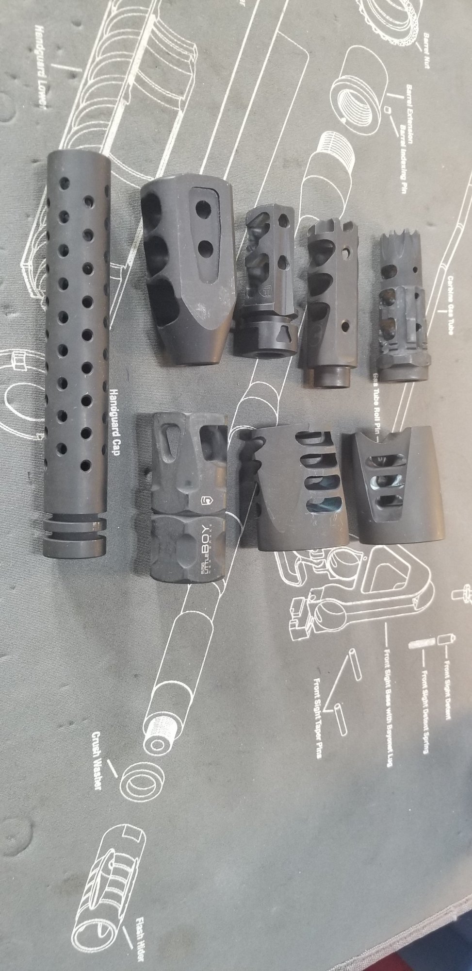

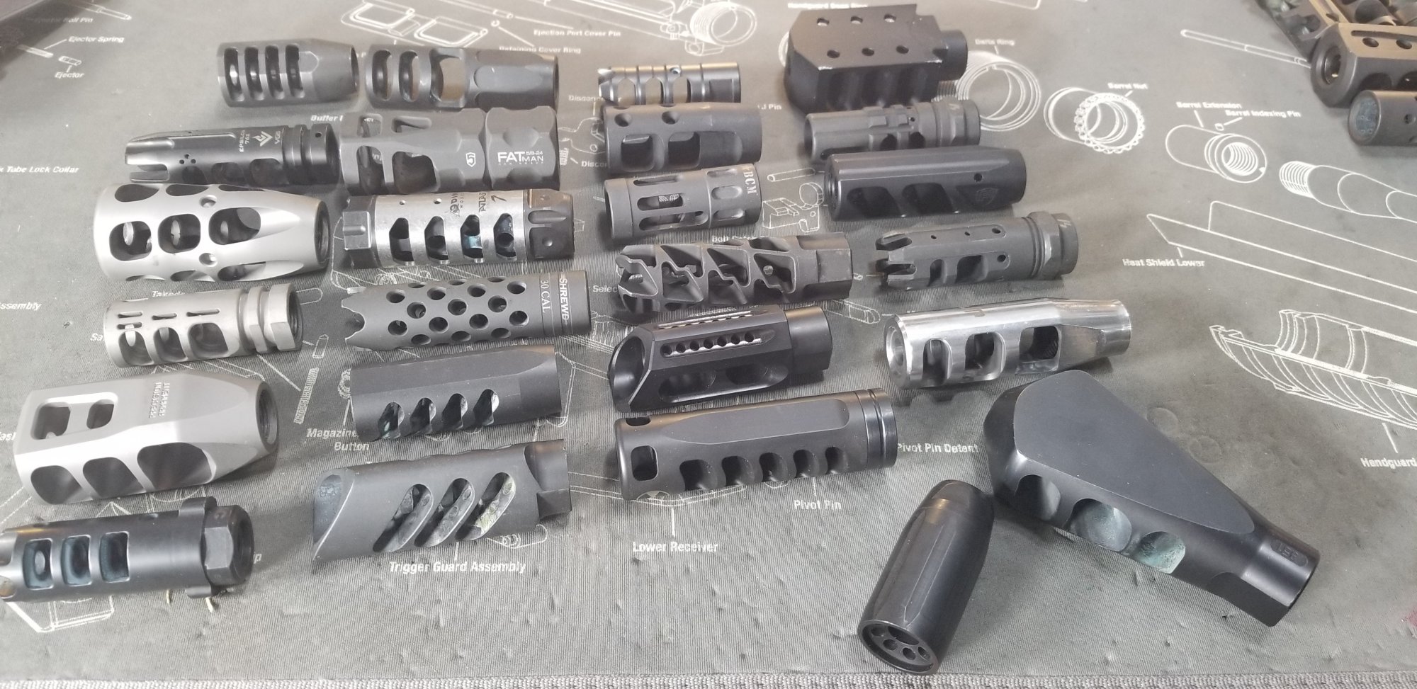

To each is own when it comes to these little known devices. What am I looking for. This will be a discussion on device share about what works for bore and barrel length. Should I just want a flash hider or more. I have bought many brands like, Phase5, Strike Industries, JP, Yankee Hill, Precision Armament, VG, BCM, Ultradyne, Seekins, Lantec and the list goes on. How much noise can you take? The top pic is 30 cal variants and the bottom is my 22 cal.
