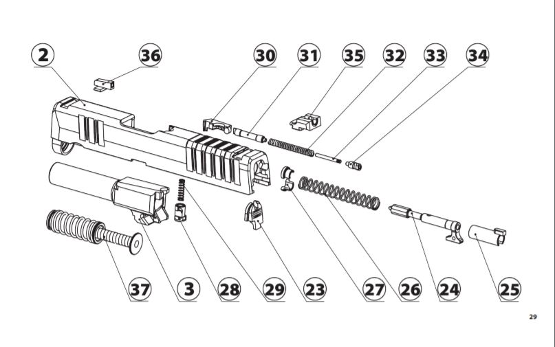

Can you be a little more specific on which piece you're referring to?
Hi @Ramrod21961, welcome to the forum. Part #25 is part of the Striker group and is the Striker guide. The Striker group parts #24,25,26,& 27, all slide into the back of the slide and are held in place by the Striker Locking Plate. I have the Hellcat non OSP version, and when shaken side to side I can hear minimum rattle in the front which seems to be either the slide itself or the barrel. With the slide locked back, side to side will cause the barrel to rattle more pronounced.
I don't find this to be abnormal, and have fired over a hundred rounds from it without a problem. If this concerns you, I'd recommend giving SA Customer Support a call, or take it to a local gunsmith for inspection, who may charge you (or perhaps not if he/she is nice), and address your concern.
It's normal. Are you sure it isn't the Striker rattle? Do you only hear it when it's unloaded? You can always get that part from LakeLine for $15.00 and see if it stops. If nothing else it is stronger built.
