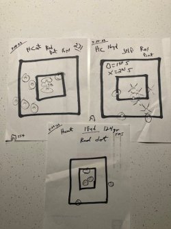

Another update. I finally got around to remounting my hex wasp red dot and shot it again after lining up the dot and putting it right on top of the front sight like it should be. Shot at 16 and 18 yards, in the wind and threatening snow, and managed to keep them all pretty close. Tried three different loads and they all did ok. A49728E8-5002-45F4-8780-18895C701A5E.jpegThis is how it was supposed to be from the factory but unfortunately it wasn’t. This is the happiest I’ve been with this gun since buying it and I am now going to keep it and put it back in the carry rotation. It’s just too bad all I had to do to get it corrected.
