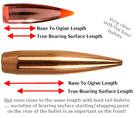

Bullets (designs) can have different bearing surface lengths eventhough bullet weights are the same.
This can have a measureable influence on velocity, and accuracy depending on the amount of bullet surface that interfaces with the bore twist rate in order to properly stabilize the bullet.
While one would think a manfacturer makes all barrels the same, slight/minuscule differences can occur during the manufacturing process resulting in/an individual barrel(s) preffering one bullet design vs. another.
Therefore, all barrels are individuals as are all rifles.
