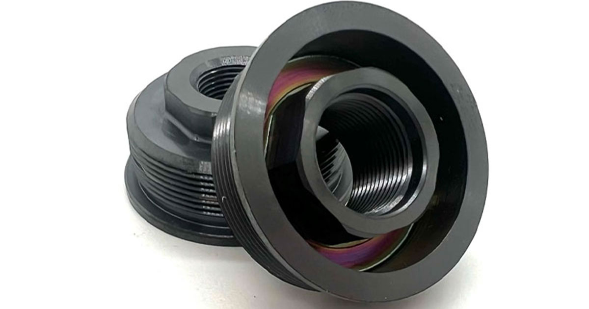

You can if you buy an aftermarket other brand thread adapter. Had to buy one for my .22.
Silencerco is all about upcharge for accessories. Buy a $30 thread adapter and mount away
Edit: you’ll prob need this Alpha direct thread mount
SilencerCo ALPHA DIRECT THREAD MOUNT 1/2″ x 28 (AC633)​

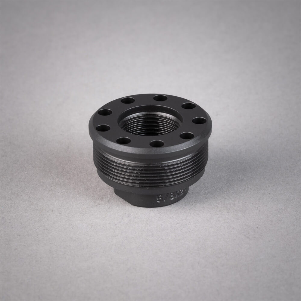

The Alpha Direct is the one it comes with and it is too wide for the threads too even meet. IDK, I could try again I guess.
Current mount doesn’t fit because the suppressor comes with a 5/8x24 direct thread mount. That’s usually for .30 cal barrels. You need the 1/2x28 direct thread mount. They can be had for cheap. If you go with tri-lug, you’ll need a tri-lug muzzle device and a tri-lug adapter on the suppressor. More expensive and I’ve found the tri-lug adapters are hard to find right now for 9mm.
Thanks for all the answers guys. I finally figured it all out. I found the Alpha Direct thread mount at a local shop for $89 (the1/2×28 thread) and got her all mounted up. I also have the tri lug muzzle device and mount on order from Scheels but if I decide against that set up, I'll just return it and save $216.
