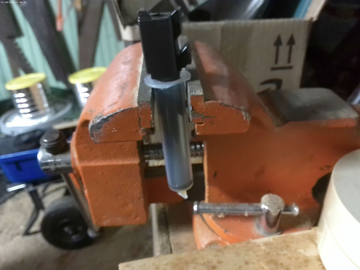

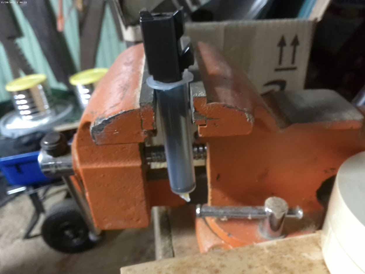

hey, i took my G-17 to the range earlier, and shot off 150 rounds of my reloads.
as i was cleaning the gun, i hold up the barrel to the light, and i can see some "leading" in the rifling.
i tried to swab it twice, onece with Sure shot lead remover, and once with Boar's Head(??) lead remover.
however, time is limited for me for cleaning today.

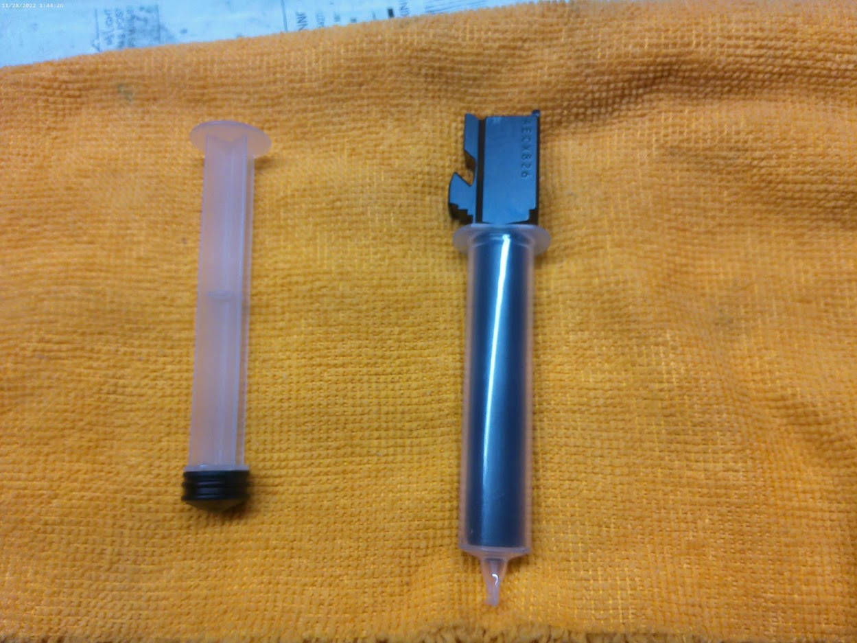

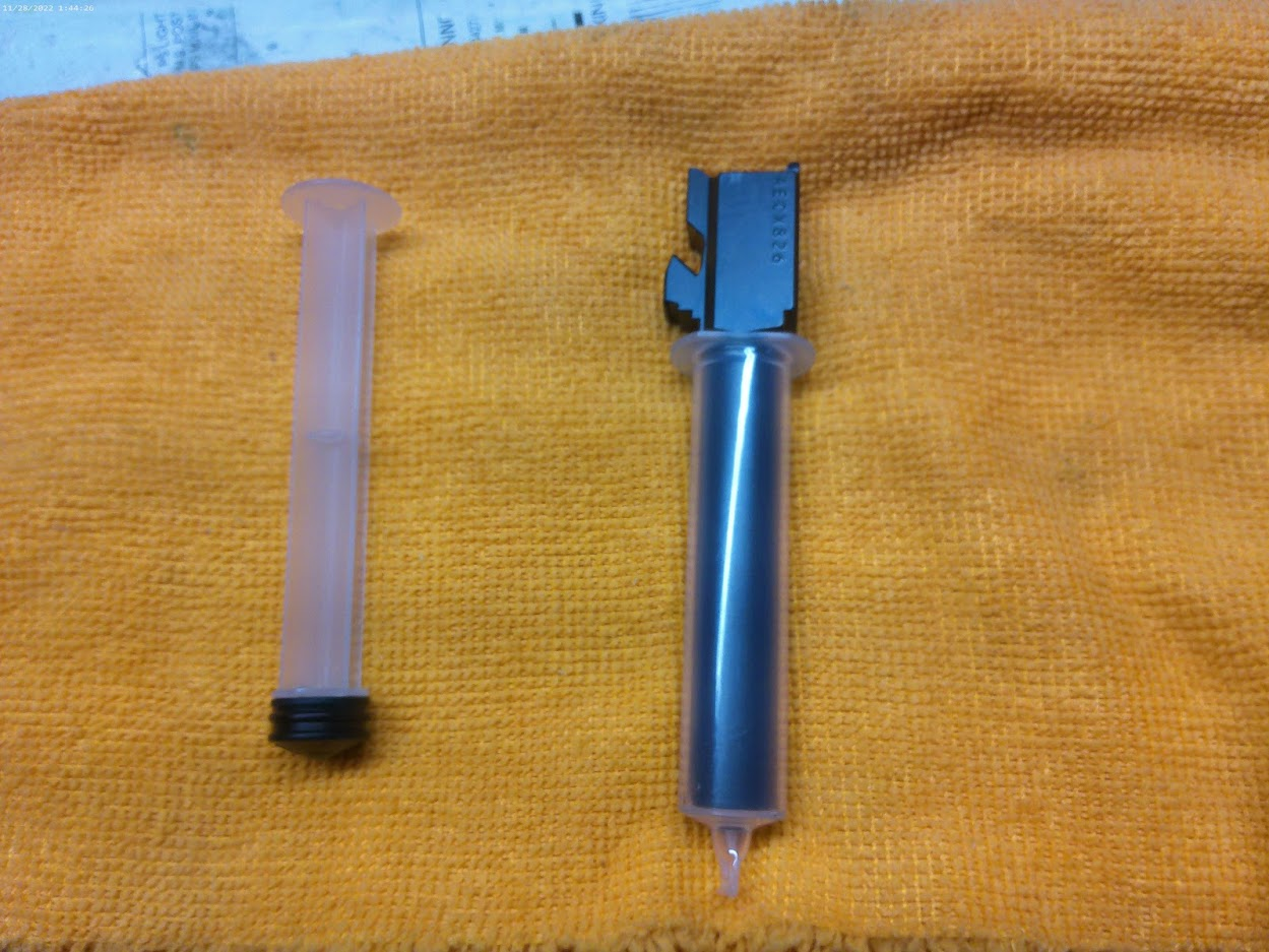

so, i came up with a way to "soak" the barrel with the lead remover and not be wasteful.

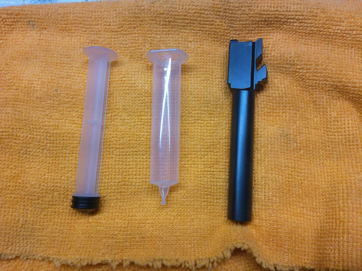

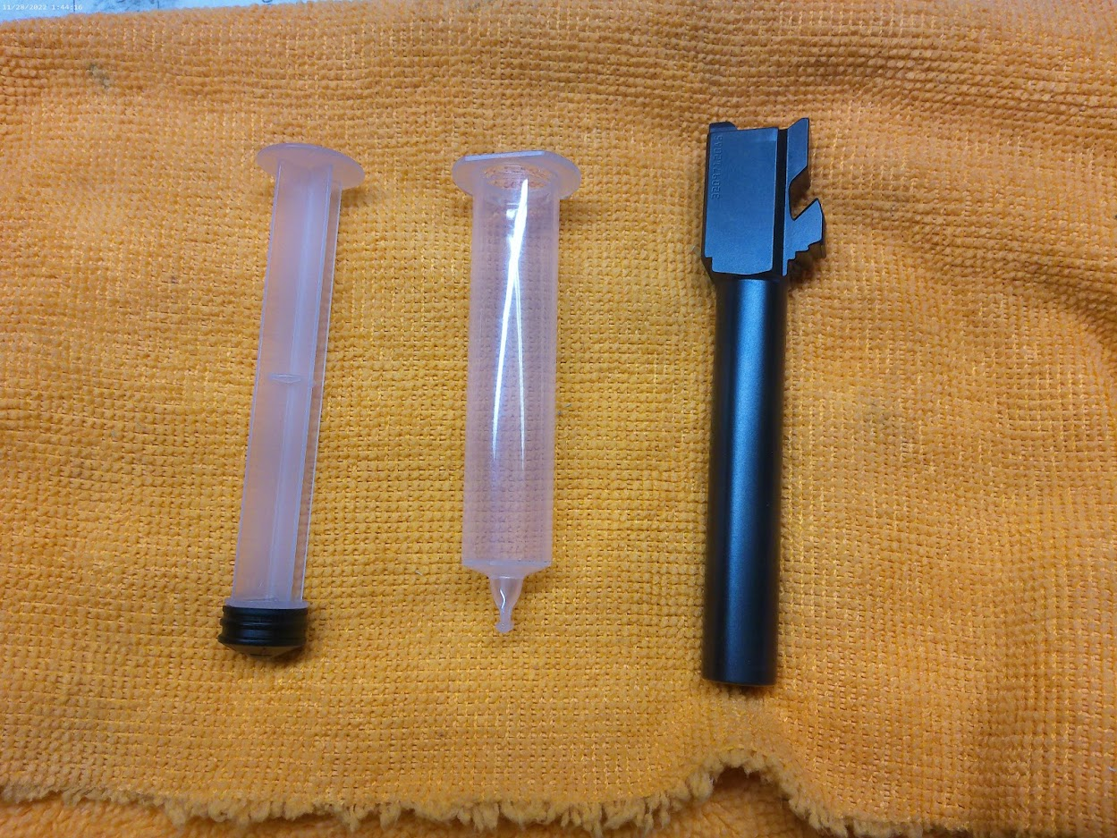

i bought a dozen or so, needle point plastic syringes from Amazon, as i use one and fill that with grease for pin point greasing some of my guns.
ok, so i cut off the tip (you really do not have to)
then i used my heat gun to soften the tip, and a pair of needle nose pliers to hold the tip closed, until it cools.
then, drop in the barrel, and fill the barrel with the lead remover.
now, i have to use my vice to hole the device.
i can let it soak for as long as i need to, (today is the first time i am doing this), and run a brush thru it later.
