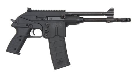

I have the Kel-Tec PLR-16 .223 pistol and the Kel-Tec Sub-2000 Gen 1 in 9mm and 40. All have shot well, have been problem free to date, and are fun to shoot at the range.
Image of PLR-16 below:
