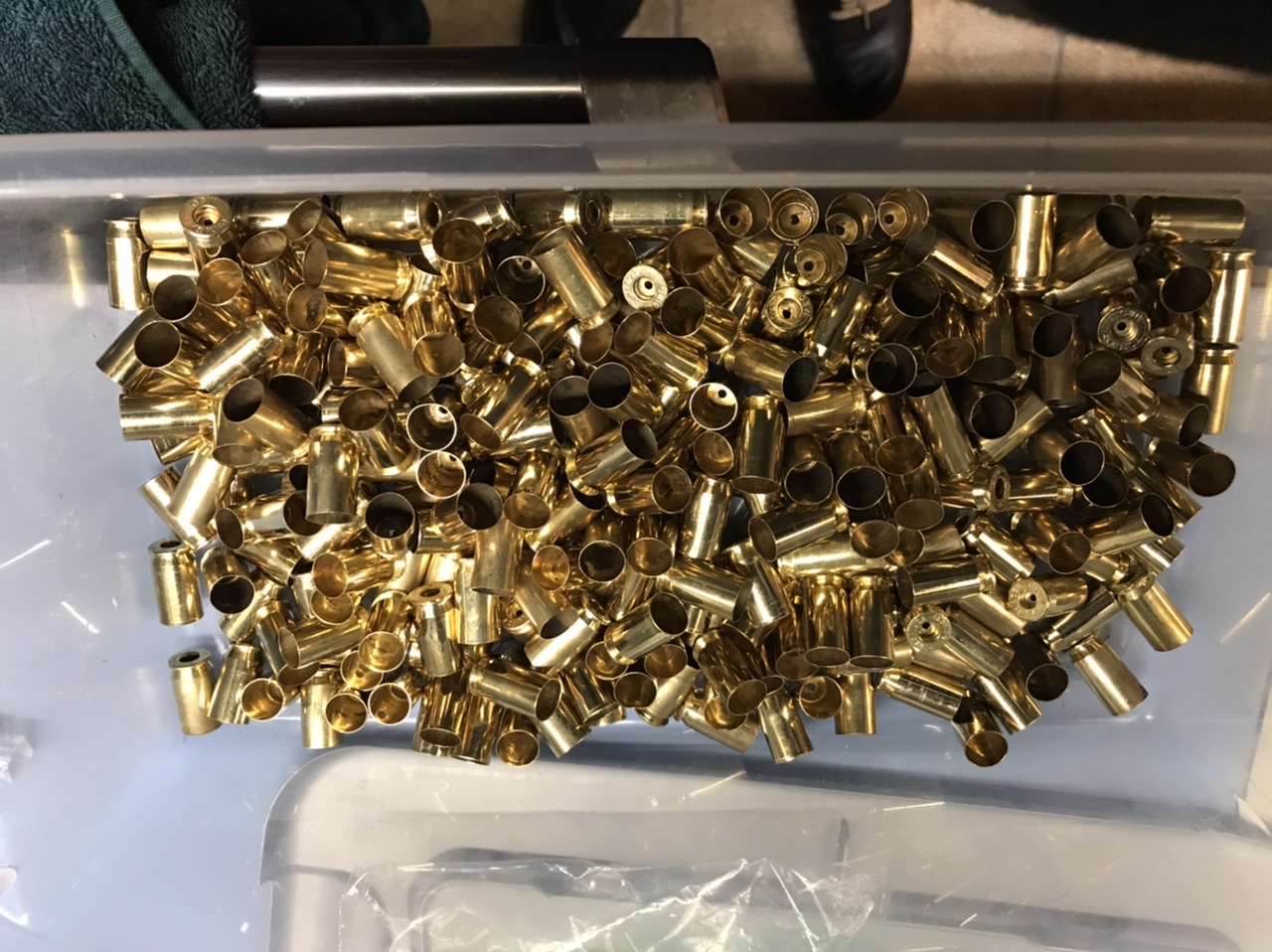

I’ve recently acquired an ultrasonic cleaner. This pic is a batch of .45 ACP including once fired and some range pickup. These results are simply amazing. I also did a batch of 9mm prior to this, but I didn’t put in the proper amount of cleaner, plus, I did them in a plastic basket, which absorbs 30% of the ultrasonic energy. Subsequent to that I picked up a stainless steel bucket that absorbs 8%.

I resized all of the 45 ACP cases from my last post. They were squeaky clean. Though I’m always impressed with the cleanliness of my pin tumbled brass, I still have to wear gloves when processing, and the gloves are always filthy when I’m done with a session.
I began to consider lubing the cases, as I felt their too clean status was making more work for my press...and me. I’m only two batches into this process, and I haven’t tried my .300 AAC BLK cases as yet.
The only reason I even picked up an ultrasonic cleaner was I could get a $350+ cleaner for $150. Grizzle.com has the Bald Eagle 6 L ultrasonic cleaner on clearance. This is the exact same model as the RCBS ultrasonic cleaner, except it’s not green, and comes with a plastic basket versus the stainless basket and bucket included in the RCBS version. Both are the same model as the iSonic P4862 which retails for $455, though it comes with the plastic basket that I have, as well as the stainless bucket that I bought from Amazon for $28.
For all the other, marvelous reasons to have an ultrasonic cleaner, I highly recommend the Bald Eagle version from grizzly.
