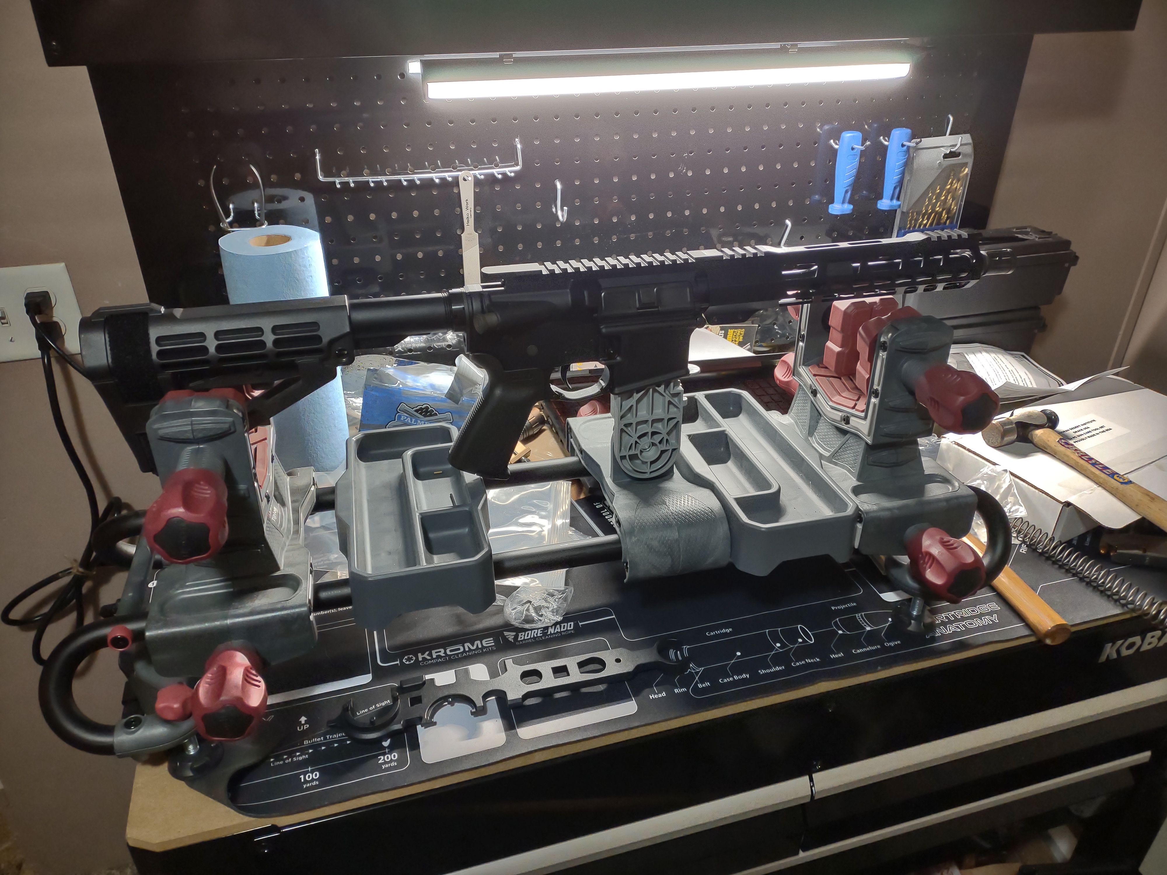

Oh, I’d pay the $200 ATF tax stamp and do a Short Barrel Rifle (SBR) Form 1 with the serial number of the lower you buy. That way you can legally mess with barrel length, overall length of the rifle, and brace/stock adaptations and alway be 100% legal on any length or config you choose. Forever. Ultimate tinker toy thats ATF approved.
Here is my Anderson SBR build that I did with ATF Form 1 on a separate suppressor build and a form 1 sbr.
I can walk you thru ATF form 1’s. Really simple. Lots of internet walk thru guides as well out there.
End result is you legally have to have them engraved to a certain depth with your name/ or trust name, city, state and other legal info after the Form 1 is Approved by the ATF. Pretty simple stuff.

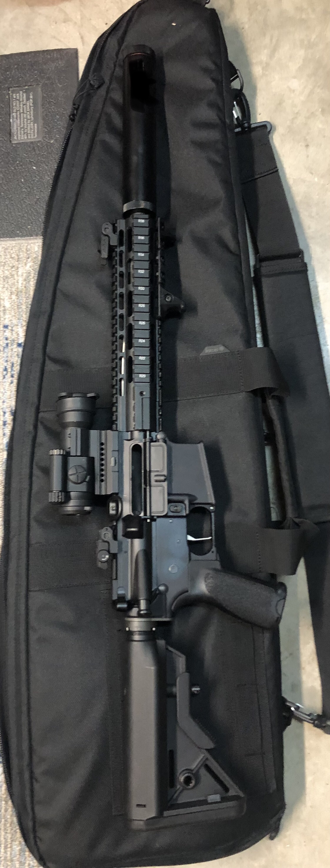

I have an Aero complete as a hobby gun that I purchased specifically to take to an "armorer's class" as a take-apart/put-together gun - https://www.thearmorylife.com/forum/threads/lets-see-your-ar-setups.258/page-5#post-4884 . We didn't gauge in that class because it wasn't a "real" "armorer's class," but it was taught by a very highly regarded (locally and nationally) gunsmith who holds an American Pistolsmiths Guild number and who is also a disciple of the late Pat Rogers. The gun passed inspection in that class, and by all empirical evidence, it seems to be in-spec.
That said, I also know from personal experience and from that of friends' that Aero's lowers as well as parts sometimes do vary quite a bit in terms of tolerances. I also purchased an additional phosphate BCG, and while it was fine overall, it and the one included in my AC-15 were configured differently in terms of the extractor insert/o-ring.

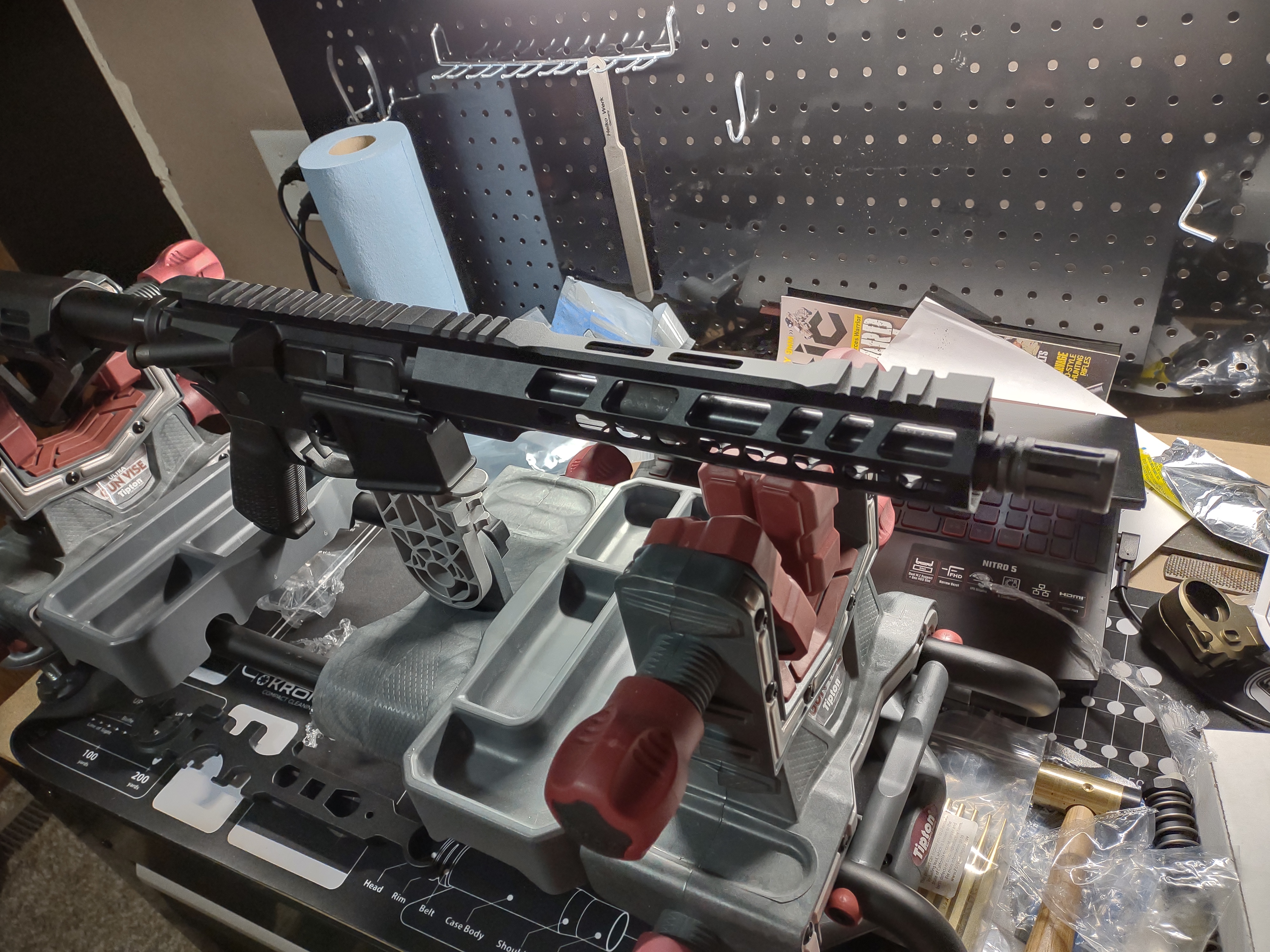

So I've got my lower and a lower parts kit on the way. Both purchased from palmetto state. Any tips on assembling it? Mind you, this is my first time so act like you're trying to explain it to a four year old
I was a little intimidated the first time. I actually bought one off the shelf first because I was afraid to try to build one. After messing with it for a little while I started buying stripped lowers and figuring it out. It is not difficult and there are a million videos on line that will show you exactly how to do it. You could spend a little more money on "Kits" which have most of the stuff you need or you can buy individual parts. Most likely whatever lower parts kit you buy you will end up changing a few things. Trigger, Buffer/tube, maybe you want an oversized or ambi safety or bolt release, etc.. I'd keep it simple for the first one. You can always easily swap those things out later.
I suggest buying a complete upper the first time too. I don't think building one is any more difficult than doing the lower, but messing with gas blocks and tubes and all that is a process all it's own. For the first one I would skip it and just buy a complete upper receiver. Several decent ones at affordable prices. Aero is a mid tier option, Bravo Company might be a little higher end, but also considerably more expensive. Many of those companies use the same barrels made by Faxon and others. A really affordable upper is Bear Creek Arsenal. They get mixed reviews on line and I certainly wouldn't rank them up there with high end stuff, but I have two of them, I paid under $300 for them and have ran the shite out of them with no issues. Accurate and reliable they are. My next one will likely be a BCM ( Bravo Company). As for lowers I totally agree with Hans. As long as it's in spec they are all about the same. You can get an Anderson stripped lower right now for about $50. I have two and they are both just fine. I also have a PSA stripped lower which is also fine.
You could rush out and buy a bunch of tools, but unless you plan on doing a bunch of them I wouldn't because you don't really need most of that stuff. You can do without a wrench for the Castle nut, , but that is the one thing I would buy if you can't borrow one from a friend, which is what I did. NC Star sells one for about $20. You will need a set of regular punches and I would suggest getting some roll pin punches too, but I built my first one without them. Punches are cheap and you can get them from Harbor Freight or Lowes or wherever. No need for anything fancy. I would also spend about $12 on a full set of T handle hex wrenches too. You can easily make your own armors bloack out of a scrap piece of wood. You definitely will want to use one when you're installing the trigger guard roll pins. All this stuff is explained in pretty good detail in most videos. I'd skip the vice blocks, again unless you plan on building several more. They are handy and I did buy one, but not until after I already built 3. I bought a Wheeler lower vice block for under $20. I also bought a small Wheeler screwdriver set for under $20, but you can find the tips you need in just about any cheap screw tip assortment set. And for ARs you rarely use a screwdriver.
Anyway, feel free to ask advice here while you are doing it. I did. These guys are great about it. And here is a pretty good tutorial for building a stripped lower.
