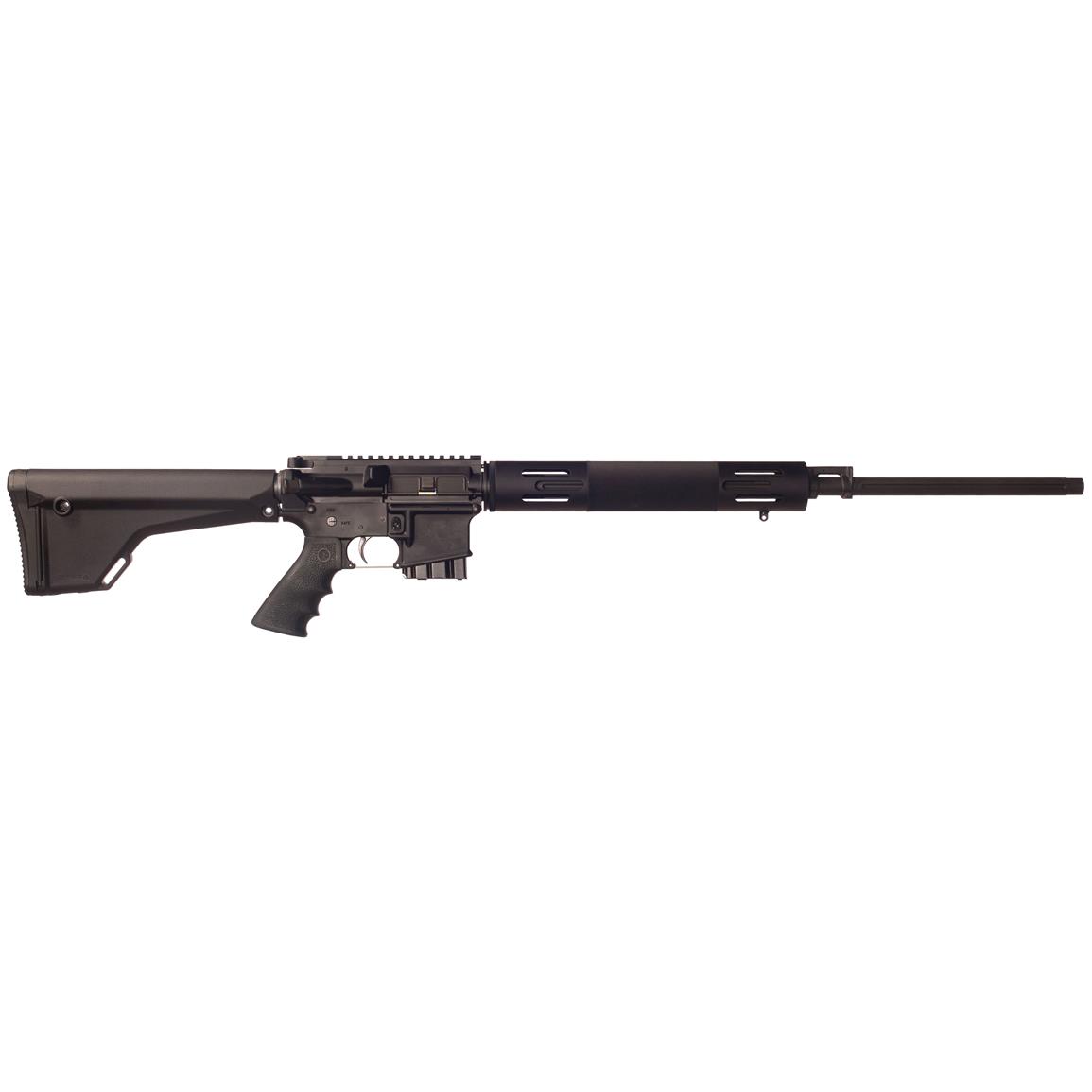

I bought a Varminter a year and a half ago. I had one years back was was amazingly precise. I wish I'd know about the steep drop in quality after Remington bought them bit it can't be helped. This one is just slightly better than my classic iron-sighted A2. Today it put together a nice 4moa group at 100 yards. Not 0.4, 4. So, I figure the barrel has to go as a first step toward precision. Are there any pitfalls to watch out for in doing a swap?
5.56? Are you just doing a barrel swap/change? No matter the caliber or cartridge making sure it's headspaced properly for sure! Know what the gas block journal size is so not having to buy another.
Might also want to go with an adjustable gas block. Depending on what caliber you go to it can take away a lot of problems.

If your front sight is pinned you might leave it and barrel nut on the barrel so it saves the front sight from being removed. You might need a barrel nut that is compatible with a handguard of your choice? Need answers, so we know where your going.
I've tried many different bullets and weights. No joy. The Varminter has a 24" fluted heavy bull barrel with no front sight. I have no idea what it has for a gas block or a barrel nut. My preference would be to stay with a heavy, 24" 5.56 and go for maximum precision.

The gas block is probably pinned (2) and journal is .750 or .875 being hbar, not bull. Have you tried 223 match ammo? If you get a Wylde chamber would be a good choice. 1/7 I think is overrated and a 1/8 is more perfect. An adjustable gas block is fine, but not necessary for 5.56. If you go low mass buffer(JP rifle) and low mass BCG then an adjustable gas block is needed for best performance. I have 1 setup that way and recoils like a 22lr, if you want to say a 22lr has any recoil!
Barrels; I’ve had great luck with Ranier barrels; the 5R rifling that most have is a great benefit. Pricy, but worth it.
Noveske also makes good barrels.
I think Shilen makes AR barrels…you could go with any of the high-end barrel makers, really (Lilja, et al).
I’d get a new bolt to go with it.
