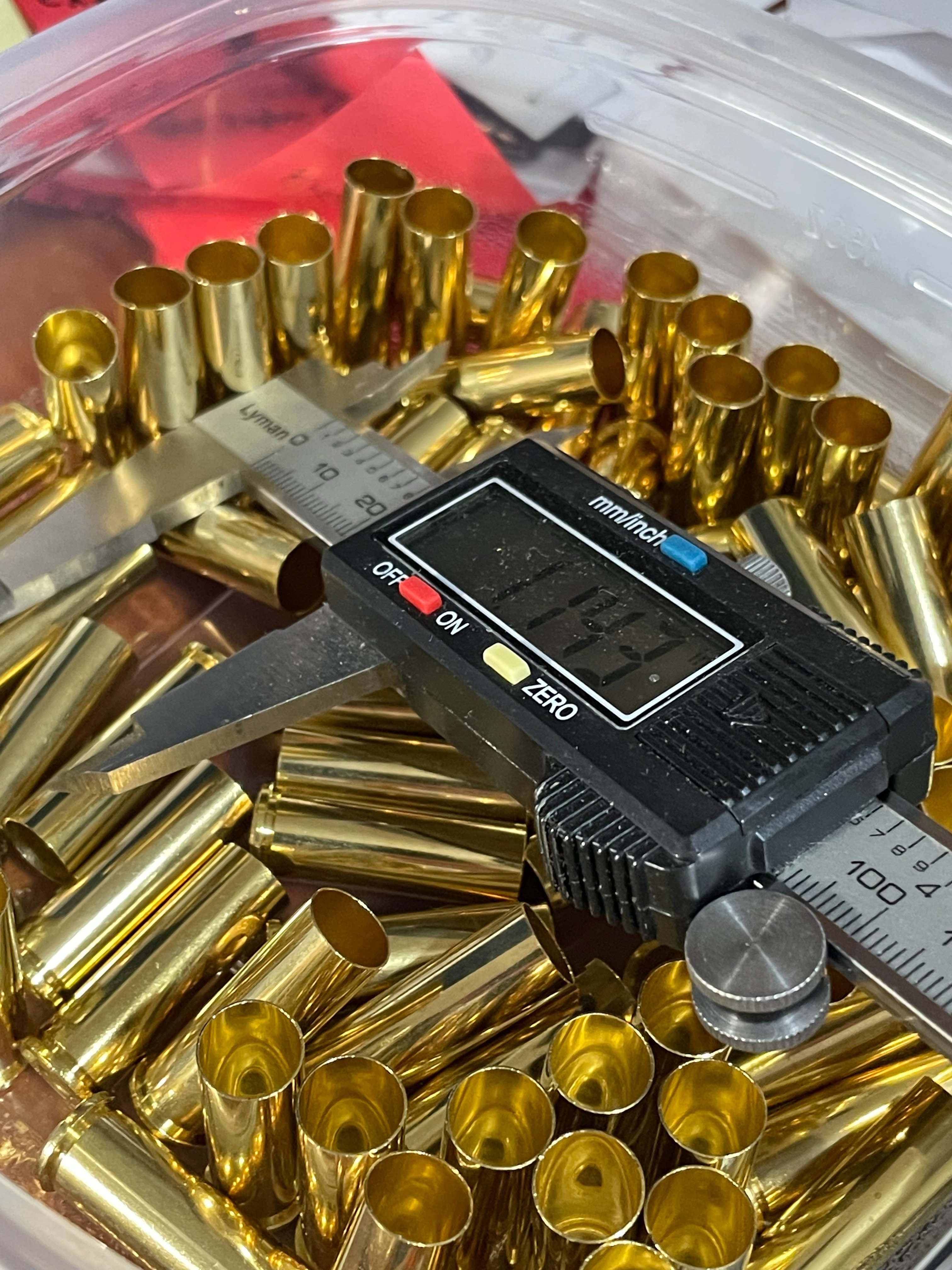

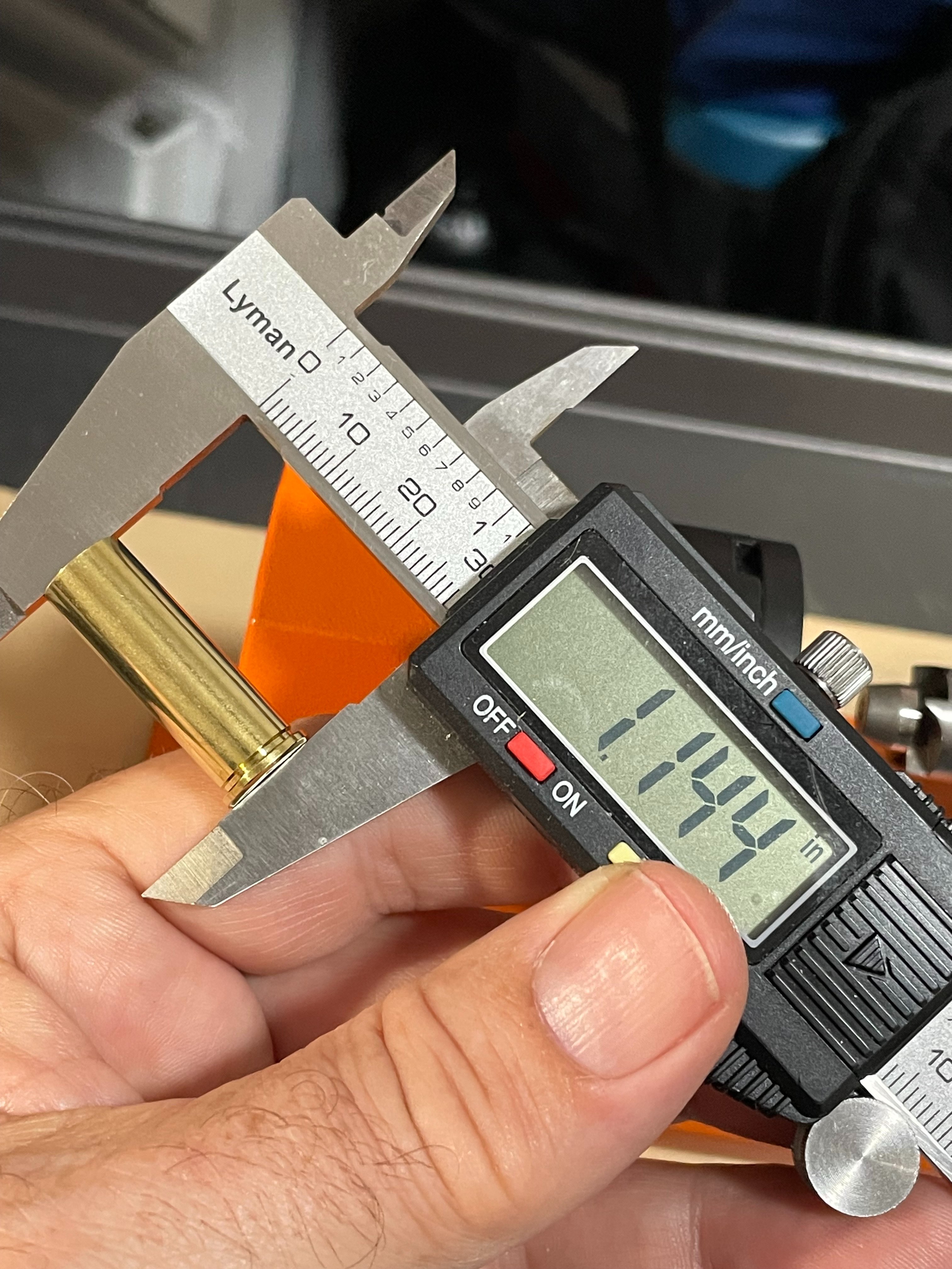

1) Measure each case to determine its initial "as is" length. New virgin brass cases are already sized to SAAMI spec, so they can go right from the bag / box into my calipers. If the cases are from once-fired factory ammo, they must be resized before taking initial measurement.

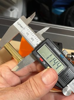

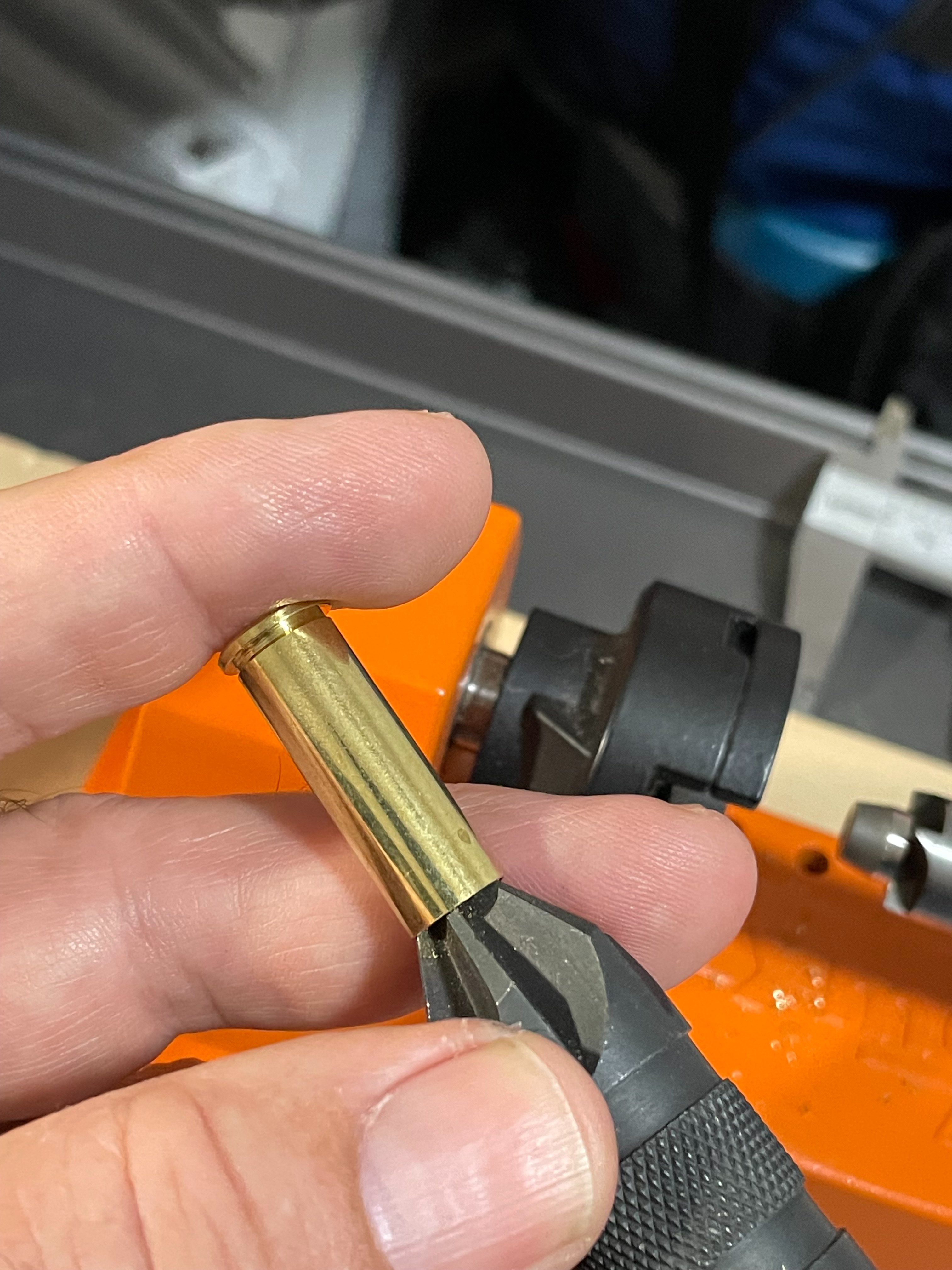

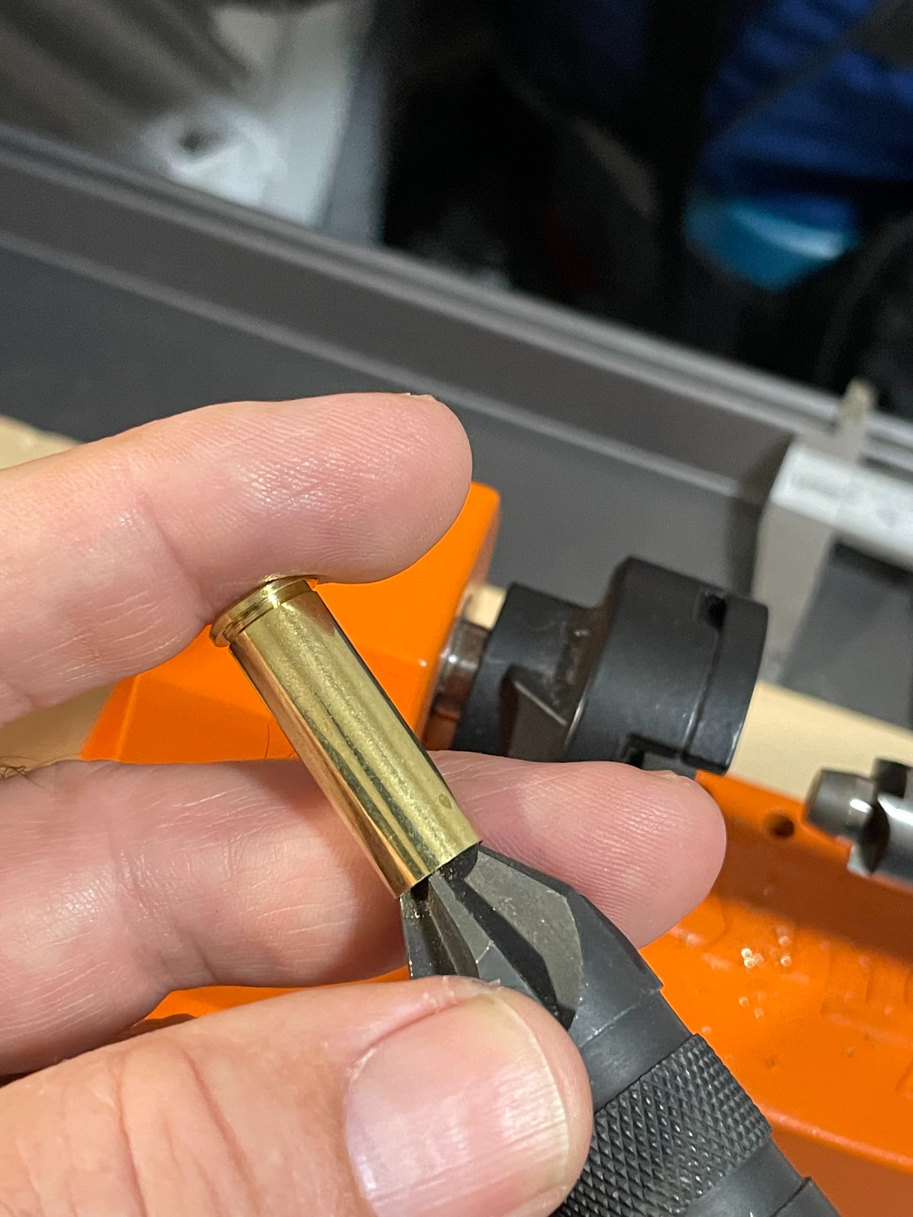

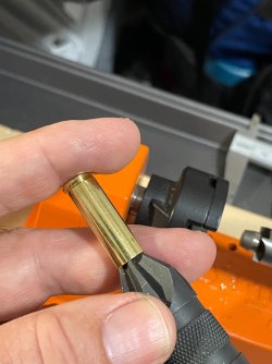

2) Cases which yield an initial measurement within my target window of 1.140" to 1.145" are simply lightly chamfered inside and outside the case mouth, and they're "done", ready to load. Cases which are below 1.140" in length are set aside for other usage.

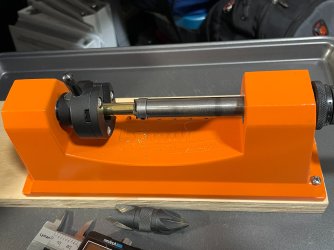

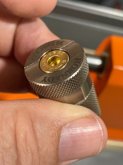

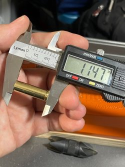

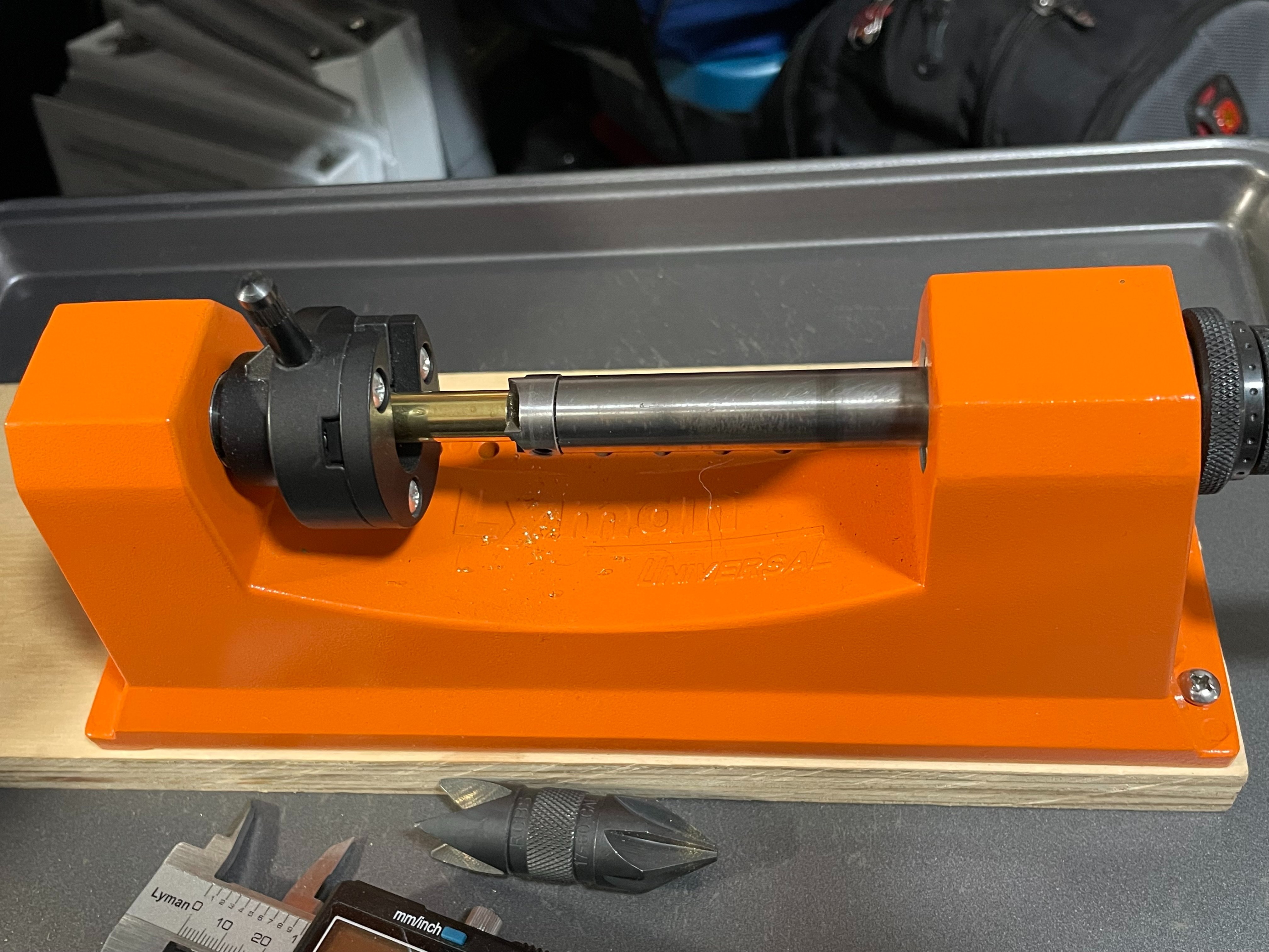

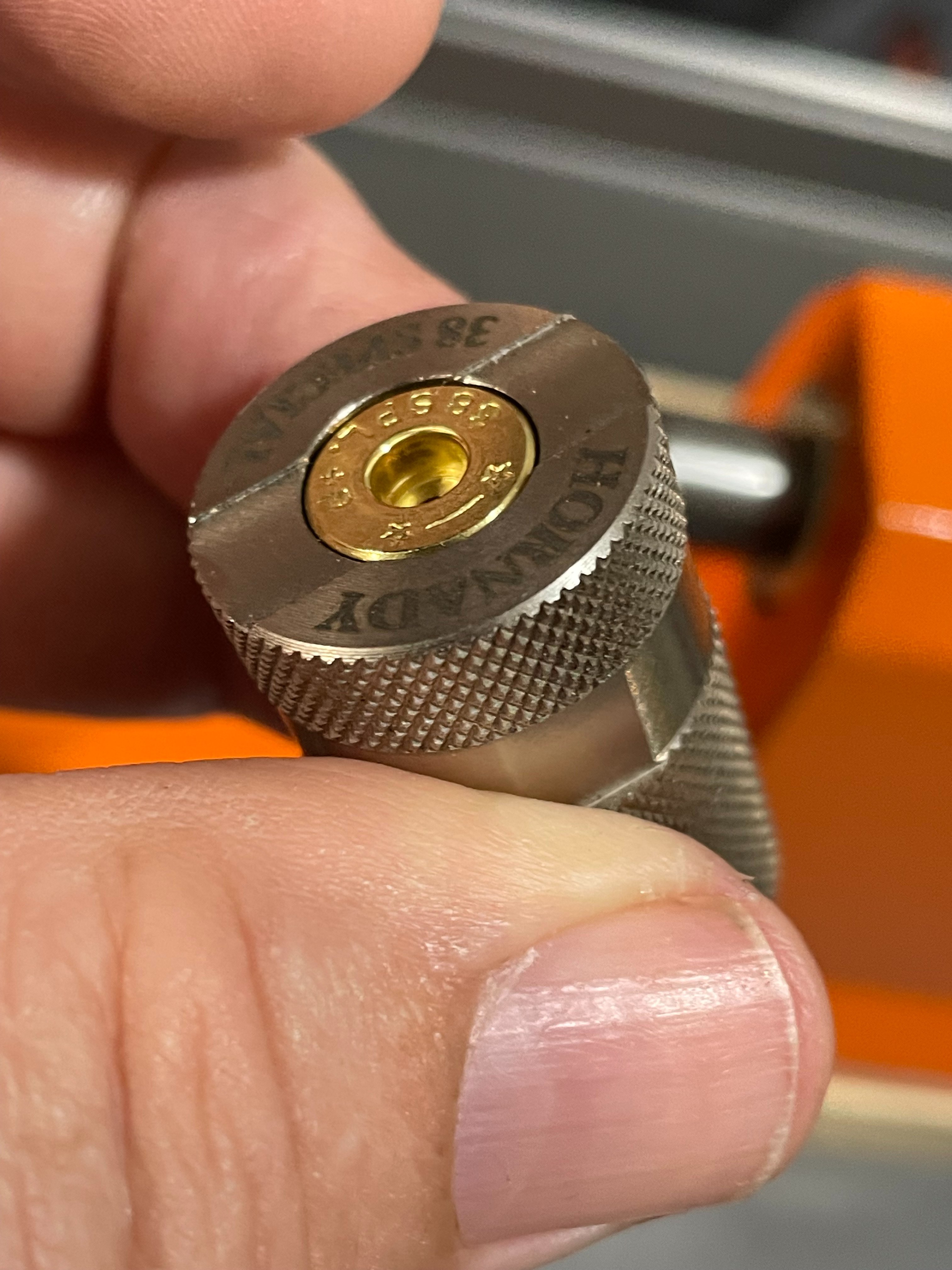

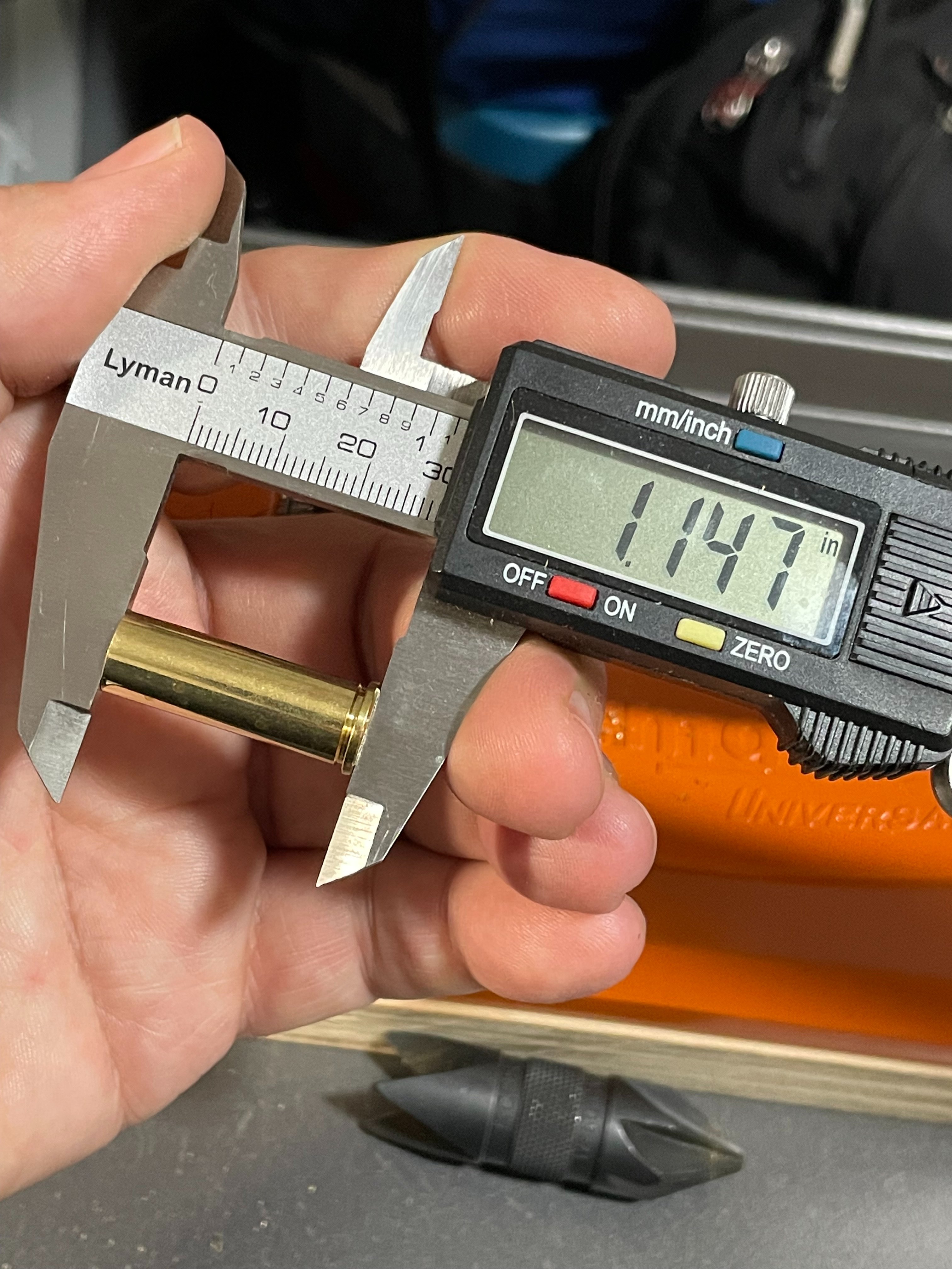

3) Cases which measure OVER 1.145" in length are trimmed, then chamfered and deburred. That makes the "too long" cases fit within my target case length window, and also ready to load.
4) Also note that even though the brass might be new virgin cases, the mouths of the cases might be dinged or out of round. In some instances, I might have to run such cases partially into an expander die and then back into a resizer die to iron out the dings, especially if the case requires a trim, or if the chamfer / debur tool cannot get even contact for the full circumference of the case mouth.
