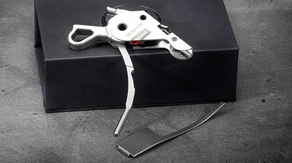

Nighthawk DTS (drop-in trigger system). it’s really for any 1911/2011. I have one on order and will post a before /after comparison.
Don’t take this as snarky…
I’m curious how that compares to a half price EGW ignition upgrade kit.
I also wonder if it’ll let you drop the trigger pull poundage or if it’s set. As is, it claims 3.75 to 4lbs after break in.
With EGW kit mine is sub 2.5#, crisp and clean.
Everything I put in place w/ EGW was drop in except the sear spring, I adjusted it to my liking for roughly 20 to 30 minutes.
I don’t take it as snarky at all. It’s a very legit question. Not sure I’m 100% comfortable adjusting a sear spring. To send to a smith to have the EGW kit installed would bring the cost of the EGW kit at or above the DTS not to mention the wait for a smith to do the work. I’m sure I could mange the sear spring but imagine it would take a lot of trial and error and many trips to the range.

The EGW kit was my first choice but it has been out of stock so I thought I’d give the nighthawk DTS a try. I read a post saying it cut the Prodigy trigger weight in half. I figure if the DTS doesn’t work I’ll give the EGW kit a try.
Looking forward to how you like it. My Prodigy out of the box came in…if I remember…between 4.5 and 5lbs.
From what I read, the DTS goes 3.75 to 4#.
I’ve yet to see that EGW out of stock. The kit with the 17# mainspring was out of stock, I simply bought the kit then added a 17# mainspring for a few bucks.

I did. My trigger pull tests consistently in the 2lb range. With a Wheeler digital gauge. This is a lot less than what Nighthawk advertises, but consistent with posts I’ve read with claims of 50% reduction in trigger pull. I can’t discount the possibility that I could just be using the gauge in correctly, but this the reading I’m getting
