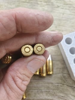

364 Rounds today only 1 malfunction. I stove pipe with the nato round that was on me for a limp wrist after 300 rounds. Shot great. 25 yards just shooting leisurely to 7 yards just clicking off shots to 5 yards with several different loads. This gun is a keeper for sure.
