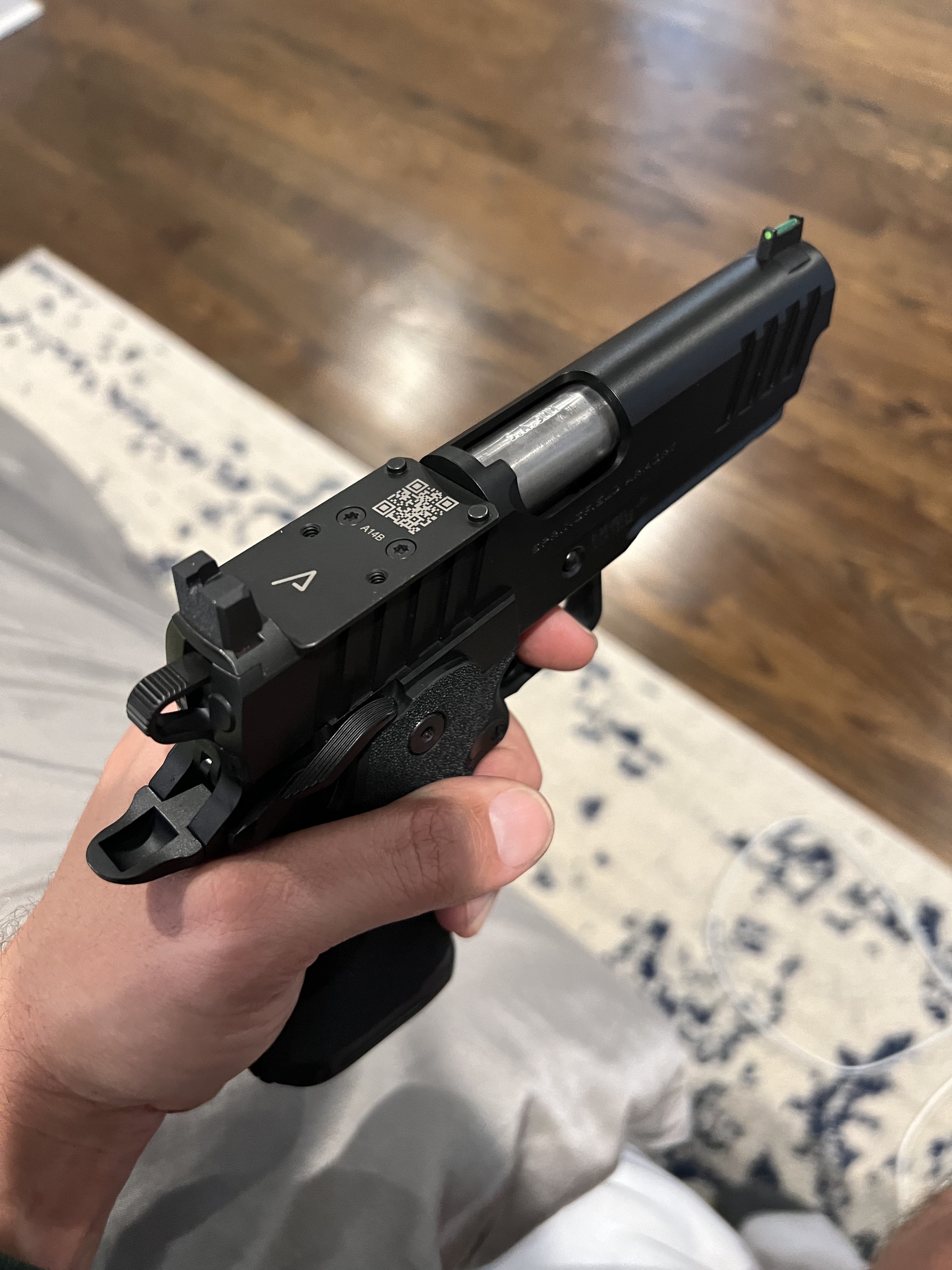

I just put a 508t on my Prodigy yesterday. I thought the same. I put the plate under the rear of the slide and it was sprung up…like it was too long. I moved it side to side a little and I actually tapped it with my finger and it dropped in place. It will go….it had a little snap sound when it seated.
Same. Plate for my 407c…. Thought it was bad, started to get the file out…. Just had to be lined up perfectly then it snapped in. It’s damn tight. I used the screws holding the factory plate down to tighten down the new plate with a dab of blue loctite.

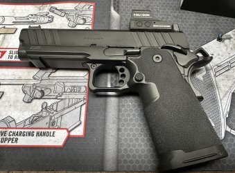

I used the short screws that came with the sight as the other were too long. Tighten to spec…150 rounds yesterday, about to go put it through more paces today. I checked torque of the screws after about 100 rounds, still good to go.
